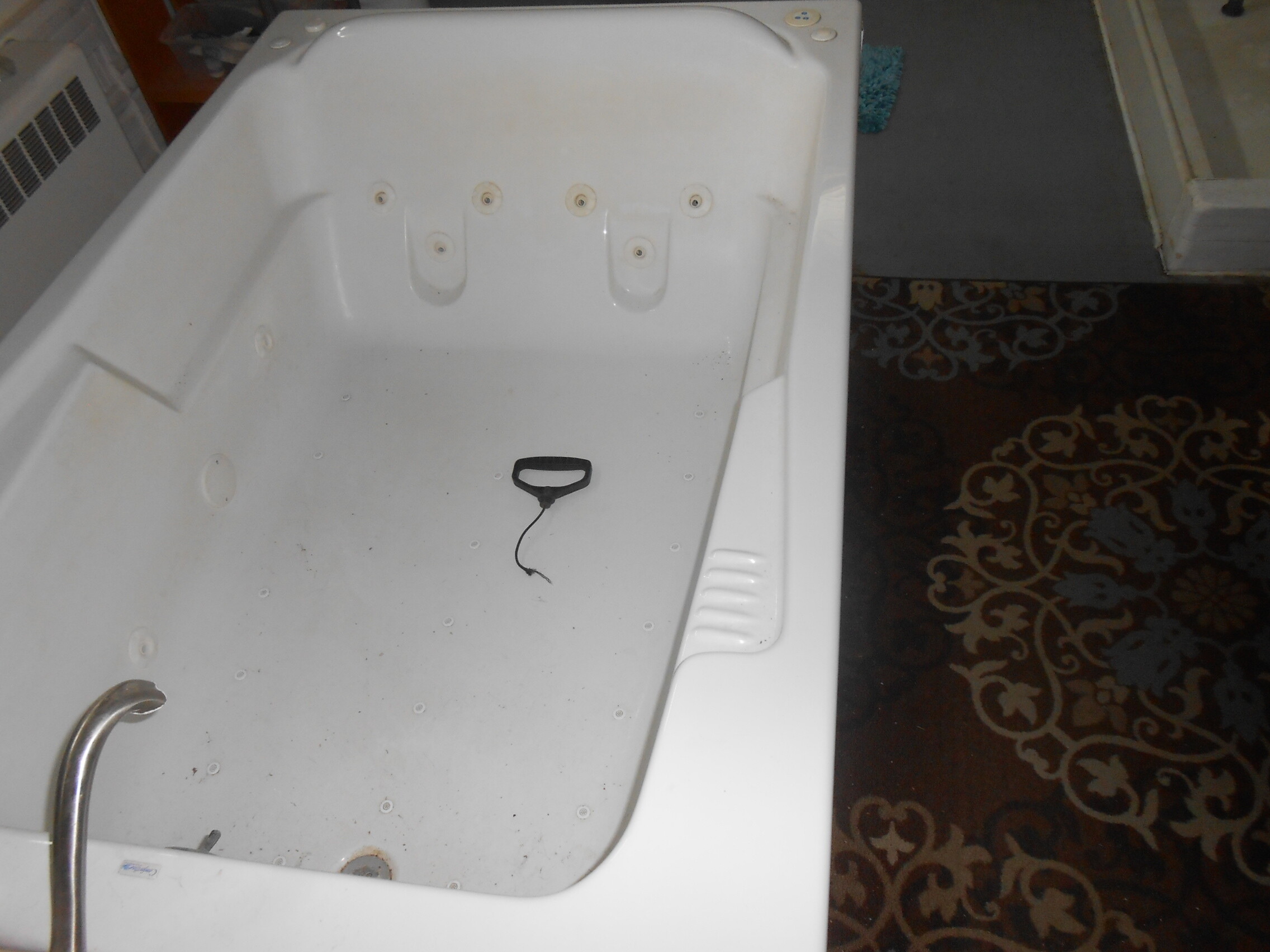

Last post I said this whirlpool used more power then charging an electric vehicle .
It has it’s own water heater 13.5 Kw 60 amp 240 and another two 20 amp 110 circuits .
Have not used it in some time and have had much lower electric bill .

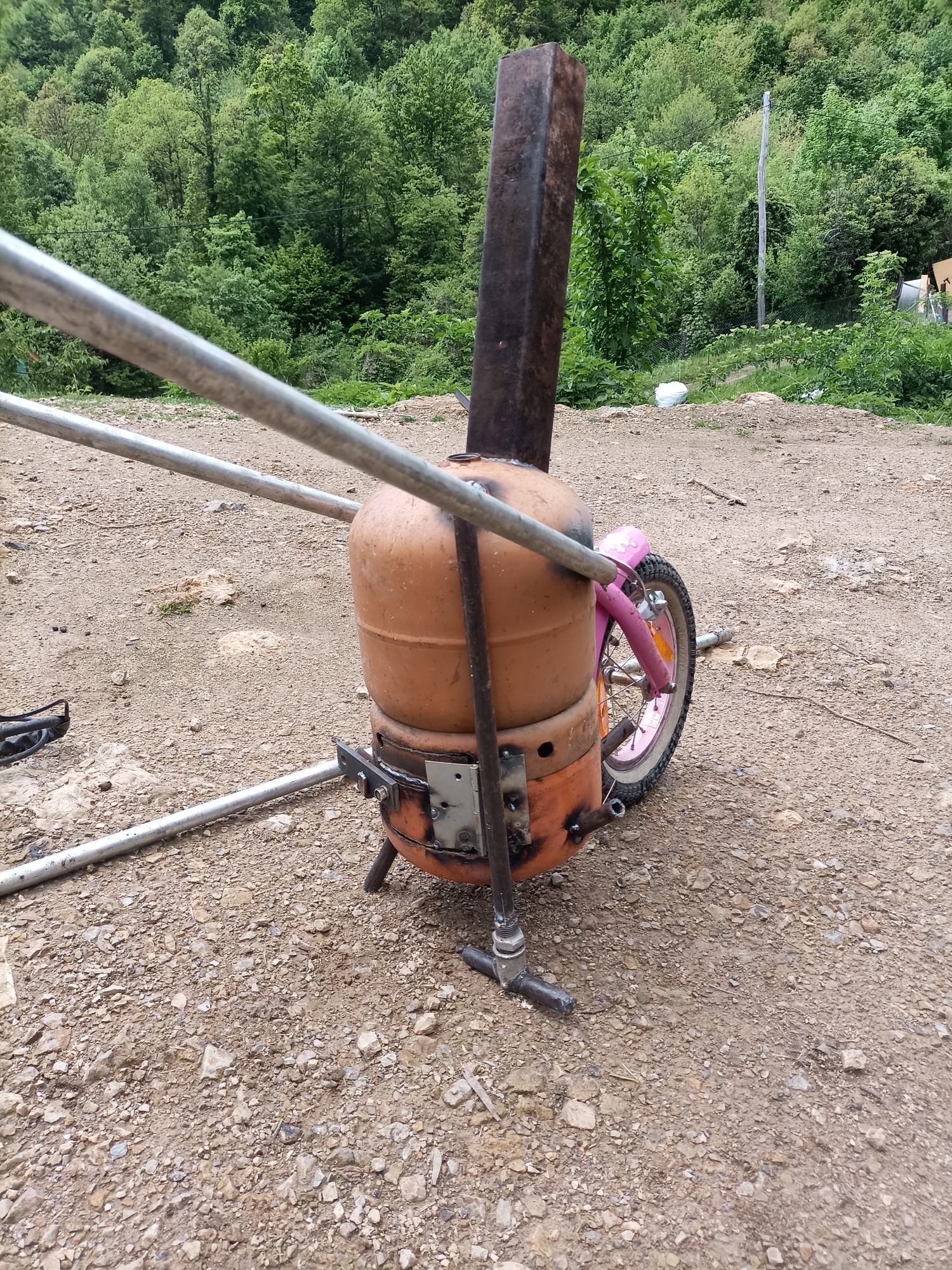

Combination: Portable space heater, Charcoal maker, and tire melter?
17 year Cicada powered meat and fish smoker?
Waste oil burner and orchard heater?
How many guesses do I get?
I think it is a Weed burner
Garden weed burner maybe?
Is it some sort of contraption for gopher genocide?
Looks like the lower part is seperate, like a firebox with the hinged latching door…upper feed shoot, with open pipe threads…mobile plastic distillery?
Some time ago you wrote about a woodgas-weed-killer-burner.
This looks a bit like a small steam boiler, so maybe a steam-weed-killer with in a wheelbarrow-style?
Now I am betting on Til to win!
Well you did ask, " . . . what this ugly thing is?"
O.K.
It is a man-portable (or wife); solids fuel to gaseous fuel maker.
You did not ask what it was FOR. Meaning the purpose of it’s production. I cannot see Kristijan so bored yet he is making mystery metal yard art.
So more info-hints, please:
Will you be adding an air/gas tight door/cap to the square tube feed chamber?
Is that Tee ended pipe loose? just sitting on the ground? Or attached to the barely visible blackened weld point on the top tank chamber?

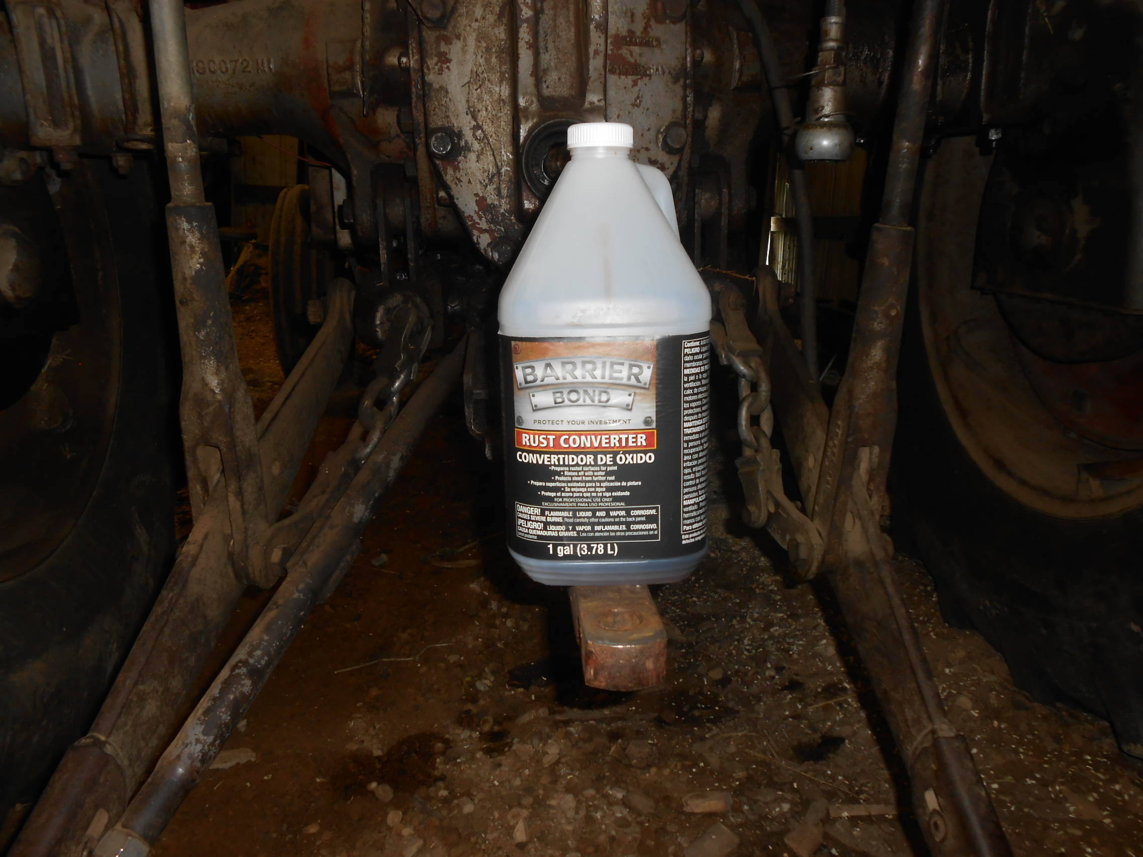

Finished using rust converter on boiler tubes . used sock wired to tube to paint inside of boiler tubes .

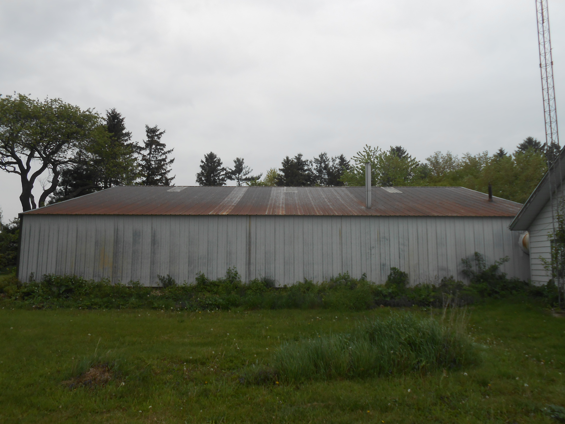

I first thought of getting rust converter for roof . Roof seems too big of job . I do not want to lose shed roof .
There were many right answers today
I made a woodgas weeder before but then l thod, l touched a flame a thousant times. But when l touch steam, l get a instant regret. It just dumps energy faster. So l went this way this time.
Natural draft was a bit weak so l diverted sbout 15% of steam pressure to run the venturi in the chimney. It works perfectly!
Being fueled with wood its good for garden weeding. But hooked up to a diesel drip its a roaring beast.
Its juat a prototipe thugh. LOADS of thingsto correct but it actualy worksbetter thain l thod!
Oh, and the reward goes to Mike! On the last video you can see it realy is a tire melter
