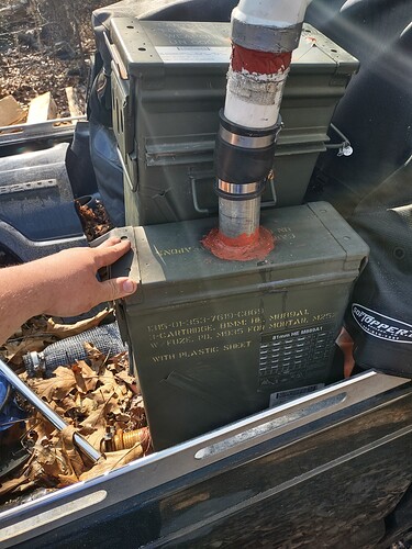

Comparing the two tall ammo cans I have. New 120mm in the back, is much taller, and wider, but not as long.
The older 81mm can is shorter in height, less wide, but is longer.
The 120mm can I got from Sgt Troy on eBay, it’s in very good condition and to quote Steve1989mreinfo when I opened the can I heard a “nice hiss” of air rushing into the can.
The 120mm can would make both an awesome filter box post cool gas, or make a cheap and dirty no weld charcoal gasifier. Lots of volume.
