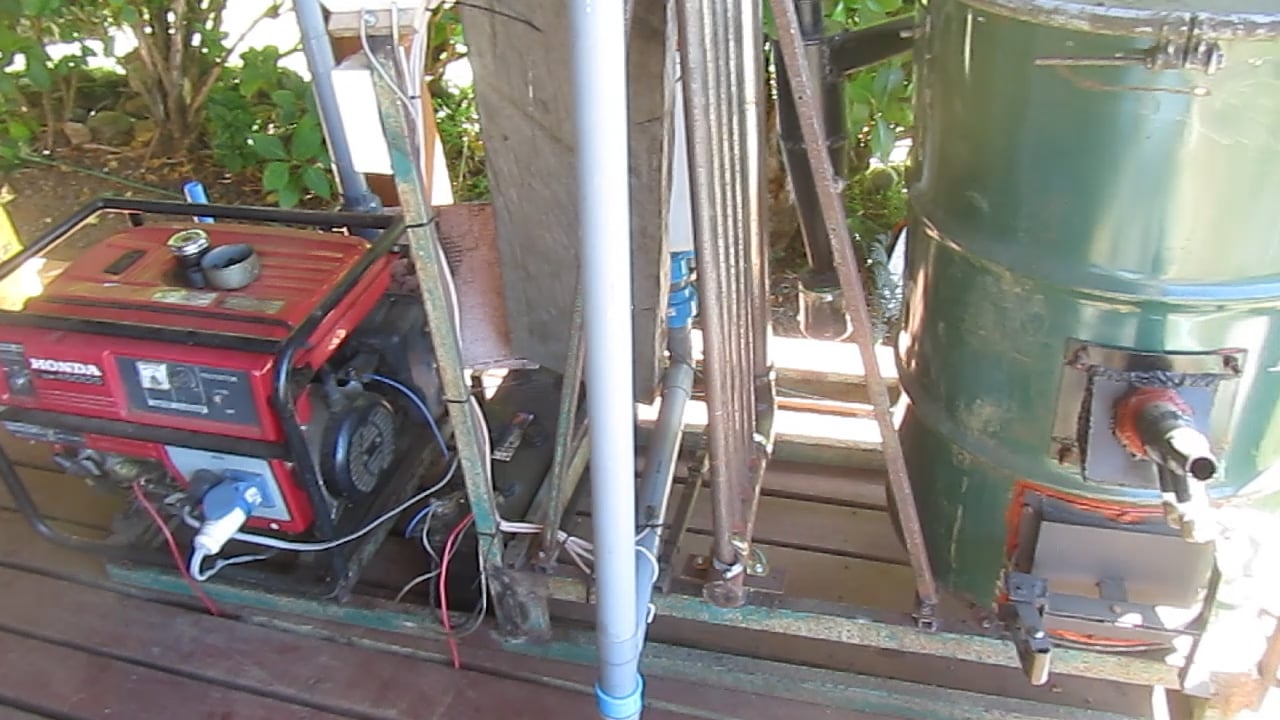

Our power went out yesterday, so the gasifier came to the rescue. It takes longer to get the generator going, but I find the engine runs much smoother than on gasoline. It was the first longer run with a new configuration and instrumentation. It ran for 2 1/2 hours with no issues before power was restored. Some day I will do a run to determine how long it can go without user intervention.
The top line of the display shows termperatures (degF) at various points along the flow path.
From left to right: outlet of gasifier, exit of radiator, exit of rock bucket/filter, exit of preheat radiator, exit of carburetor to head.
At the end of the run, the gasifier outlet temperature has risen significantly, but the radiator and rock bucket have kept it in check. I wonder if there will be a plateau or if the temperature will keep rising. I will track this on the long run.
I find that the generator is causing a flickering of my lights. It seems maybe at the same hz as the power supply although I can’t be certain. I wonder if anyone else has this issue? I’m thinking it might be the generator brushes?
How many amps where you drawing? Are they led lights?
