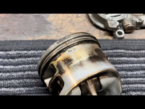

I always publish only successful projects, but they are necessarily accompanied by unsuccessful ones. About a year ago I started converting a Solo 656c chainsaw, it had a catalytic converter installed in the exhaust muffler, which after some time of operation glowed and heated up the surroundings a lot. I cut off the catalytic converter and installed a kind of “resonant” pipe, which was supposed to allow more power and higher rpm, this actually happened, the chainsaw really worked much better. At higher rpms, it felt like it had more torque. I used it like that for a year without any problems, well, a few days ago, when I was felling a thicker tree, it stopped, … what happened? The pictures show the situation. I blame the cause of the failure on cheap ole for the mixture and … too high engine rpm…
Yes you are probably right about your assessment of the failure. Not the best oil. And too much throttle finger, too long.
But Tone you have to figure too much heat for too long was also a major factor too.
Long bars with full chain teeth: and those teeth filed aggressively, can be factors too. Especially when driven by broad shoulders, and a strong will-power to get quick successive cuts done.

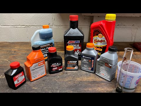

Here is the guy I have now based my chainsaws oil selection on for the last few years:
Some European brands of oil he tried:
I’m sure that chainsaw manufacturers stick their names on oils that probably come out of the same vat, whether it’s Stihl or Echo or whatever. I usually just buy Stihl and run it 40 to 1. I don’t run a saw 8 hours a day, day after day, so I would be inclined to listen to someone that did. I cut about 10 full cords a year over the course of several months and probably have the saw running continuously 15 minutes at a time. Not really hard duty. I have several saws that are 15 years old and one that is 40 years old still running fine. I guess that if I took youtuber advise I go with the Castrol recommended by Buckin Billy Ray just because he actually runs saws.

You have surely torn down you fair share of saws Goran. What have you observed to be the biggest wear areas that could be attributed to oil and oil mixes? I would assume cylinder walls but a lot of the posted stuff seems to be piston skirts. Are the bottoms of pistons really banging cylinder walls that much? I have always been surprised that oil in gas would keep the rod bearings sufficiently lubed.
Steve, I totally agree with you, the heat generated by increased engine power is also an important factor, probably the most important one. When I disassembled the saw at home, there was a lot of burnt sawdust on the cooling fins of the cylinder, which limited the cooling efficiency, this was probably the main cause of the failure, … negligence in maintaining the tool, as with wood gas, the most common cause of failure is operator negligence, … :woozy_face::pleading_face::grinning:
There’s a used farm equipment/parts place close to me. About 10% of their machines are burnt up, melted down combine harvesters. Oil leaking from engines mixed with the chaff and powdered crop dust is all it takes.
Hi Tom, soot it is! Or: carbon build-up, gets loose when changing oil mix, or saw gets a new owner that runs it worse or better than the former owner, or when the build-up is big enough to came loose.
Many things affects this, often running the saw hard, very hard, makes the carbon “crisp” and cocrete-hard, comes loose, and then it often are no more fun.
The oldies i like is sturdier built, with bigger tolerances, they throw the soot out like a beautiful shower of red sparks.
After that, dumb-mistake-straight-gassing is very common, could be seen on the piston aluminum sticking to cylinder wall (could be dissolved with caustic drain-cleaner) and often recognized by enormous play in the crank bearings.
