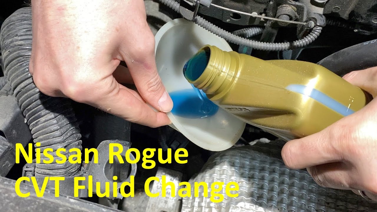

How the transmissions effect:
Monitored is the input speed versus the desired output speed. These vary too much from slippage and the engine power is reduced to prevent a hard transmission failure and transmission overheating. That “lost” speed/power being turned into friction heat instead.
Monitored is also the transmission fluid temperature. Temp goes too high and again the engine power will be reduced. For the same save-the-baby reasons.
Now transmissions WITH fluid dip sticks the overheated fluid can be seen by heat expanding to, too high of levels. By the smell of overheated burning fluid on the dip stick. Did that one myself running my 94 Ford pickup back and forth 25 miles to work and back, held shifted in 2nd range continuously in a bad, long extended series of late winter snow storms. Put it into limp-in mode. Ekkk! Had to flush the fluid 3 times to get all of the burnt damaged stinking fluid out. Never had been quite the same since. Planetary gears, clutches versus even more sensitive CVT’s cones/spiral drives and chains the same-same for monitoring input versus desire out speeds and overheat fluid damaging. Both can internally shed metal slivers circulating in the fluid.
Dumb-dumb going to no fill-port/no-dipsticks systems. This was a planned obsolesce change regardless of how they spun it as “Sealed. Fluid for Life” Bull Shit!! All fluids with usages age change. All fluids with usage will become wear metals contaminated.
No trans dipstick huh. Guess what I spent about 5 minutes trying to locate yesterday. :face_with_spiral_eyes: :exploding_head:
Even these can be done.
They will have either a bottom drain plug hole; or a side fluid level plug hole.
Most with the only bottom hole types you drain and pumped; or squeezed bottle fluid refill through that same hole. Using a J-ended hose or tube. Toyota’s mostly even have a removable stand pipe insert to get a clean drain out. Pumped up and in until the level over spills the stand pipe/tube height.
The wife Ford Edge does have a dipstick/fill. But no drain. You are expected to pan drop to drain. I vacuum pump suck these.
Now her separate heavy gear fluid APU right angle drive unit only has a side level checking plug. No drain. At ~7 year into ownership when I realized she was going to take it out to 10 year usage; unit HOT I made up a narrow diameter polyethylene tube tip to suck it out. Looked like silver fluid from all of the 175K accumulated gear and bearing metals shedding.
Took three fills; drive; circulate and re-heat, then suck outs to get it looking clean.
Then became an end-of-summer pain I was doing annually. Having to heat thin the 75W140 synthetic to get it to flow re-fill.
Same for the rear two chambers viscous coupling and rear differential gears box.
Messy jobs. With pain pills for the old body pretzeled doing the gymnastics.
