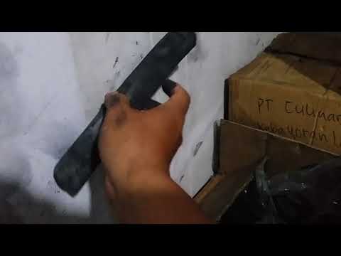

This video is an example of what a nicely made hard wood charcoal sounds. The japanese traditionaly make carbon for mileniums, they pefectioned the system to make what they call WHITE CARBON; it´s mostly from mangrove wood (we are useing old guava trees in their finals), it´s very hard wood and produces something similar. This week we are going to make a batch of bamboo charcoal and i´ll pu some guaya sticks in it, then I´ll make a video with the sound and post it. This carbon makes no smoke and yhe sound tells you the cuality of he charcoal for cooking. I´ll keep tuned in with this, for me it´s a pasion.
This is another one. Notice there is no smoke in the kiln.
Listen to the sound of charcoal when beeing cut.
Abner the video is blocked in our country USA because of the back ground music.

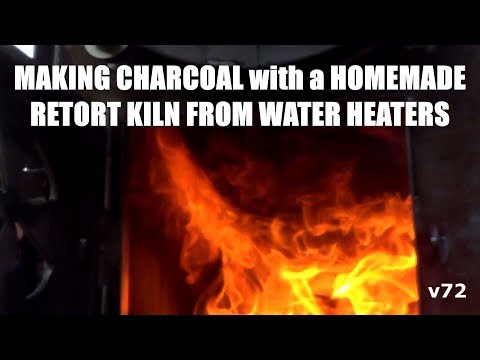

Hi,
let me introduce âCharcoal Charlieâ
I found this video an I really like this retort. Larger and heavier than with an internal flue, but the bigger burn chamber doesnât need an afterburner and the larger heating surface speeds the process up.
