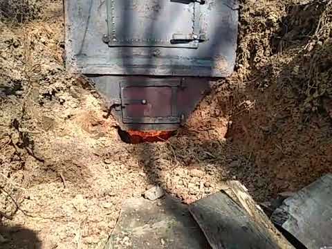

Matt, I’ve shared this video before, well, this guy is cooking charcoal for fertilizer, here you can see the gas burning coming out below, my stove works the same way.

What is interesting about that design, is that he doesn’t have a pipe and just vents out the bottom. Which means if you fill up the barrel with wet wood, you can probably get it to air dry in the sun first and not have to refill the barrel. You just move it to the cooker.
