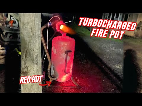

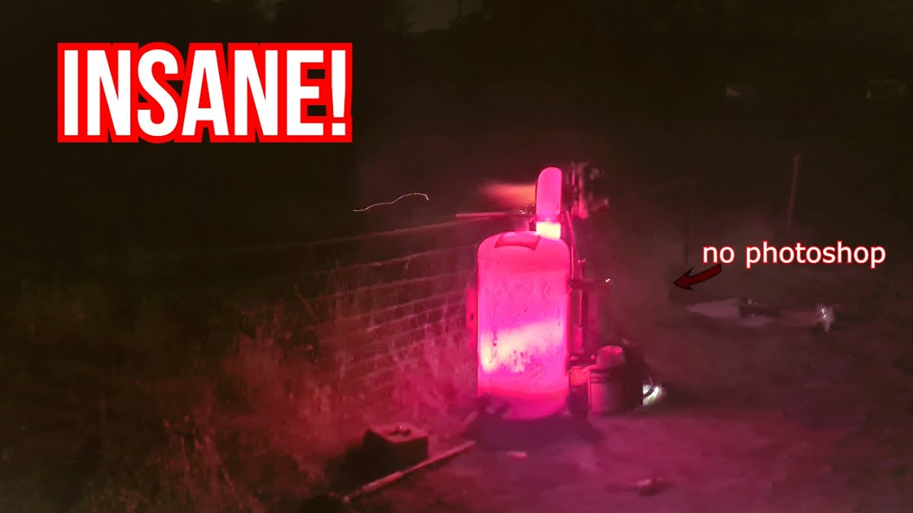

another turbo video ( uhg )…
But this one is making flammable gas that’s flaring after the exhaust.
Ya I was able to get gas out of the fluid bed and a lot more of it, but I could not deal with the ash slag issues and leaks caused overheating.
But look this guy has inadvertently made a crude analog of the fluid and he’s not making tar on the turbine side. ( he’s making glass, been there done that… )

There is a point again when this thing just starts to make gas.
But at 9:21 it fries.
Look at the heat there is so much more potential here to make gas.
But all that heat is wasted not enough fuel inside to make use of whats going on.
Maybe the trick is the pulverized fuel from the fluid bed but somehow get it fed in after the intake on the pressurized side.
