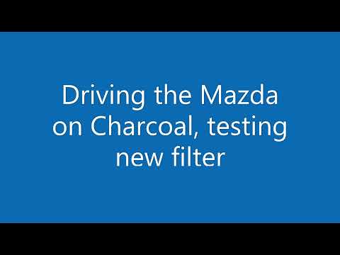

Phone picked up my voice a little too well, might want to turn the volume down a tad.
Those are the reports we like to see! Great.
I cant tell if the glow is from the nozzles or is the whole flute glowing?
55mph is what l wuld realisticly expect from this truck and engine. I bet you are pleased!
Thank you for the ride, fun to ride with you.
I couldn’t tell either. I’ll have to check the flute for damage to find out.
Thanks for the ride Cody !    Nothing like a big smile early in the morning
Checked my odometer, I went about 22 miles in various grades of hills.  Charcoal was right up to the gas exit level and now it’s right here.
