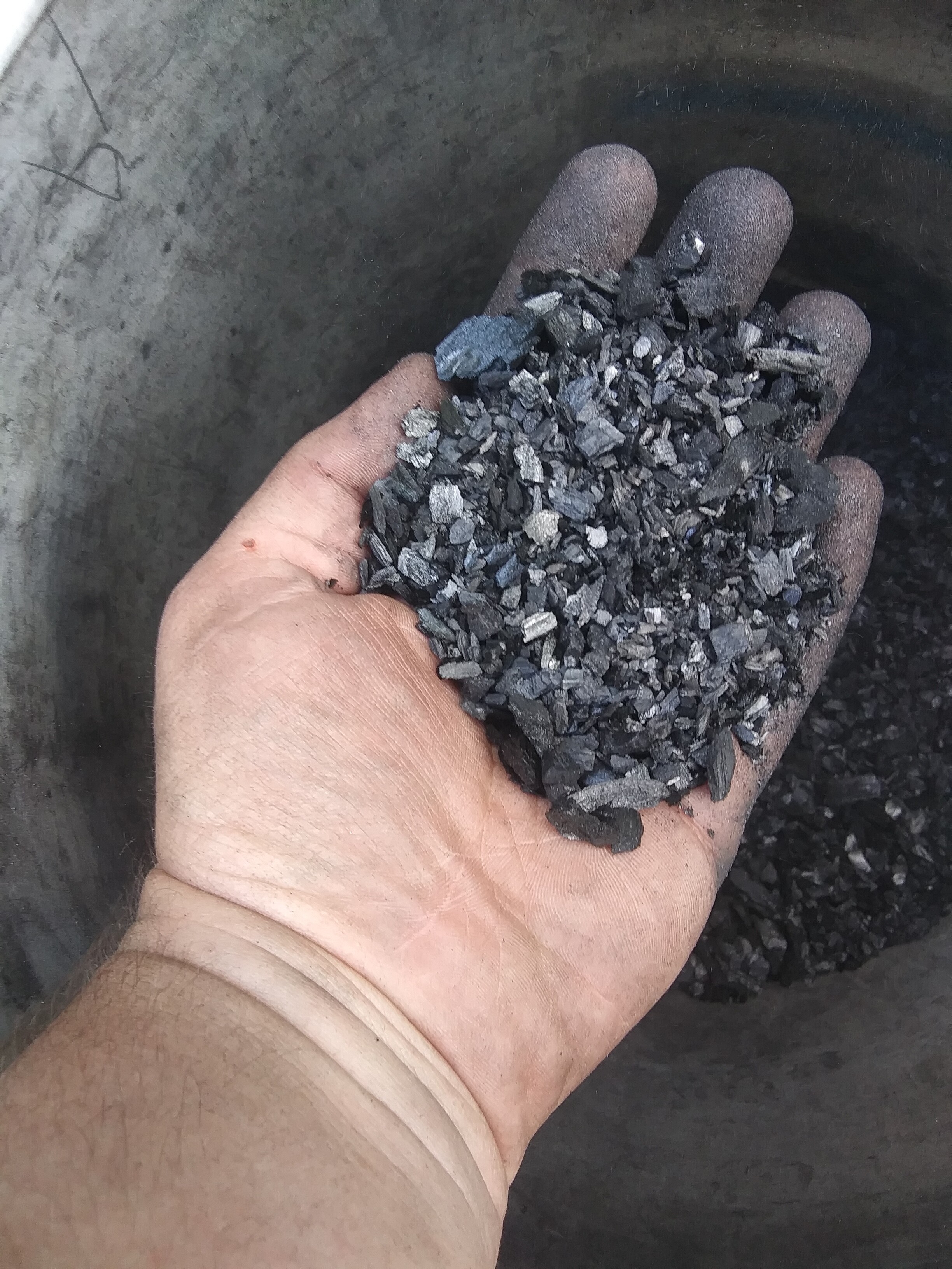

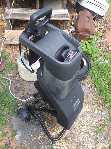

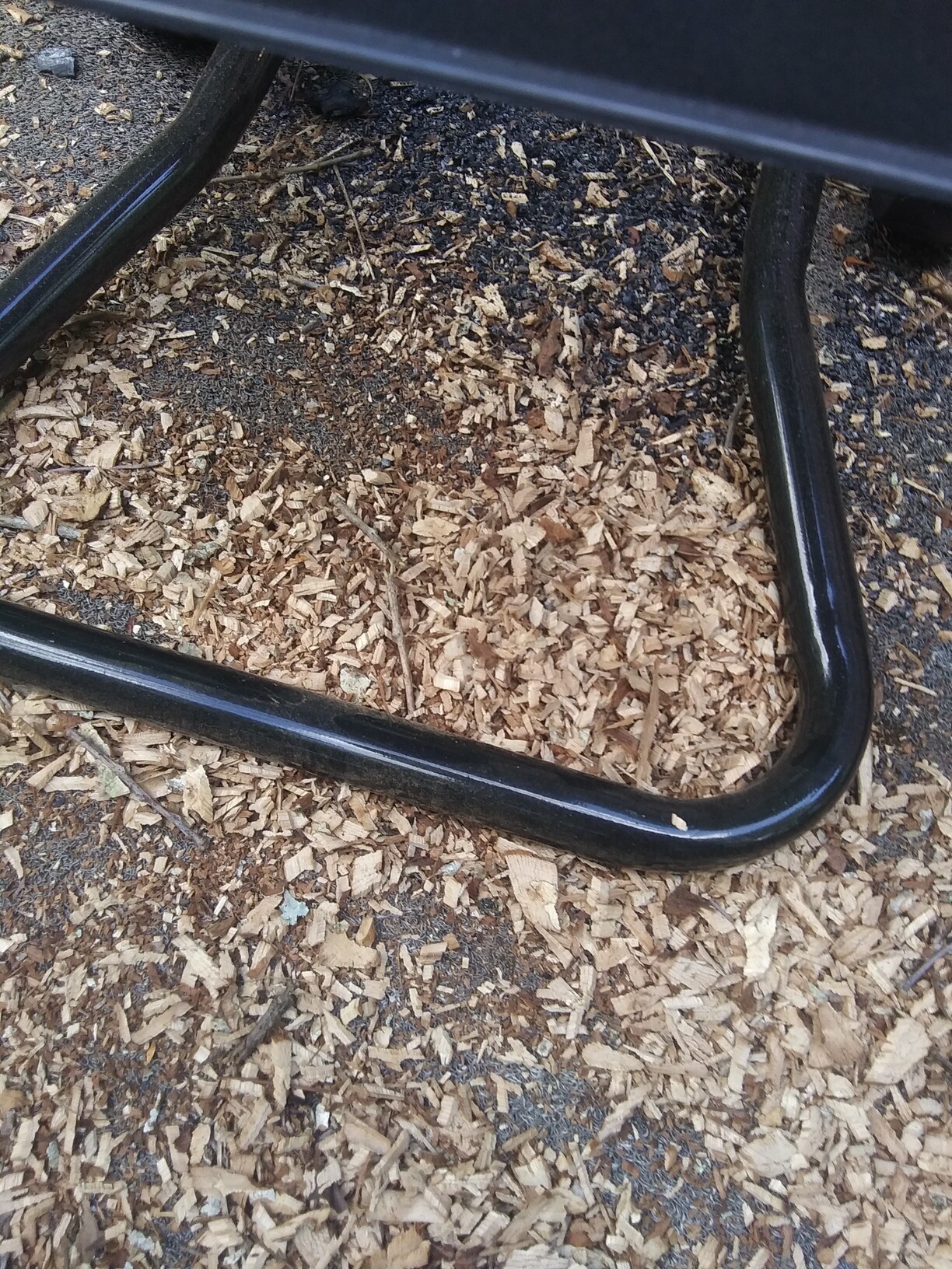

I got the chipper today! Tested it out on some branches first. Shreds it down to very small sizes. Probably too small for a gasifier I’m sure it would be Bridge City. But it grinds down the charcoal pretty well. I found that hardwood charcoal doesn’t make as much dust and makes bigger pieces when chipped.
This specific Sunjoe chipper has an internal 17:1 gear ratio already so it is slower with more torque than the older ones.

Oh yes THAT is engine grade charcoal! Anctious to see how this performs

I went on eBay and looked for an electric woodchipper. This isn’t the same color as the one I got but it has the same gear ratio and amperage as mine. Same brand and eBay seller.
Sun Joe Electric Wood Chipper | 17:1 Reduction | 15 Amp | Certified Refurbished | eBay
Hardly worth diddly for wood unless it’s twigs and very thin branches. Might be good to make filter media out of.

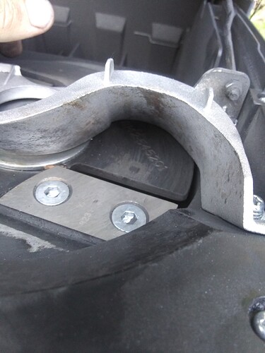

The blades are removable so maybe I could modify the blades to sit lower and get bigger pieces.

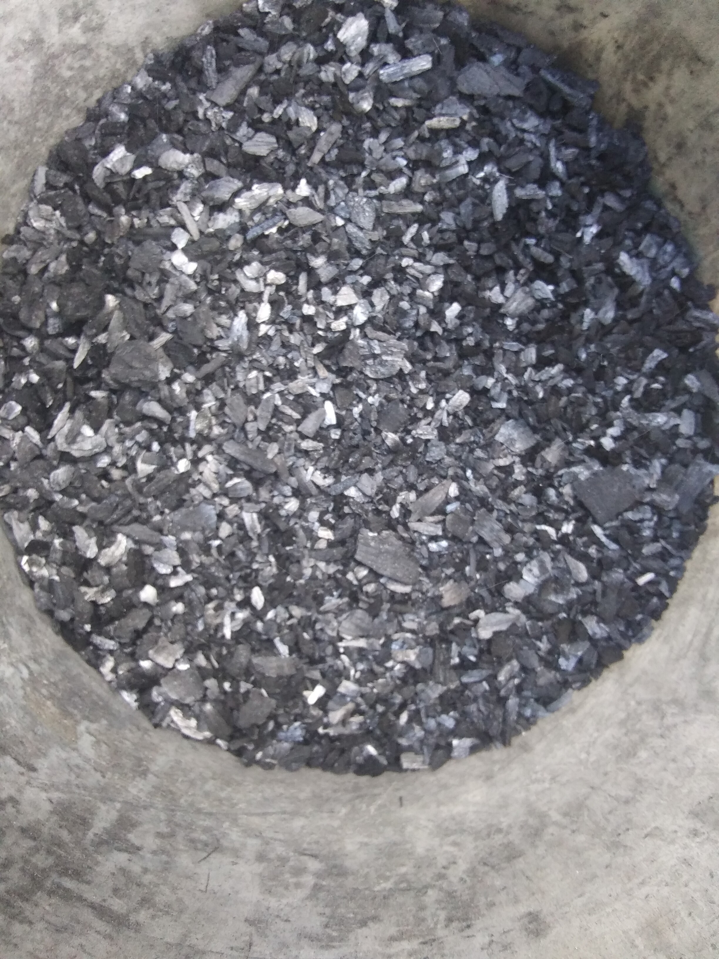

I’ll try to weigh out a pound of charcoal, grind it all and weigh how much finished product I get compared to dust.
Ok so out of one pound of charcoal, processed I lost 3 or so ounces to dust.
I’m going to attempt to crush char without the blades in place. See if I can get it just a bit more coarse.
Blades really don’t want to come out so I won’t push my luck.
Does that chipper have a universal (brush type) motor? If it does maybe a speed controller would slow it down enough to allow bigger pieces to slip through. 3 ounces per pound is not that bad though and the picture you showed looks good to me for engine fuel. Give it a try and keep lemons handy!
