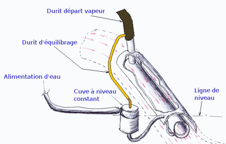

do you know this system? this serves, normally, to feed a pantone geek generator
a lot of information on this site,
it’s in french, sorry … thank you google translation :wink:
Thierry

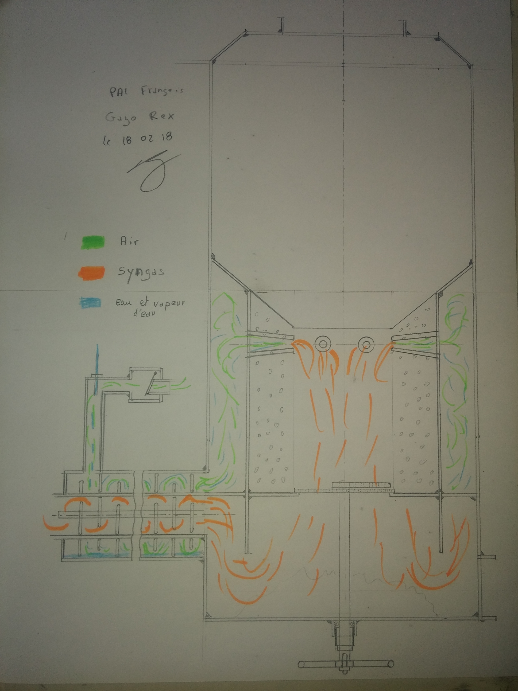

roughly speaking the project of Francois is very similar to a Mako S gasifier, except that he has a refractory hearth zone and a heat exchanger with water drip.
I really like his sketch. He uses the hot gas for preheating primary air and creating steam. There is no boiler with a “pond” of water, but a drip. So as Kristijan said more a mixture of air and water drips.
I personally would try to replace the water drip with a kind of carburetor to create a fine water mist. Freezing during the run could be prevented with air already heated before the carburetor. At least in mild winter, probably not in Canada or Scandinavia.

Thierry, if l get this right, this is for injecting steam in a engine originaly?
Kind of a litle boiler that fits in the exhaust pipe?

How have l missed that?? This is wery similar to what l am doing. But you think the restrictionless firetube will work in cracking tars from the fuel he uses (cant remember the name…)
Probably yes, it is insulated by thick walled refractory, so the heat is concentrated.
This is the problem with updraft or crossdraft gasifiers, there are cool spots were tars can pass the reaction.
And there is a lot of excess heat in the gasification of charcoal, if you don’t add too much steam to cool the reaction too much.
It looks like the orginal gasifier which he is referring to from the 1930s worked this way.
And carbonite (his fuel) or briquettes or some brands in the char has still much less tar in it than wood.
I belive the problem with up and crossdraft gasifiers is the fuel is superheated above the reduction zone thus giving off volitiles (tar). They get sucked stright in the gas outlet.

you understand, the steam is sucked by the vacuum of the engine

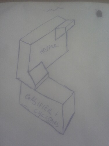

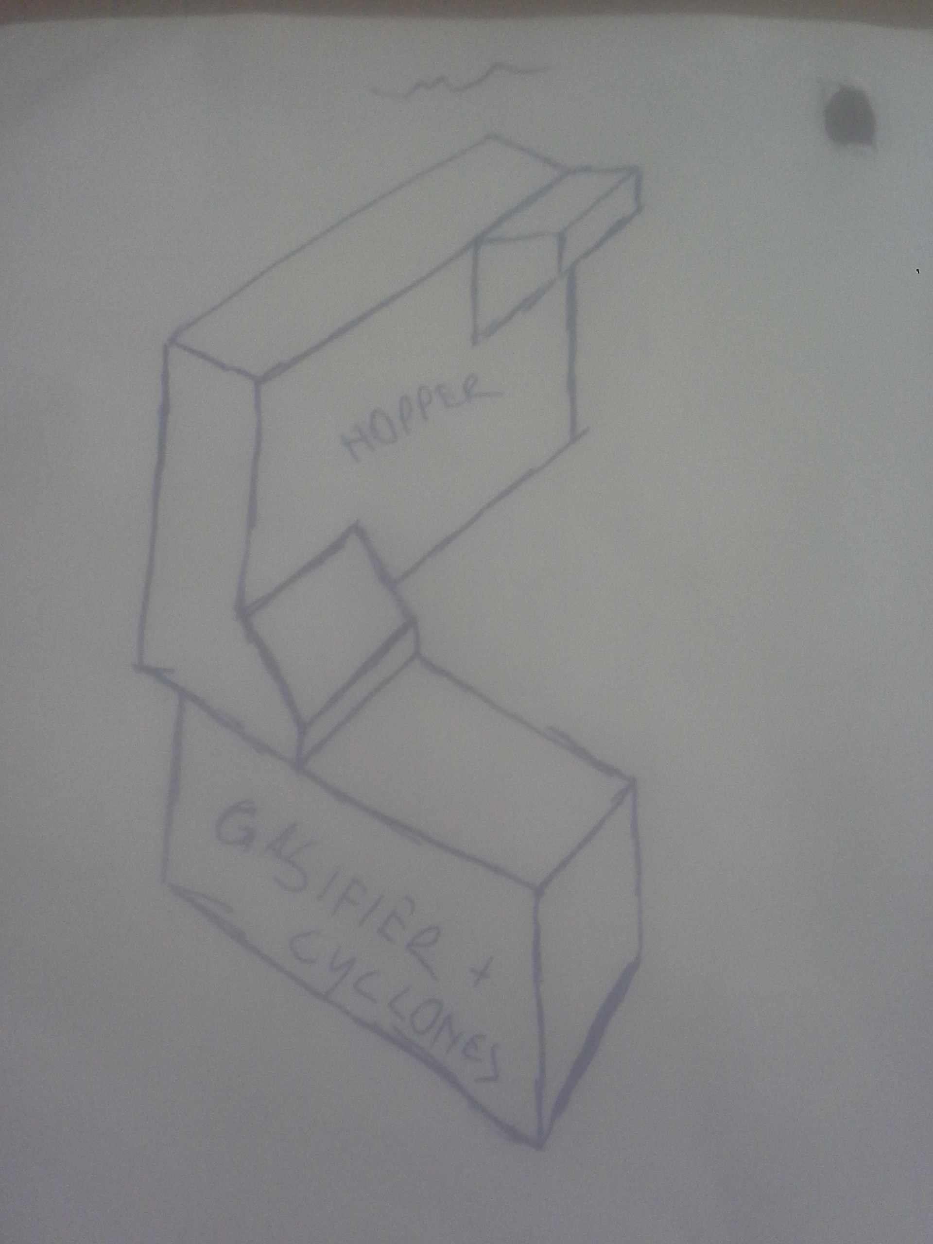

This it the layout l have in mind.
The hopper will lean flat aginst the fuel tank (paralell and behind to the seats).
A auguer will be installed both for feeding the gasifier and for loading the hopper.
