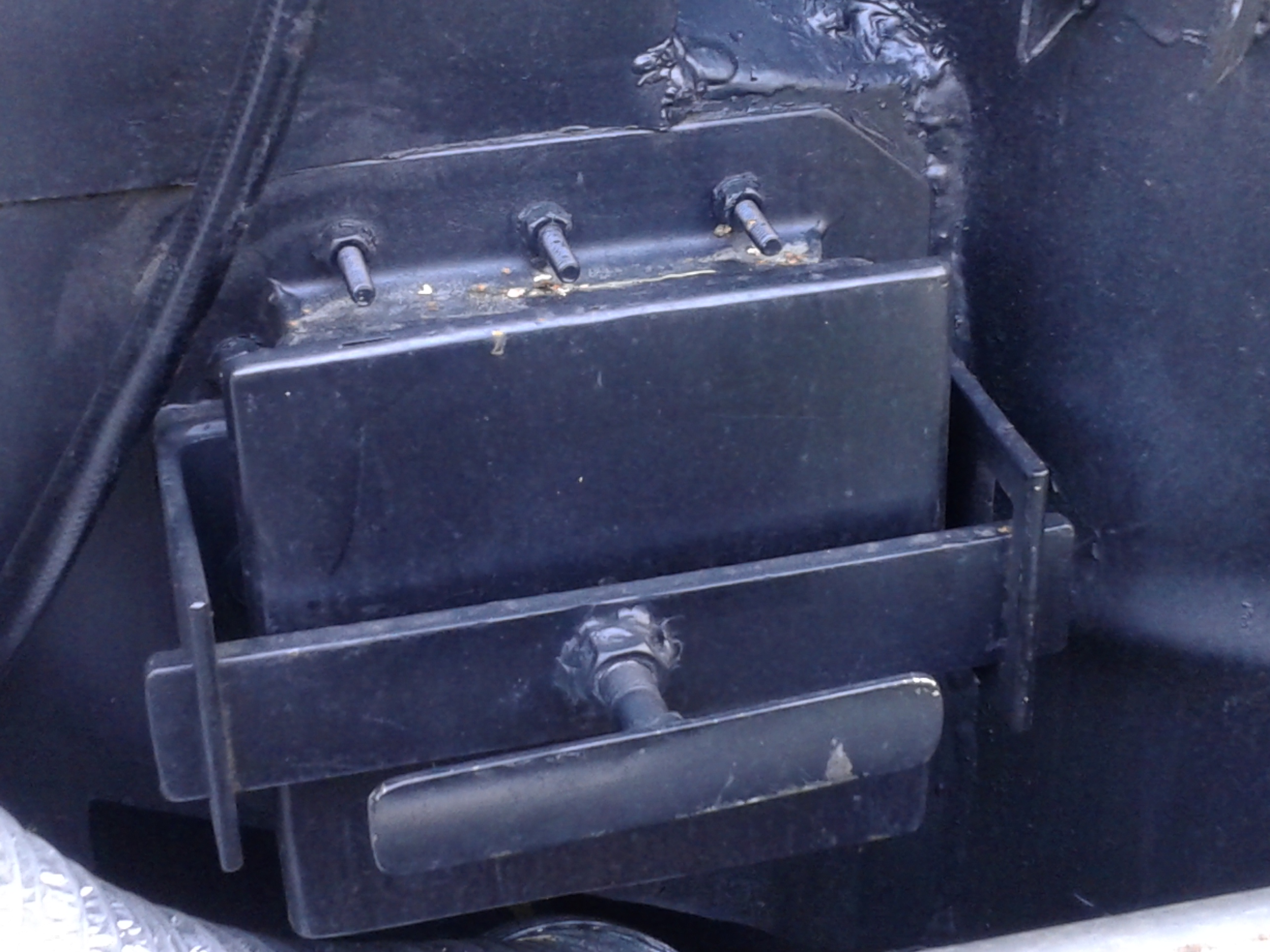

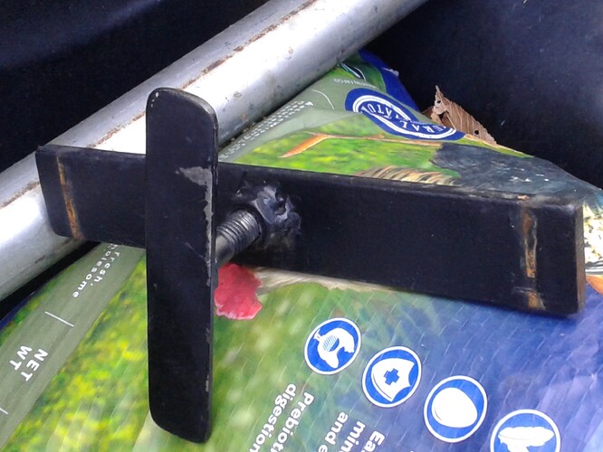

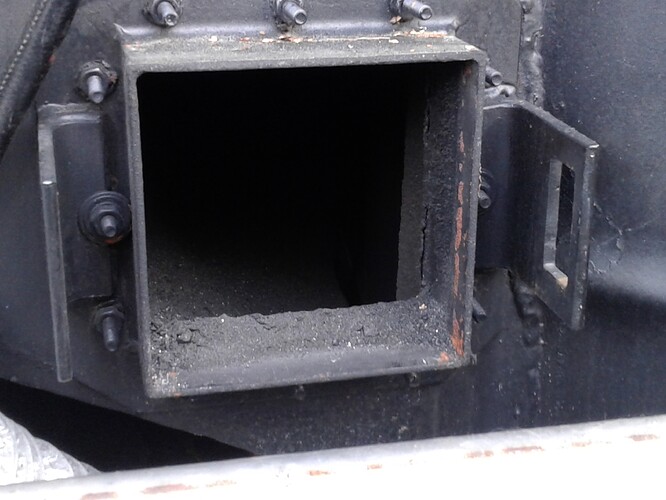

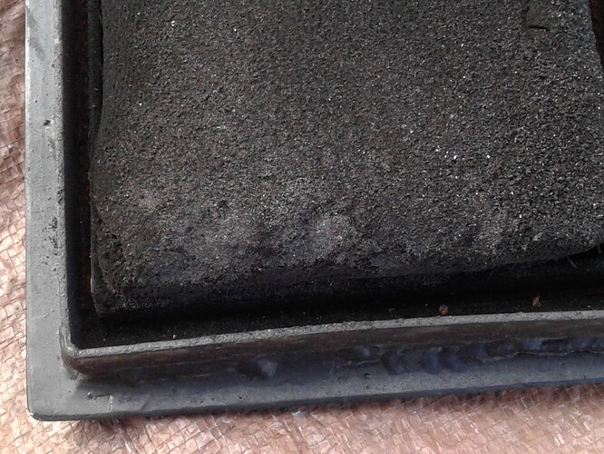

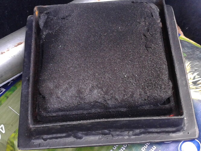

My drop box hatch cover I built for clean out and inspection comes off in seconds. It was easy to build. You could make it the same dimension you have for your clean out. It has a narrow seal around the hatch lid , used stove rope with red silicone casket seal. It never leaks. 1 bolt cross bar holds the hatch in place.
It has a heat shield made of ceramic insulation and a welding blanket, it keep things cooler on the hatch cover.
The very bottom of your gasifier floor can be the lower part of the hatch lip so everything will be smooth to rack out ash and slag and charcoal.

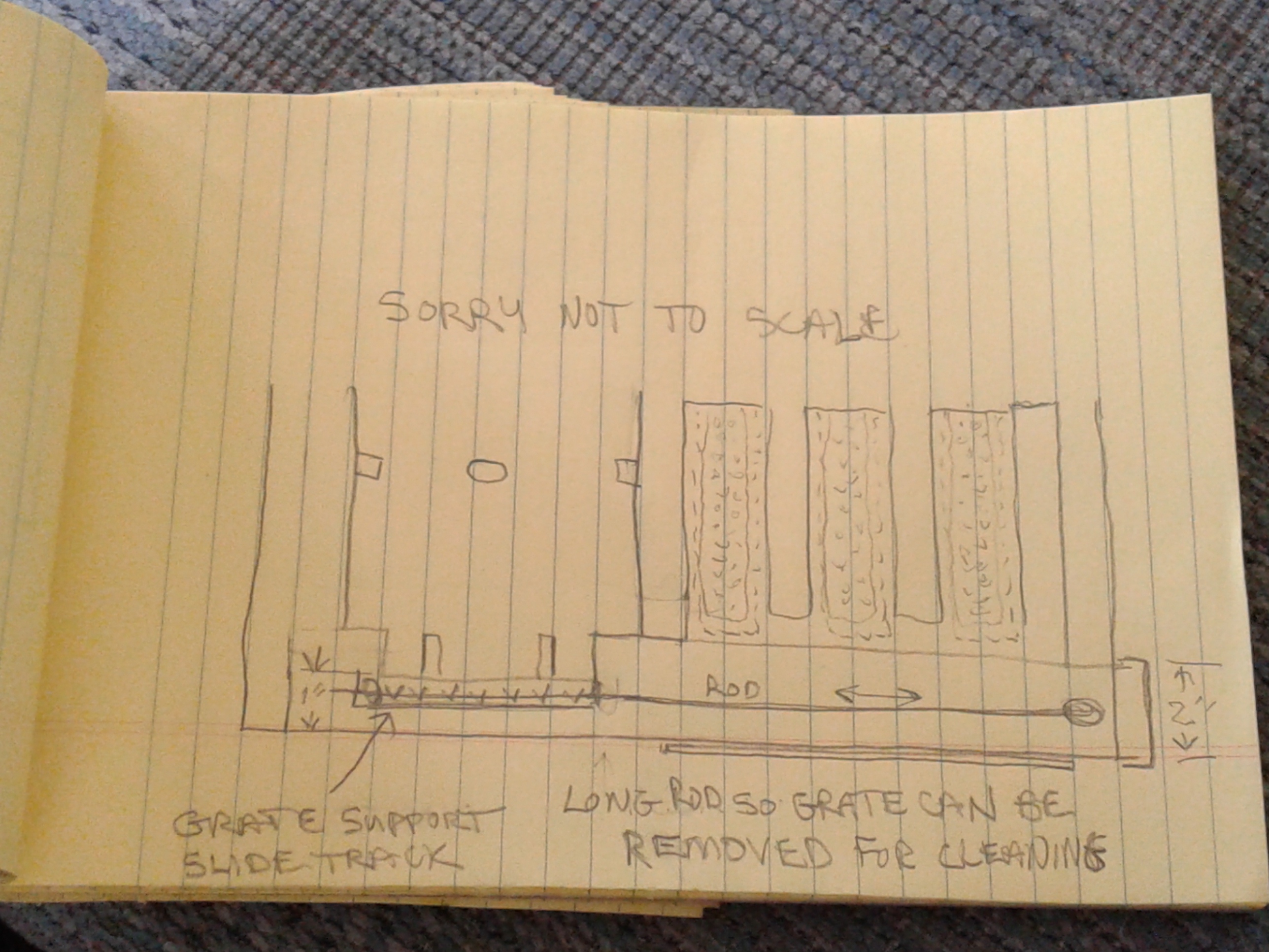

Hi Kristijan, I was just thinking about your Gasifier clearance, if you can not go down any more, then why Can’t you go up a little after the reduction ring and grate.
1 1/2" to 2" clearance should be fine for all practical purposes. Just a thought.

Bob, yep, what you draw is preety much exactly what l have in mind. I realised the video is deseaving. There is a 2" gap between the restriction and the bottom. But the gasifier is not completely rectangular (height on the front 29cm, back 27cm) so l need to get that inch somehow.
Althugh l plan to make the shaking rod on the other side, towords the driver. Maybee tied with a cable or something to be able to operate it on the go.

What I did with the stove rope is I put in a plastic bag and squeeze the red silicone into the bag seal the bag and started working the silicone into the rope real good. Removed the rope and hung it up to get tacky dry. Then I placed the silicone treated rope into the metal slot put plastic over it and clap the lid down in place to form a tight seal. 24 hours later removed the lid and plastic and let it dry 24 hours more.
