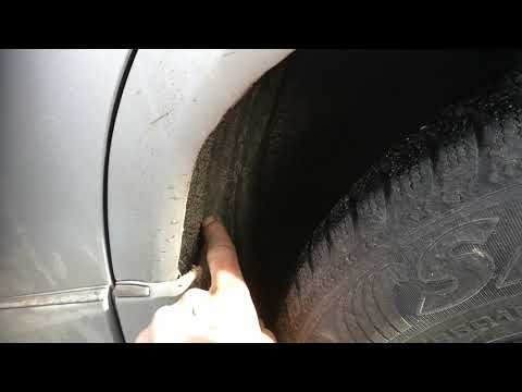

Impressive body rapair and impressive gasifier build, but most of all impressive building speed. How do you do that? It’s beyond my comprehension.

Kristijan; Thanks for the video of the MB. For the life of me, I didn’t know what the car was going to look like. It appeared to me that you only spent a couple of days rebuilding it. I didn’t think you could actually form the repair part and get them on in such a short time. In this country, I can buy for most any car, the parts that are known to rust out such as the fender lower and tire cut out pieces. I have played around with repairing rust, every since I got my drivers license. A project like you under took, and buying the repair parts would have taken me weeks in my time. ( I can’t call it my “spare” time because being I am retired, all time is “spare” time. “My time” is generally between 2 pm and 6 pm, if I don’t have to go for doctors appointments.)
I was really surprise that you had it painted already— do you have a shop inside where you can work on it, especially painting? Please tell me that you used body filler. You did a great job of fabricating the replacement parts, but I am thinking that you had to use body filler to get such a smooth installation. Thank you for taking the time to video your body work.

Tom, thank you. Unfortunaly l culdnt find suitible spare parts and made them out of sheet steel. Actualy it took me about 3 weeks to finish it all. Never again, thats a absolutely pain in the sitting organ to do.
No, no shop. I just waited for a windless day.
