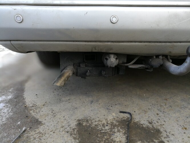

Some pics
This is all that can be seen from the outside. Note cleanout door.

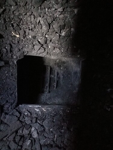

The grate fromabove
Stainless nozzles got a slight brown colour on them otherwise they seem intact. I took a lot of effort to weld them on the firebox well for a good thermal contact so that the preheat air cooled firetube can pull heat from the nozzles. Otherwise l am sure they wuld be gone by now. Looking trughthe heatexchanger, the firetube wall around the nozzles glows red showing the heat sink effect.

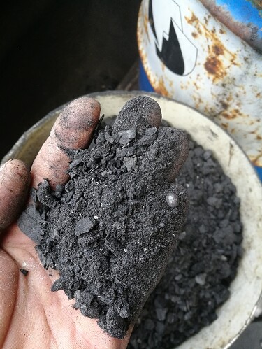

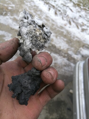

I experimented using unscreened char, stright from the chrusher. Works for 100km then the firetube content starts looking like this.
Nope. Perhaps it might work for highway driving but mixed driving pluged it shut. Or it shuld be frequently grate-shaked but thats not practical either becouse of small ashbin.

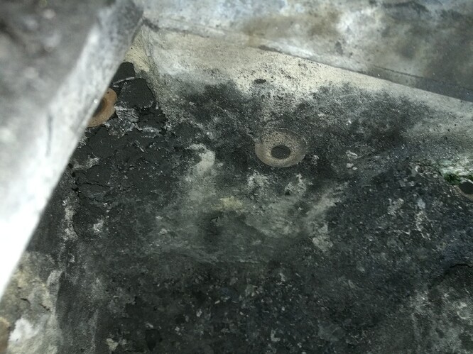

Note the slag droplet in the char.
There was so much dust in fact l neaded to rinse the cooler/tubing too. The system barely produced enough gas to run at idle yesterday! Cleaned the gasifier, filter and tubing and it purrs rock solid again.

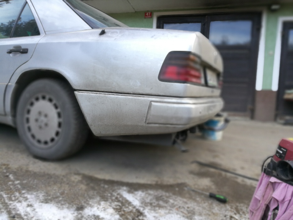

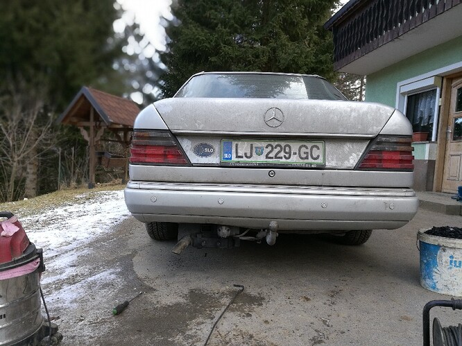

Kristijan i think that even those in the know would be hard pushed to see that your car was a charcoal powered Merc .
I guess as time goes on you will have the few small running problems all sorted and a daily/weekly routine sorted out to combat the dust and slag , well done indeed .
