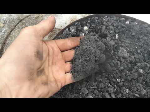

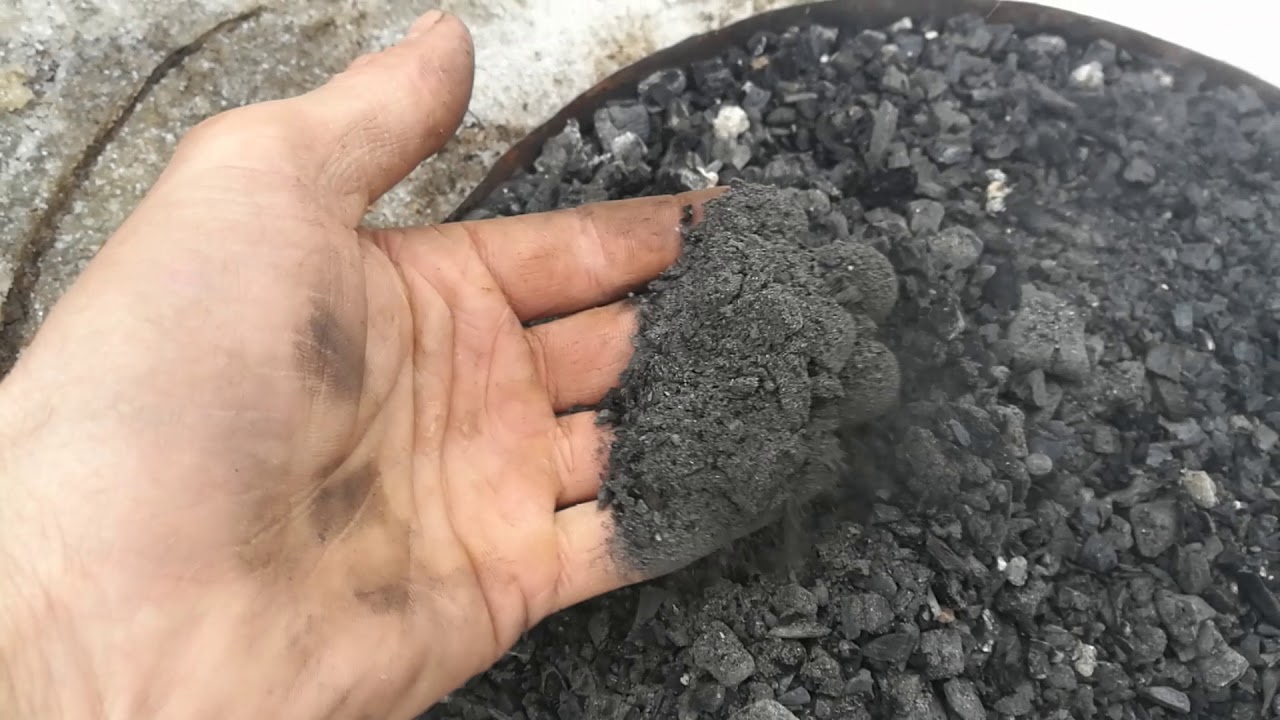

Wery frustrating couple of weeks. I had wery crapy performance, the engine barely sustained a idle on chargas. I had everything apart multiple times just culdnt find the problem. Well it seems it was all becouse the felt sack filter got plugged. Wich is weird since l tested it with my breath blowing in and it seemd fine, looks like l was wrong.
Anyway, drives strong again now!
