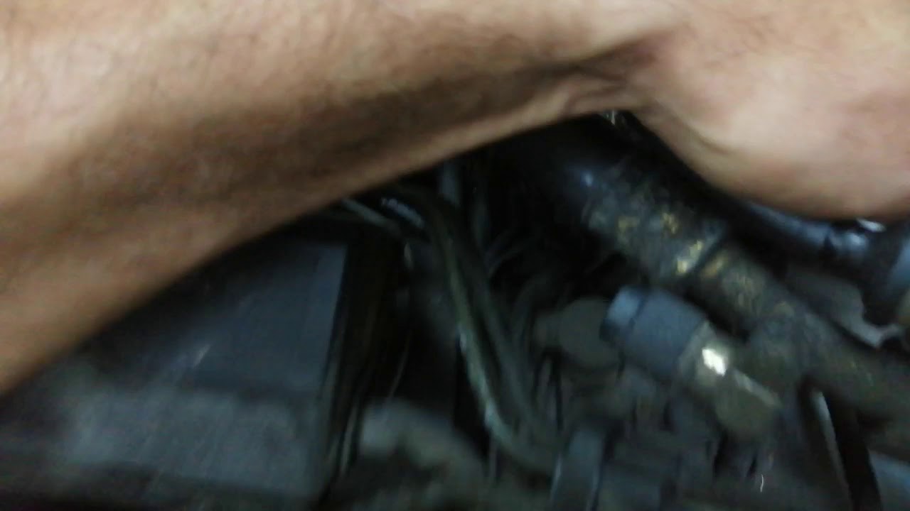

Fryday l went parts hunting and in 3th junk yard l found a brandn new Lada carbourator. Its a all mechanic simple Russia tech carb with float and everything. So, Sathurday l hooked it on. I messed up and fited the woodgas connecion wrong on the intake manifold so it let air in and it caused me to present some Serbian language as the engine wuld only run under choke. Then a big backfire shot out the temporairy woodgas pipe plug and gave me this
and caused some more Serbian languae
but l fixed the leak, adjusted the carb and now it runs as good as it ever did with original injection.
Now, you might be asking what the hell is wrong with me, every woodgaser runs away from carbs, but l throw injection out and instal a carb??? Well, l have 2 throtle boddys and hybriding is not a problem at all. Intake burning is second in line for a headacke, but l have a unique oppertunity here. This kind of injection has 4 main mechanical injectors and one electronic for startup. The 4 main ones are not in function any more but the startup nozzle can be hooked on to petrol supply and opened via 12 signal, alowing the engine to idle without a carb injecting fuel in the intake manifold. It can then be burned jus like a MPFI.

The air filter covers it completely. One shuld realy be looking for it to find something is out of order.
