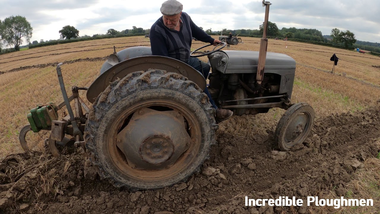

I don’t think it was ever a thing in the USA ( its was not in Canada ) but in the UK they had a special tractor only mostly farm off road fuel called TVO.
It was a mix of diesel like gas-oils and lighter fuel in a cheap no road tax blend to help farmers.
You needed a special tractor with extra low compression ( like 5:1 ) and an intake manifold heater.
I doubt its been sold commercially in 30 years, so at rallies in the UK they mix their own from a blend of diesel and gasoline and the old tractors run quite well on it.
As you will note in the comments one of them says you can’t beat the smell…
Yup there is a smell to buring K1 or TVO in a spark ignition engine.
