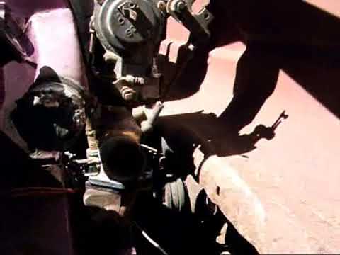

these are my new wood gas intakes from experience i have found it works better if you pipe in under the carb (if carbureted) and run a separate throttle body ill be using the TB off a subaru i got it for free and that makes it the right part =)
