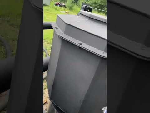

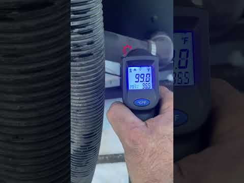

Finally had time to put gasifier together, I think I’m gonna add more cooling for summer, ran it yesterday for about 1/2 hr and today the same.
Dean I forget, are you going to run a vehicle with this or a generator?
With a generator you could maybe utilize the battery charging output to power a 12vdc radiator fan to keep a breeze on the cooling pipes and to a lesser degree the hopper.
Or add more cooling tubes if you’re not feeling like the current setup is working in the summer.

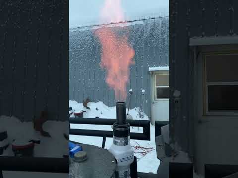

Hi Dean, the woodgas temperature should be around 700°f to 800°f coming out of the lower gasifier at the cross over pipe going to the cooling tubes or into the hot filter. The wood gases will cool quickly down from there. At the grate it is 1500°f to 1700°f in running temperatures. At these temperatures you should be making good gases to flare. If your wood is to wet, over 18 % moisture your gases will be wet and it mighty be harder to flare.
This is your third run and your char bed probably has not fully settle in yet. Be careful not to disturb the char bed is needs to settle in to make good wood gases. Part of the 75% of running a gasifier. Be patient.
It might take a few hopper loads for this to happen. It looked like to me there was a lot of moisture in the flaring smoke. And more coming off the vacuum cleaner. Hope this helps. Your gasifier unit looks great good workmanship on the building of it.

Finally got around to lighting up gasifier again, it takes about 5,6 min to get temp up enough to light, the 2 ,4 inch fans pull about 4.5 inches just enuf to light it up, then I put a variable speed shop vac on it to get it up to about 15 in of vacuum ran it for about 45 min,this is the third time I ran this, should be getting a char bed now, gonna put it the truck now and try it.
