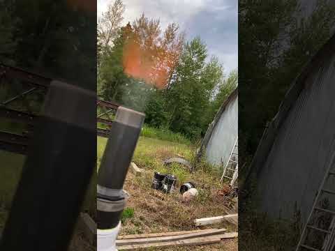

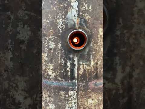

Gave the gasifier a go tonite, I have crappy booster cell phone service so I have a couple minute video and a couple shorts , I think it works.
The last light up was 30 min later
Great job DeanL.
You are on your way now.

Nice product and good gas, all praise. Years ago I read an article about the latest generation of Fiat engines and the author stated: “precise manufacturing … more power … lower consumption”
Congratulations Dean. Excellent work and always feels good to see someone succeed. I am a big fan of paint, hint hint.
Great job Dean !
Keep up the good work :slightly_smiling_face:
Very nice I’m building the same design you got me motivated to finish it up
Thanks guys, ya I was surprised it worked right off the bat like that, but I think starting with a proven design like WK or Ben’s when your just starting is the way to go.
