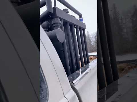

Warmed up to minus 10c so put another 45 miles on the truck, went to town for some birch. Here is a silent longer video of start up and switching to wood gas, I only have gas valve on the gasifier so I have to idle it up when I turn on gas.
Then I pushed it to about 23 inches of vacuum and hit 70mph, didn’t seem over heat or anything so might try to push it a little more next time, seems to run best at about 60 mph pulling about 15 inches.
I really gotta brag about you with that build. Everything looks factory with how nice it sits in that bed. I double like that lever you fabbed up for the gate valve.
Glad we’re starting to stretch our legs with some OBD2 vehicles, hats off bud.

Very good video, Dean! Not only does your build look great, it’s a very clean build - to the point where I can understand almost everything I’m looking at.
What happens inside and is hidden from the eyes, and this is essential for good performance, I already wrote once: “precise manufacturing - good performance - more power”. ![]()
Well I put another 30 miles or so on the gasifier and kind of abused it, pulled about 40inchs on it in passing gear and pushed it to 70 mph for a while, I’m gonna do some changes to it to improve some stuff but other wise it’s working good, wife says I’m a pessimist ( perfectionist)and it takes a lot to impress me but I’m gonna say I kind of like how this gasifier is working, and I just wanna say if if it wasn’t for Wayne and this forum and all the contributors Wayne , Tone and his tractor,Cody and Steve and Ben Peterson’s specs I used it prob wouldn’t have happened. Got to go build bridges for a few months now (I’m kind of lazy so I don’t want do do it but they pay me lots of money and I need the money)so I might not be working on it much till spring, might take it to work a couple times if I can chunk enuf wood.
