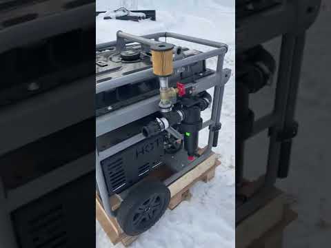

Made an air box for generator
More insulation on gasifier
Some short videos of gasifier and generator
I tried to reload them , don’t know if they’ll work?
Excellent job Dean. Very professional. The last two video’s are private. You would have to open them for general viewing.
