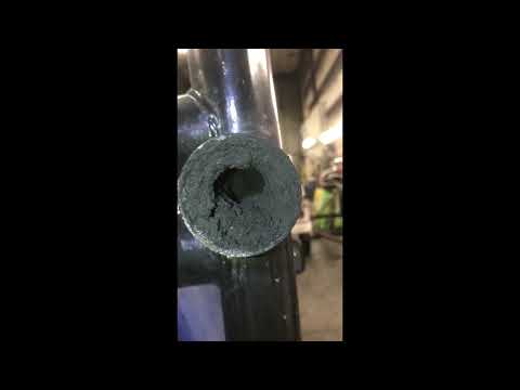

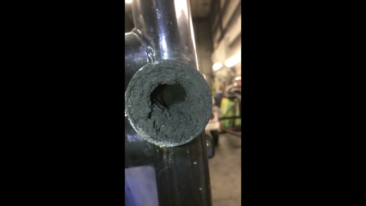

Hey Marcus , Thanks much for the cleaning video .

Great video Marcus on rail and condensation tank clean out. Some of the members put clean out bibs on the pipe trees to clean out the rails with out removing them.
I like to just loosen the back rail couplings remove the rails on the back and flush with a straight spray nozzle. But boy does all that soot comes shooting out. Lol.
How many miles was that between clean out of your rails?
I cleaned out the bottom rails last week, but that was about 2000 miles on the uppers and front rails. Plenty of miles to get clogged up! Iâll have cleanouts ports on the next build, only because a few rails wonât be removable
Always make them removable. I like my new design of not having any rail behind my back window or a center rail tree. I just added one more rail to each side. No welding up a center tree alot less work in building. Less expenses in rubber couplings. Less places to have a air leak.
My 3" header out of the drop box to the side rail trees never get clogged up with soot. Rails sloping downward to the back keeps the soot moving to the condensation tank for storage and easy quick clean out at the drain. Most of the time my rails stay warm up front and cool at the back unless it is a hot day. All made from 409 exhaust piping. This was the forth set. I rebuilt the trees that Chris S. Built but they did not last very long. I hope this set will last a long time.
One rail on each side will be permanent, integral to the truck. With a access door built in for heavy cleanings. No way it can clog, but the option is there to easily clean it out. How many feet of rails do you have no bob and what size?
