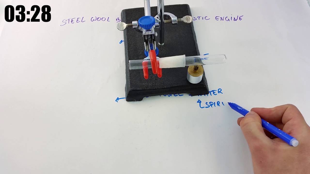

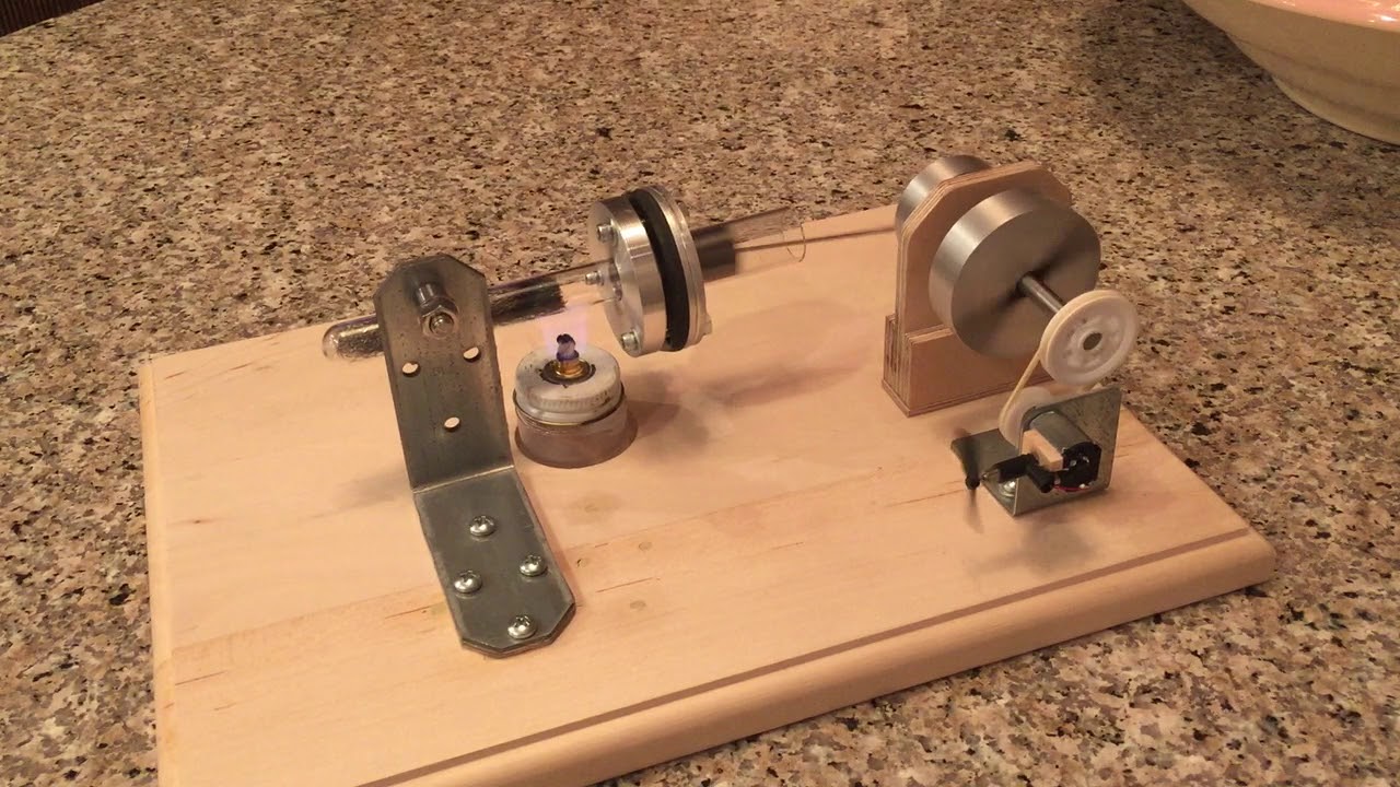

I know I’m late to the conversation. I hope this may energize some imaginative, outside the box thinking. (My specialty) one could use a low temp Sterling engine and power it rather than using it to power something. If temperature differences make it move by altering pressure then theoretically making it move would cause pressure change therefore changing the temperature? Just a thought.
A heat pump or heat machine, if a 50-degree femper temperature difference is used, should be solid efficiency (over 10 percent), promising the possibility of producing electricity from a low-temperature source
I think in the mean time the butane based r600 fridges have come of age. They use significantly less energy then the r134 options… The high pressure stirlings are interesting the tesla uses one for heating and cooling i believe but its really pricey…
I’m sure a homemade Stirling would work for heating and cooling, now I’m going to have to try it.

I’ve posted on Stirling engines elsewhere but in short - I wouldn’t waste my time there, especially for HVAC.
I’ve got another rabbit hole to explore. Look up thermoacoustic refrigeration. Working on a Stirling cycle, was actually scaled up at Sandia labs to work at cooling and compression of natural gas or maybe LPG. No moving parts, any heat source could be used.
