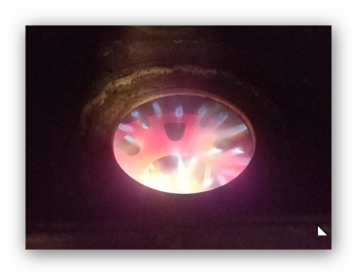

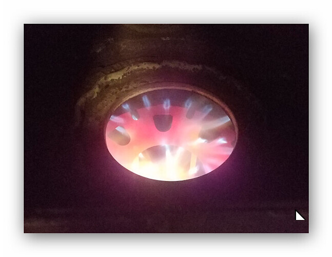

The end of last nights burn:
Worked great, I’ll be checking the results this evening.
The fire itself was too smoky, the smothering was not too bad.

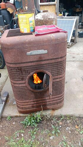

I use the old 30s vintage fuel oil pot stoves. They use a vaporizing pot to turn fuel oil into something that’ll burn. They don’t have a wick, they don’t have any fuel pumps or use any electricity. They just use a pool of fuel oil in a combustion chamber that operates in a reducing mode. They are always sort of starved for air. Well the reason those stoves are still around even though they are made out of sheet metal, is they never have an oxidizing Flame. Going back to the waste oil burner, I would say that adding Steam would cool off a reaction that’s getting too hot because it’s running rich and provide oxygen for all that extra carbon that’s available with the used motor oil.

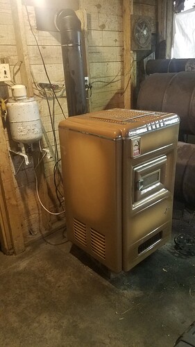

I like those old oil stoves too. I put a tee in the oil line in back of the stove and drip waste oil in along with a little #1 oil through to get it hot.
They burn nice and clean
