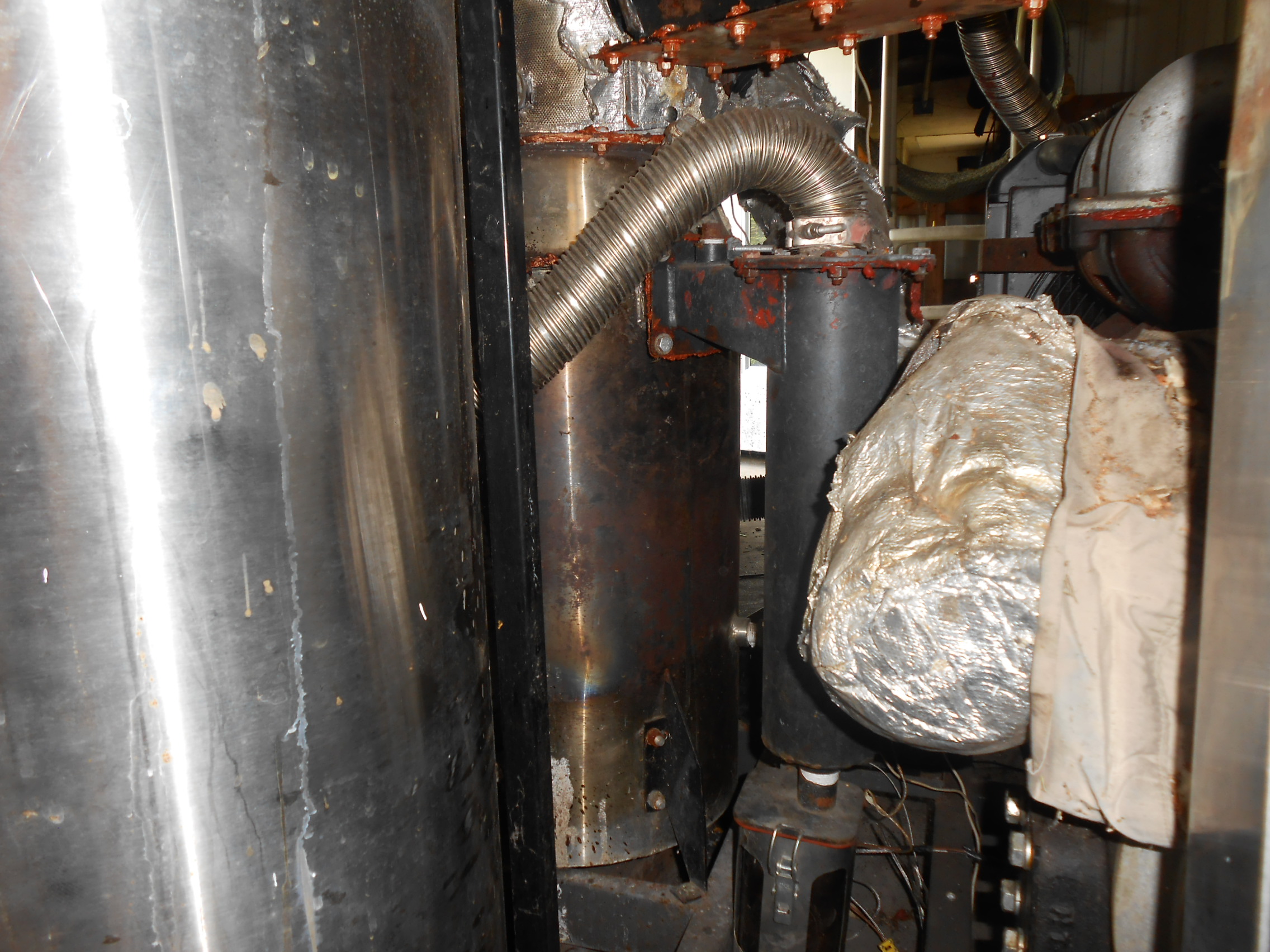

not as simple as you may think. this furnace has come through a lot of changes in the last few years . it has been around sence the 80s. first as top lit gasifiers. then close coupled chip gasifiers etc. this is just the newest version of chip energys furnace. I have been watching the development closely . the only problem with it is it is a updraft gasifier close coupled to burn the gas in the same chamber which makes it to high for what i am working on BUT GREAT FURNACE.

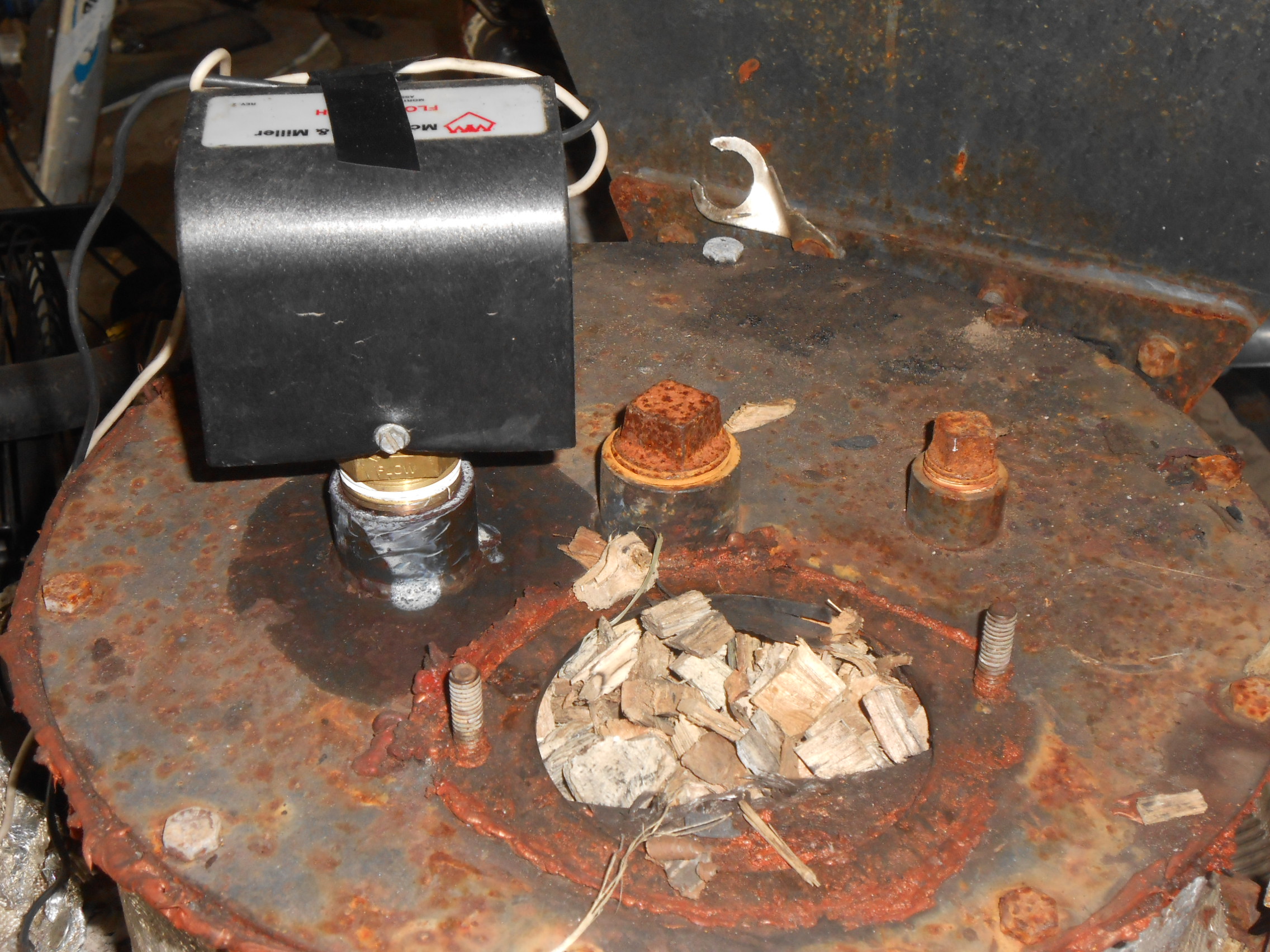

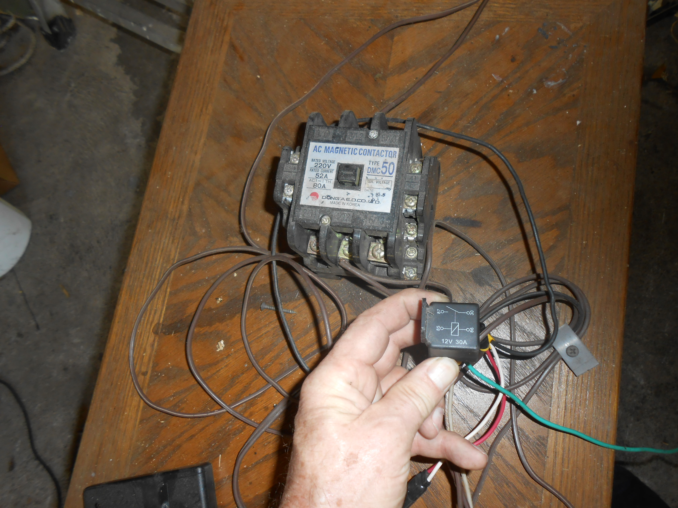

Large switch plate auger on
auger off 12 volt relay burned out
Strange, you sent the current of the auger through the switch?
Thanks for the pics, should work nice

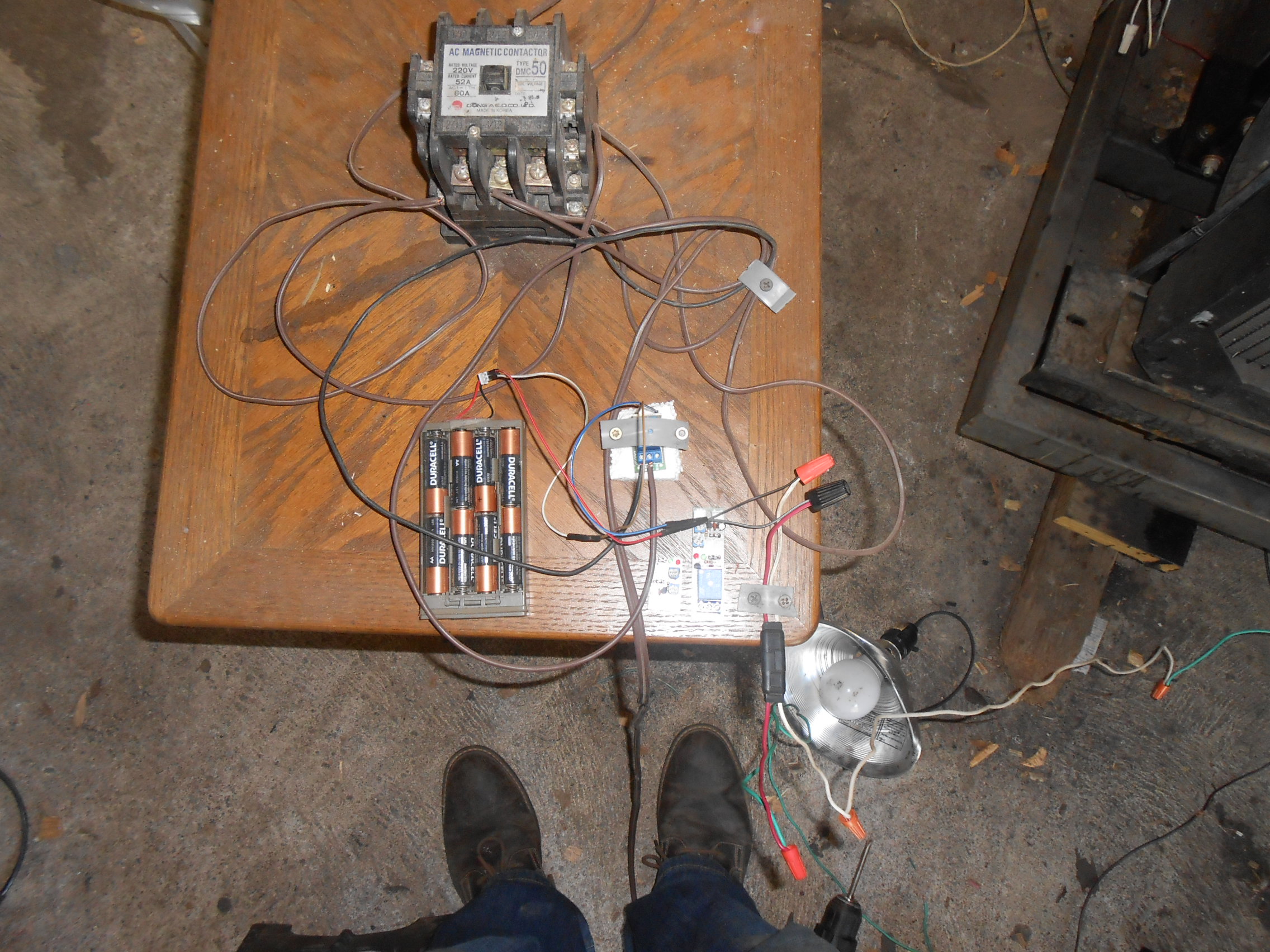

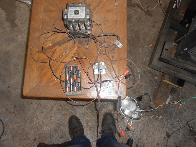

The contractor switches voltage 110 voltage to auger , the 12 volt relay gets 12 volts , the relay triggers contractor
Replaced bad relay with good relay from bad circuit board powered with 8 aa batteries

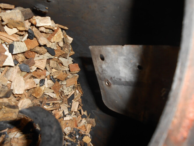

Woodgasser cyclone , mason jar

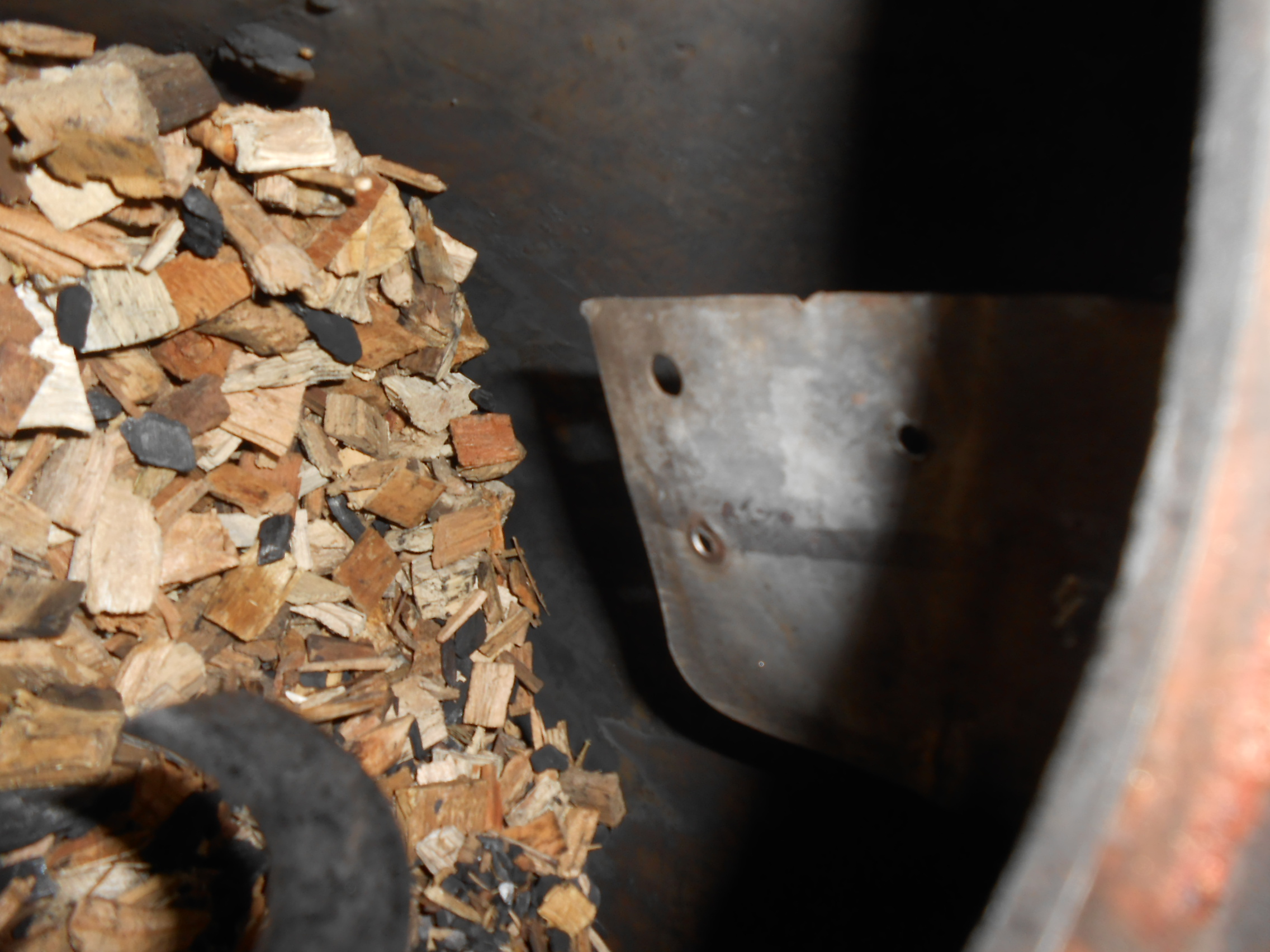

inside woodgasser wood chips auger and flow switch plate .

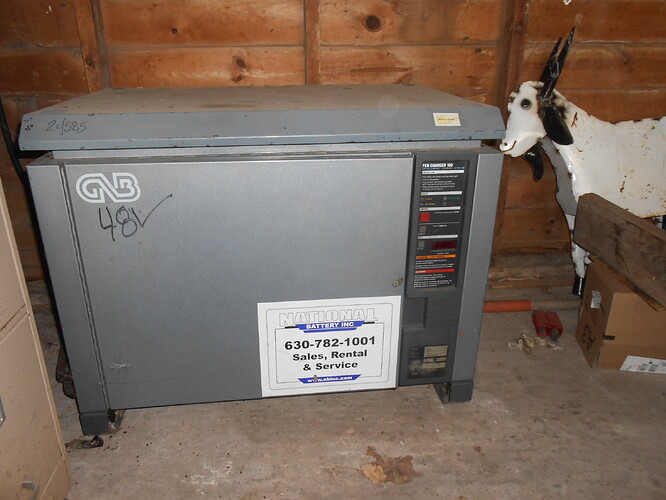

It is a direct drive to generator will produce power from 1500 to 1800 rpm three phase 440 volt to 48 volt battery charger , sixteen l 16 Trojan batteries outback radian inverter to grid . Should have off grid , Law requires specially bonded electrician who charges $1000 a day to show up . He was here one day . He brought wrong parts spent much of day traveling back and forth to get right parts . Made sure it was finished one day , not much of system .

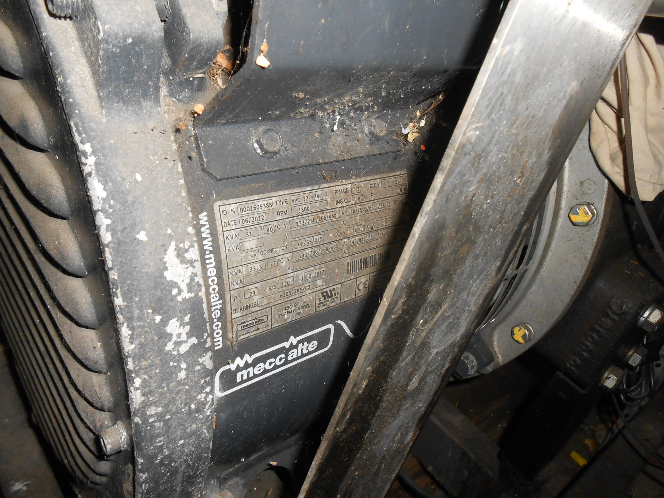

If you had a pellet maker like this thing, you could make a simplified gasifier to convert the fuel to char pellets on one process. Im certain I could build a version of my current reactor to bulk produce pellets. I think It would need to be bigger with more air in feed and a larger restriction. Automated grate will flow the charpellets into a collection bin.
gen head

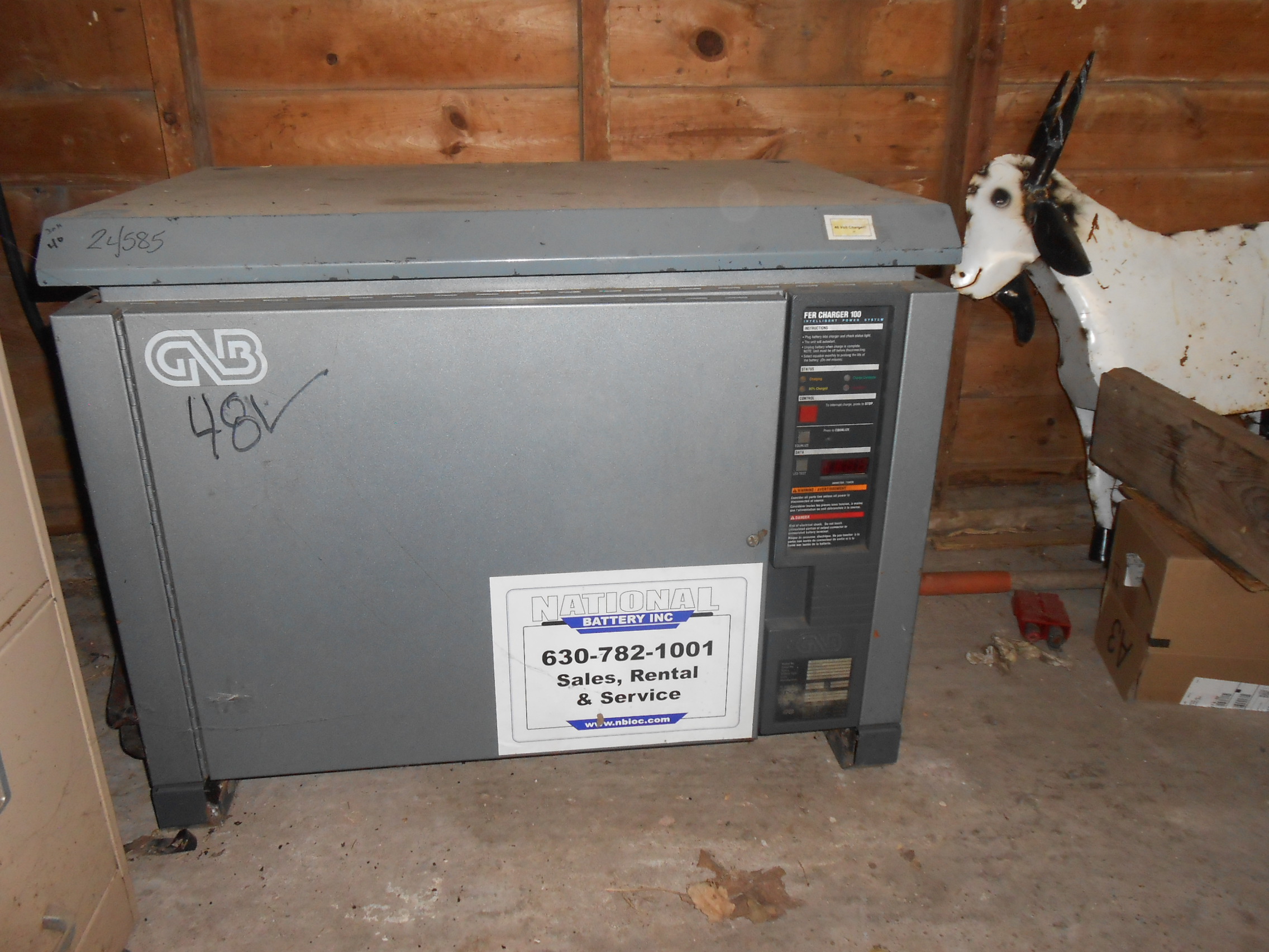

Charger is off lease , fork lift buyer refused to take it , so I got it cheap .

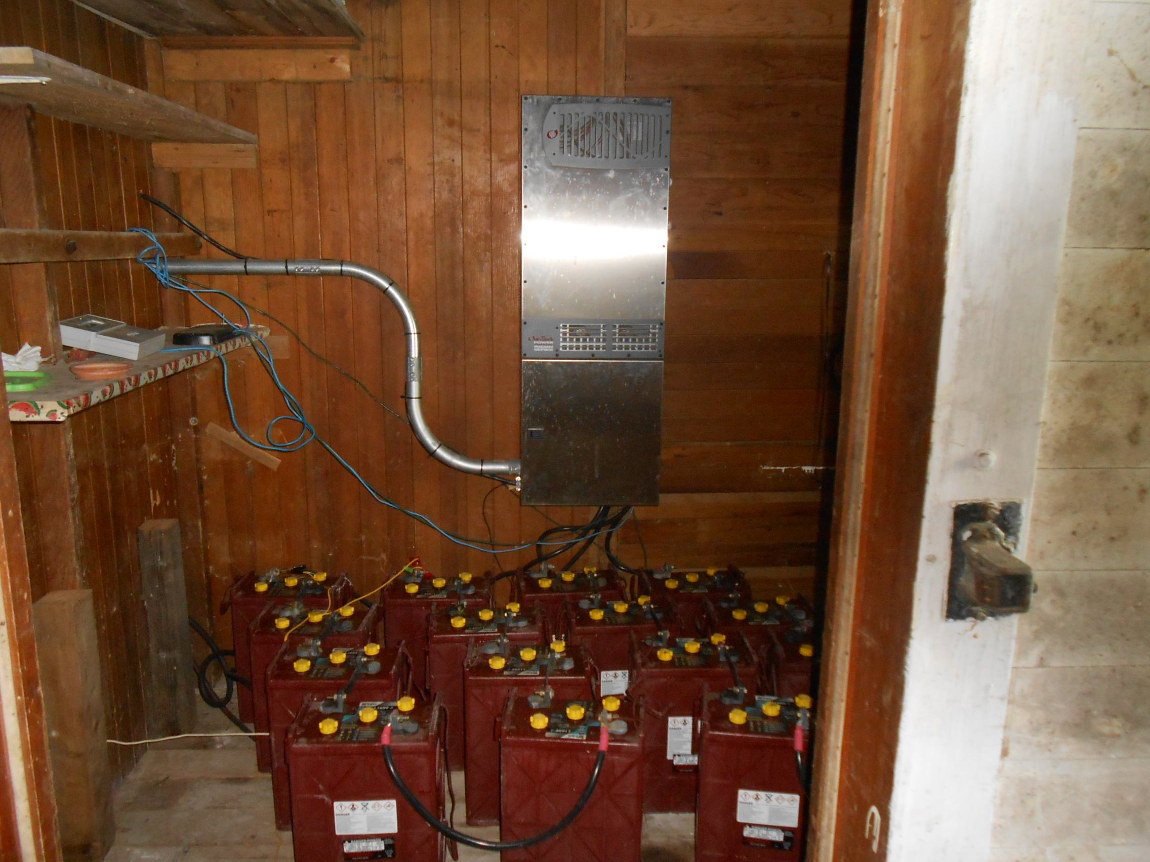

battery and inverter

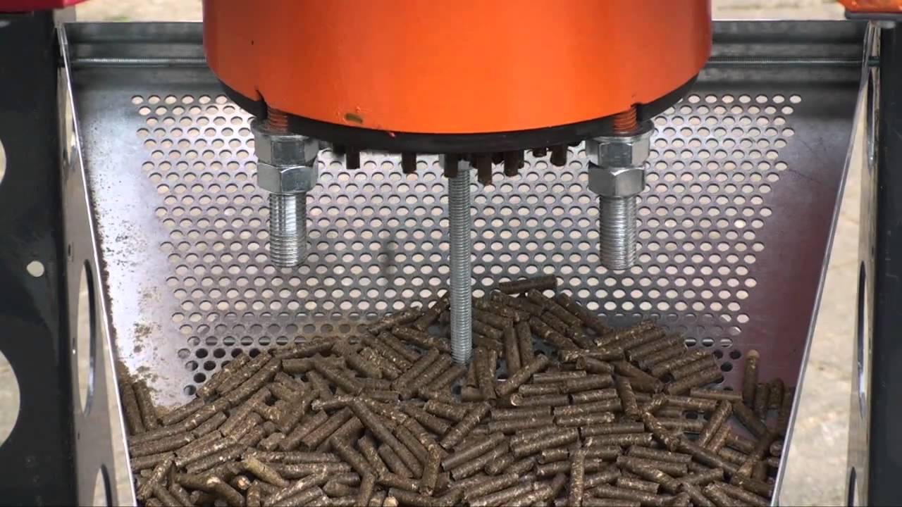

Matt, I have seen that one a few years ago. Pelleting green wood? Don’t believe every video you see.
We all wish it was that easy just drop in green wood branches etc. and out comes pellets . If it was that easy i would have a machine tomorrow . but dont you think green wood would plug up the motor valves. as well as all pipes etc. by the way how did it chip up the branches boards and the worse of all the blocks of wood
