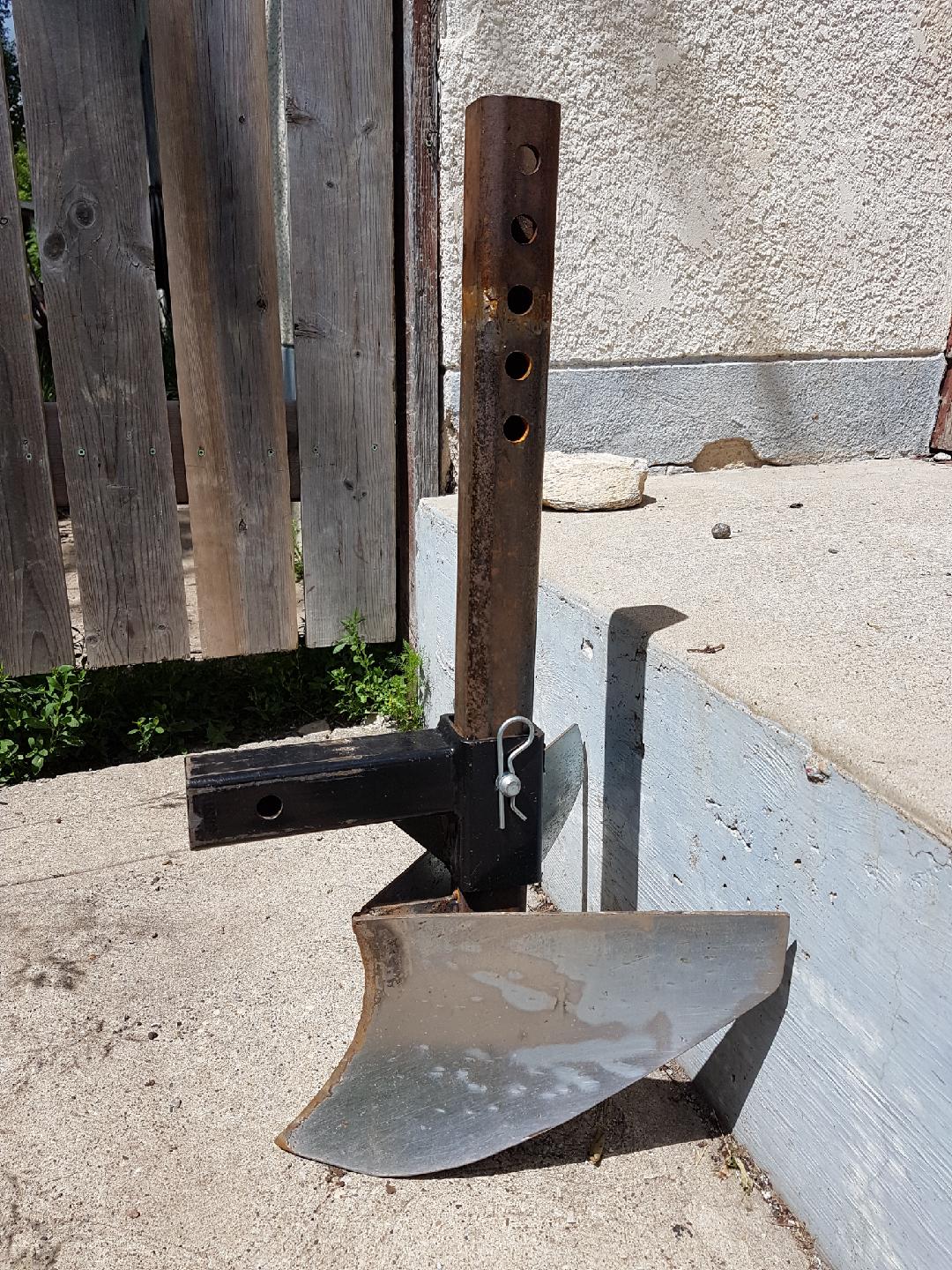

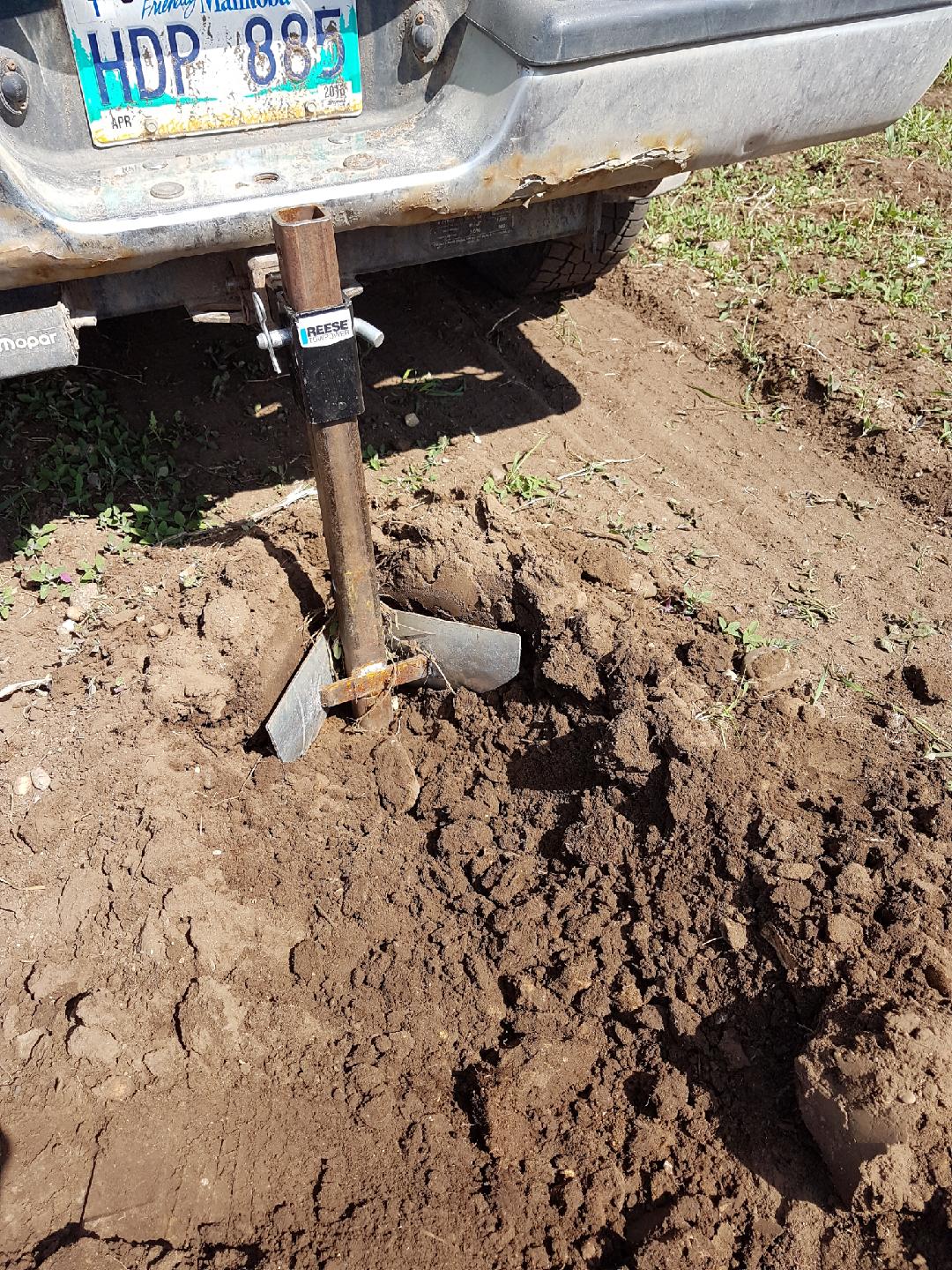

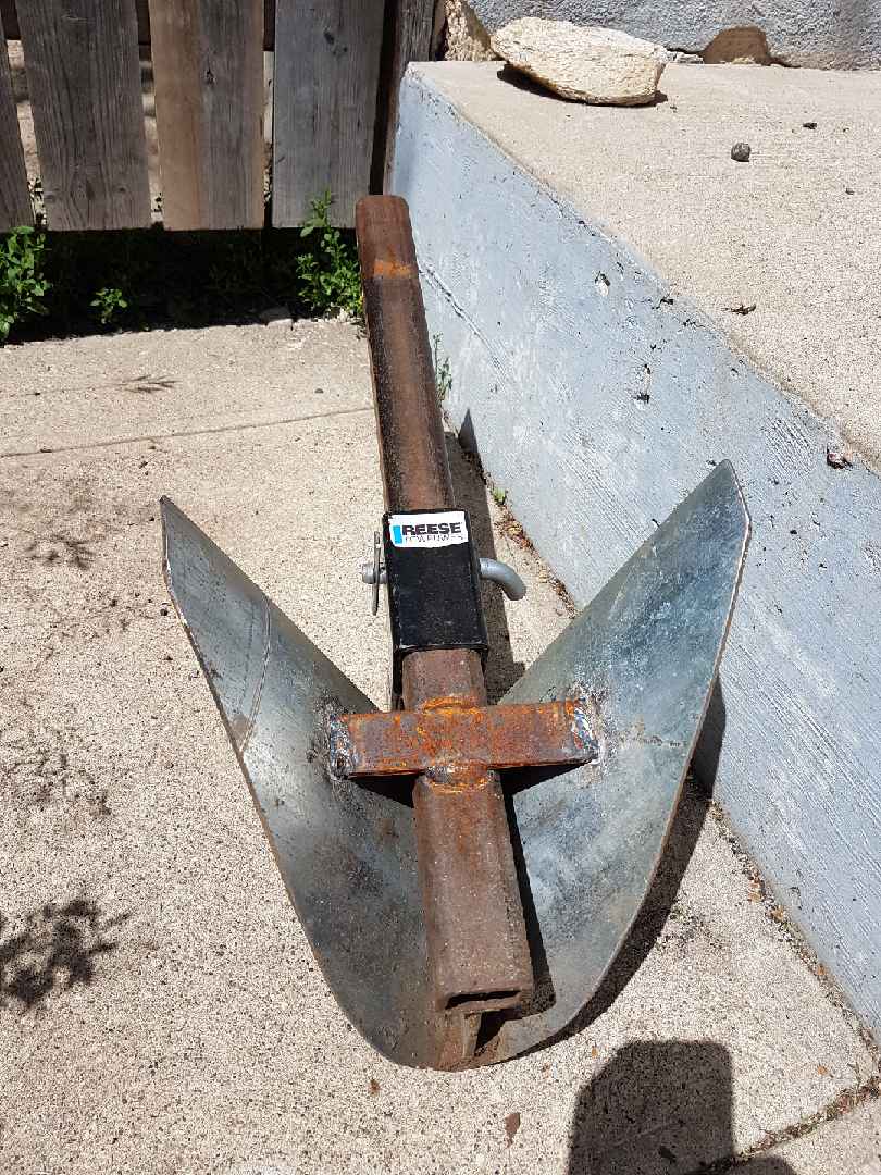

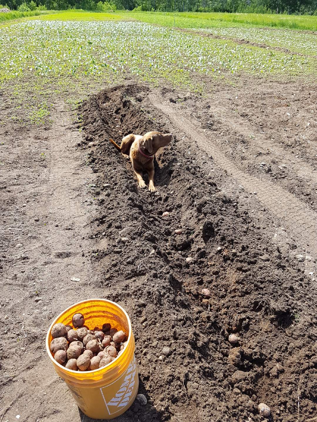

I was facing a potato planting job without the right equipment. I did have lots of seed potatoes and the land. For next year I will have a ground wheel driven ripper and planter, but for this year I put together a simple ripper to open a furrow, greatly reducing the work. As crude as it is, it works quite well.
Ha! Good thinking!

Great set of potato planting pictures GaryT.
Yep. My dog-gone-dog like to diggin’ help too.

I am laughing because I plowed a couple years ago with a walk behind plow chained to my old 1981 VW quantum diesel. You bring back some memories…lookls good…lol
A 6,000 lb 4wd truck is pretty close to being a tractor anyways… :smile:
yeah, works fine. I have often thought of doing the same thing but I don’t have a 4x4.
gits it dun…
Just thinking about plowing that way a couple years ago…this year I didn’t have time to plow so I took the skid steer and “flipped” the dirt to plow it. Dig in, pull forward, flip 3 or 4 feet of soil. back up, do it again. It took aboput 30 minutes to “plow” two of the three gardens. But I’m paying for it now. It turned it deeper than I ever have so the rocks came up again. I had pretty well cleared them, and also I am really weak on nitrogen. It reminds me of the old timers telling stories of the poor crops they made the first year they got a tractor. The tractors would plow deeper than the mules had ever plowed and they buried all their top soil too deep to make good crops. Guess that’s what I did. Our yields are much lower than usual, but we’re sorta glad actually. Not relying on produce for our primary income means we don’t have to worry so much about it. Already more busy than we want to be canning and freezing anyway. Beets yesterday, mushrooms today (the boys picked another five gallons today). beans tomorrow, pickles every other day.
ANyway, thanks for the laugh and memory recall.

Regarding planting of potatoes, usual practice here is to plant about 4" deep, as heat or dry conditions could cause problems. Ideally I would aim for a lower trench to facilitate hilling, but the truck tended to push soil from beside the trenches.
