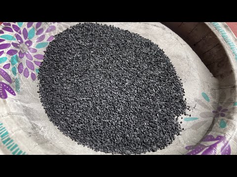

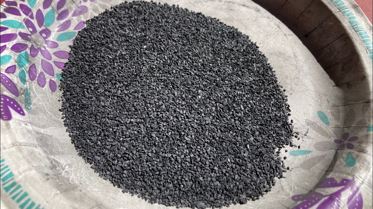

I did another dust experiment where I filled the hopper 80% with clean 1/2 inch charcoal then filled the rest with fines and dust.
The run was pretty much normal. At the end of the run the dust was almost all consumed and what remained looked a bit like this;
There might have been a little more dust in the course filter.
