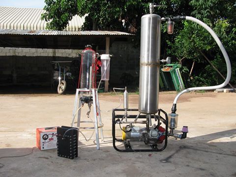

Koen last picture you posted remained unexplained.
This version is it to be heated by HHO?
Not sure yet about its final destination, its foreseen as two stage charcoal gasifier, but i am waiting for testing.
first the build with the exhaust.
The HHO module could be implemented on any other gasifier

The newest development…
This Co2 Converter setup uses green waste charcoal + the waste heat from the exhaust gasses AND the exhaust gasses itself, to produce electricity and syngas for a cooking unit or for storage the syngas for later use.
All the exhaust gasses are turned into use, NO EMISSIONS…
Innovation Made in Thailand
Why waste more energy if already wasted energy can be used ?
The Co2 converter technology from Renewable Energy Thailand does what it say’s
Convert Co2 into energy
Hi Koen
This seems very impressive. Can you explain a little more?
You recycle 100% of échapement gas?
Introduce yourself HHO to heat the reaction CO2 reduction?
Thierry
Hi Thierry,
Yes, i use 100% of the gas d’échappement pour le chaleur.
puis j’ajoutte HHO pour augmenter la temperature jus’q au niveau neccesaire…
ofcourse there is more output from the gasifier then the engine needs, more from the air needed for the combustion in the IC engine, + the carbon being gasified + the HHO.
The HHO is only little, about 2 liters per minute at max.
I start with air + HHO with spark ignition
:wink: i hope you can read my french :stuck_out_tongue:
It’s great and almost incredible!
Do you have an idea of the energy balance of the whole?
the use of exhaust heat counts for 30% from the engine input
The HHO takes about 400 watts at max
The charcoal is now gasified with the “external” heat applied instead of combusted/ converted
the exact numbers need to be measured in lab conditions,
this setup, as pictured, is a “real life”
but imagine the possibility’s

You do fascinating work, Koen, and I await a schematic that clarifies what we’re looking at in the last picture. Thanks for sharing your charcoal adventures!

Hello Van Looken… I have checked online but I haven’t found any patent about your CO2 converter…however your actual CO2 CONVERTER design can’t produce an good quality syngas because is wrong mix HHO togheter with the exaust gas… you produce an unnecessary high thermal power locally but the syngas quality is bad. And … is wrong use an bigger amount of charcoal inside the reactor because some carbon atoms, produced by HHO/EXAUST GAS reaction and captured from the syngas flow , are mixed togheter with the output syngas. You can use these atoms in other way reducing a lot the amount of charcoal and increasing the production of good quality syngas using 100% of exaust gas from the engine. That means also reduce a lot the dimension of reactor. You upload just photos but is possible watch an little video with the syngas flame from CO2 CONVERTER with an burner? Don’t worry… are just suggestions… Best Regards
Hello Lanini…
I must be doing something wrong then, coz i do have useable gas… did not count for atoms yet, but wil ask the running engine…
