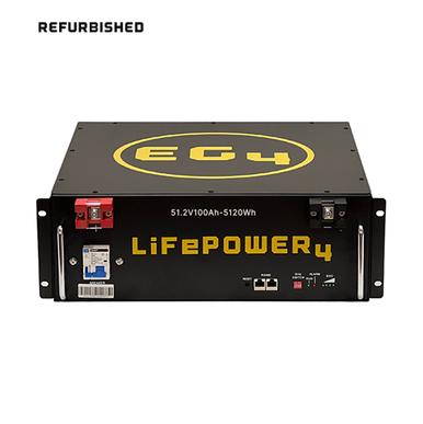

Yup it’s impossible to beat the 5 kwhr lithium server batteries which are just so cheap now… The certified name brands are pricier but not by much. Even when dealing with cold conditions it’s now cheaper to provide heat to the battery then accept the reduced capacity of lead acid… That is a fundamental change in the last 2 years …

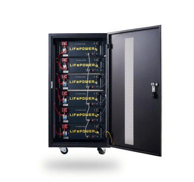

If you’re already ordering a chargeverter from Signature Solar, I recommend their rackmount battery, it has CANBUS and will talk to the hybrid all-in-one inverters, should you upgrade to that eventually. About the same price, $1000-1200. If you get six batteries they’ll throw in a nice cabinet to store them.
I have two of them already. They are awesome!
I’ve been quoting the Pytes V5 for my orders… virtually identical, but with built in heater which I need most of the time (not sure if the EG4 has that or not). $1600 on signature solar’s site Pytes V5 LiFePO4 Battery Pack
