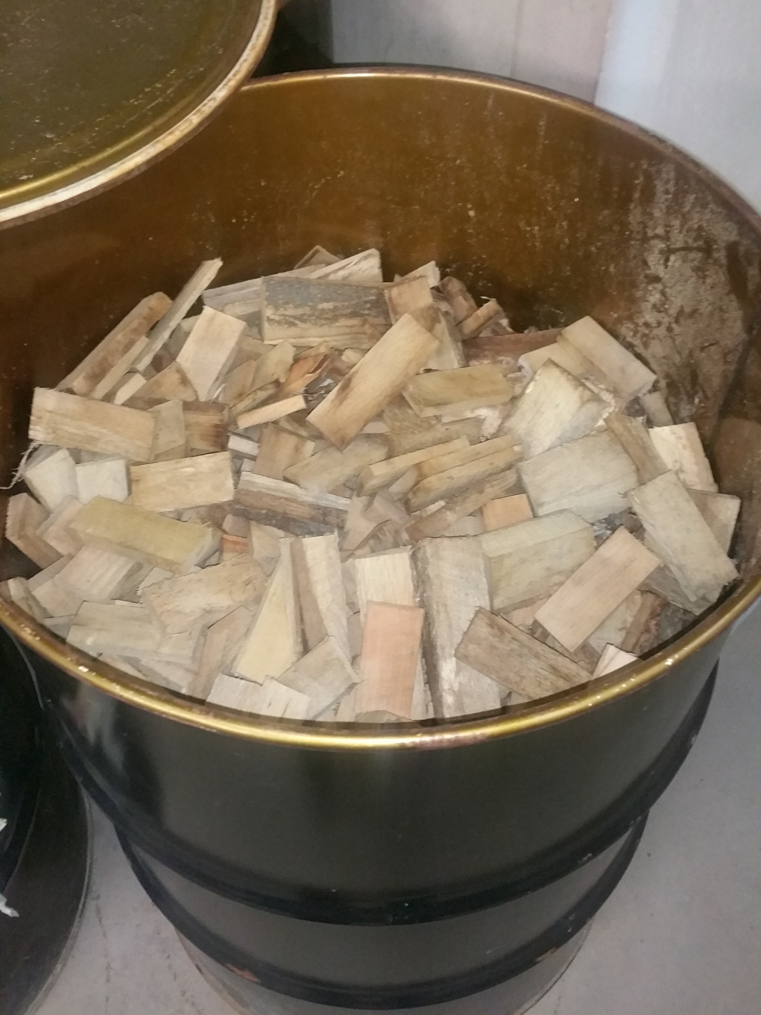

Going to try putting a batch in tonight.

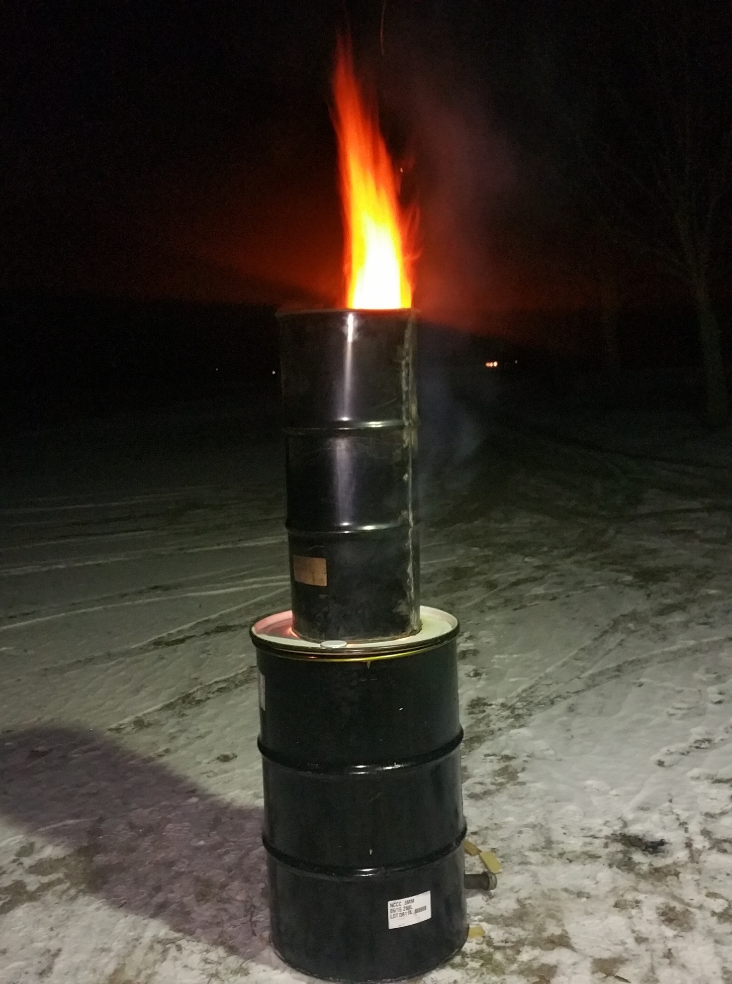

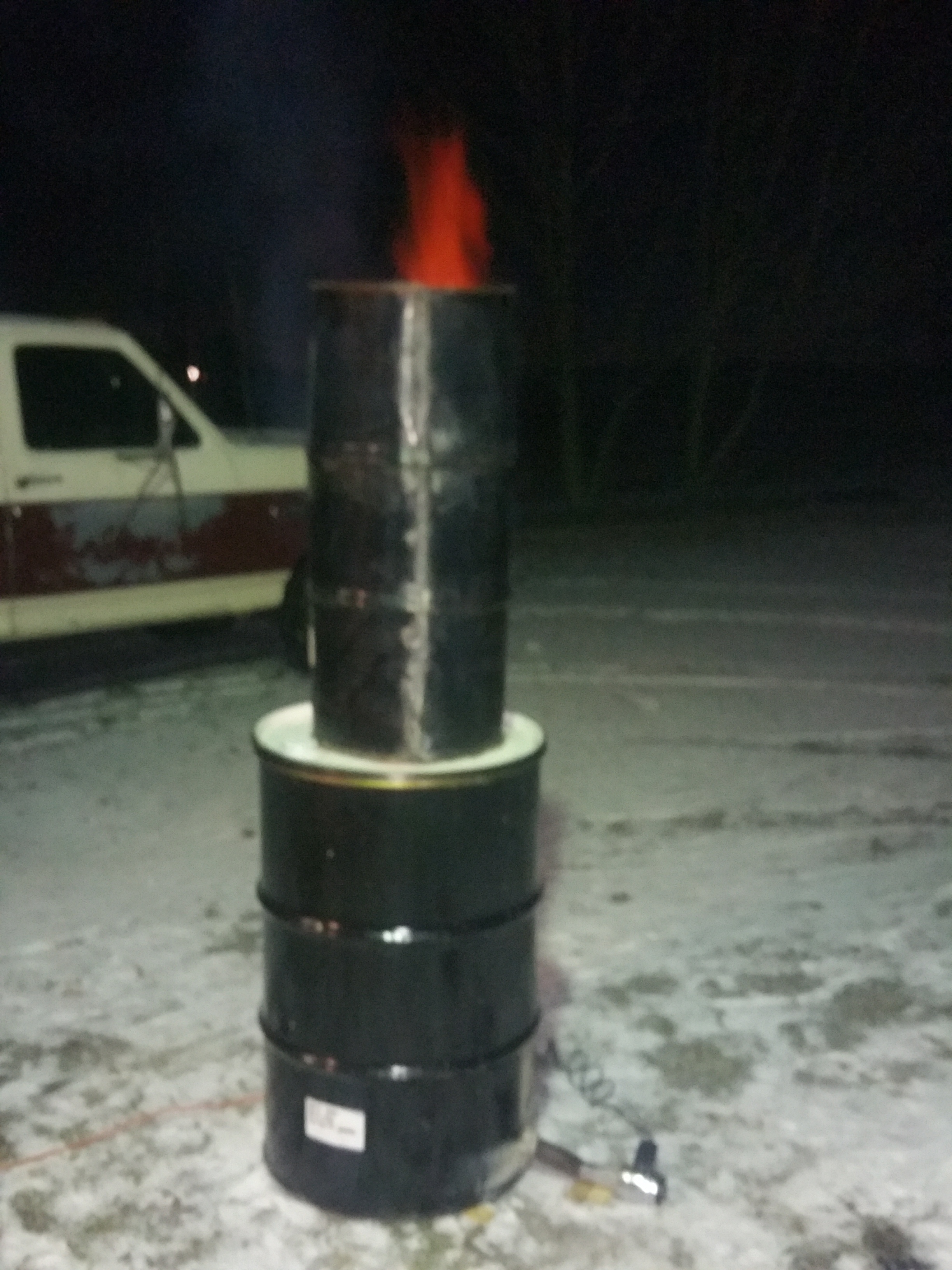

Looks good! Can we get a picture of it as a whole?

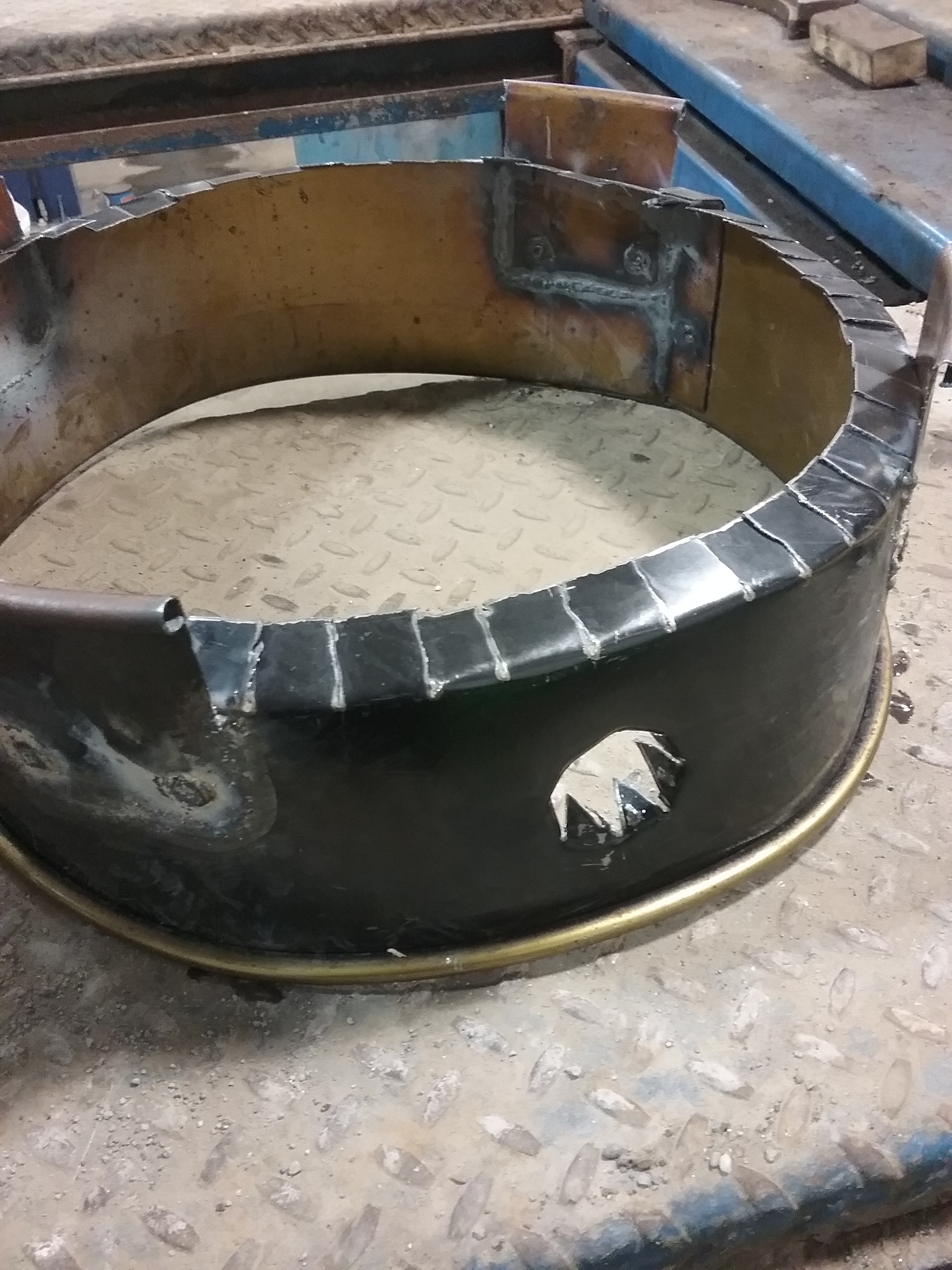

Go ahead and open both bottom air inlets and see what happens. Were is the secondary air inlet for the afterburner? My bet is you will be getting some black smoke from time to time with out the secondary holes. Here is an easy experiment, Take some 1/2" rebar or some thing like that and use it to lift the afterburner off the top of the drum lid. This will allow oxygen to mix with the hot flames and give a cleaner burn, Your wood looks nice, so long as it is dry. I even use long pieces of wood that are the length of the barrel, but split to be no more than three inches thick. These are stood on end and the fire lit on top.

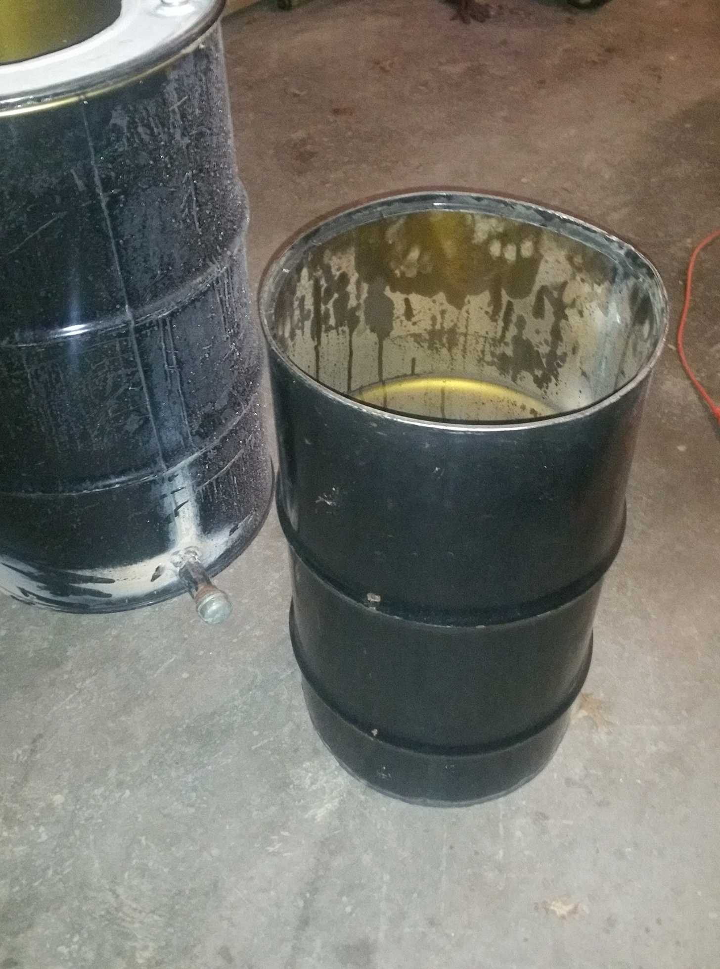

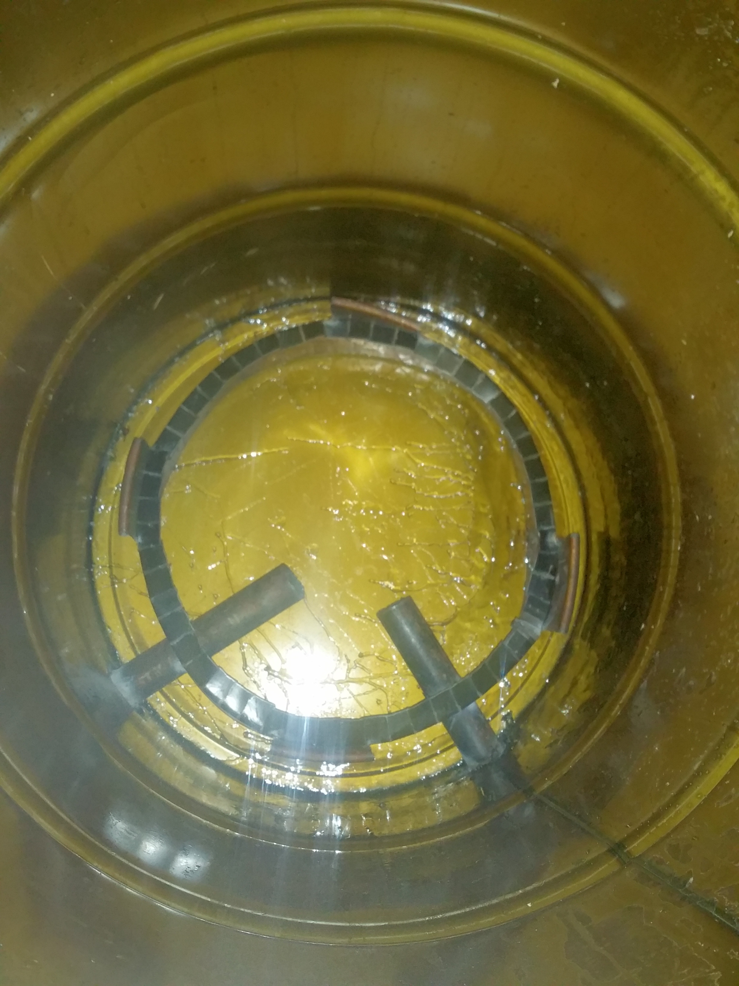

Oh, you do have holes punched in the bottom of the drum that is holding the wood? Yes?
Isn’t making charcoal FUN?

Thanks Gary,
I’ll add some holes or add some rebar to the after burner. Yes there is holes in the wood basket.
Making charoal is fun

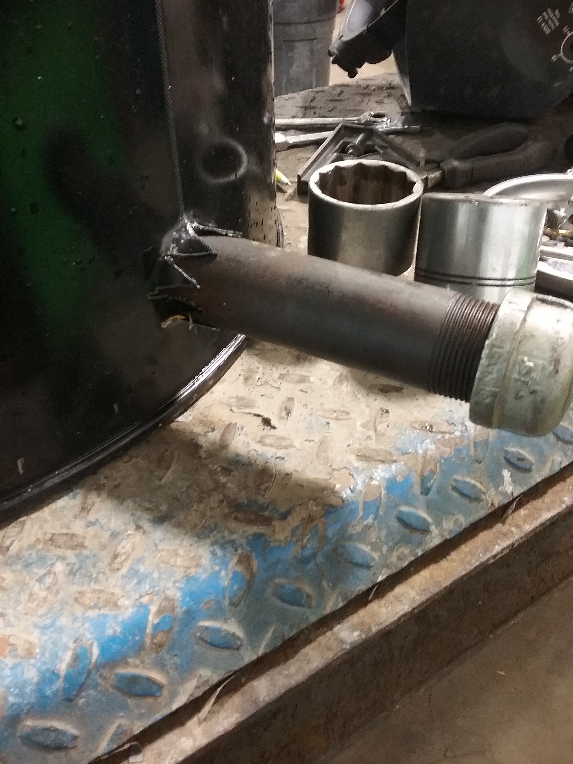

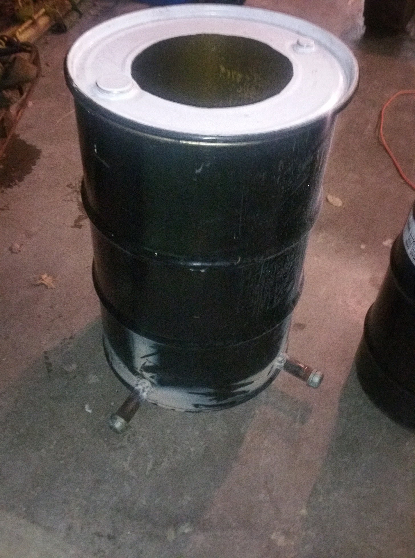

With those pipes you’ve got in the bottom, it looks like you[ve already got a simple fire. just take off the chimney and put a solid lid with a hose fitting.
That’s what I thought you were making. Hmmm, so if those two at the bottom were welded and have a different top to secure down, it could be a simple fire, right?
Hi Bill,
I chose to make some charcoal first. Sorry it wasn’t made clear. Kind of a “don’t get the cart before the horse” thought process.
Both pipes at the bottom are welded. (Although this morning i saw a pin hole)
Andy,
I definitely could use this as a simple fire, but woud rather have something in the 20 gallon range so that it is easier to clean, change the nozzle and mount on my JD 140 if I want. I don’t have a generator yet but if I get one then I may use a 55 gallon drum for something like that.
