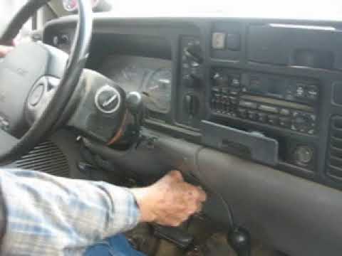

Hello Tim .
I hardly ever close my wood gas valves but do close my air mix . In a way that is shutting down any air flow because the air can’t go out or in the air breather / mixing pot .

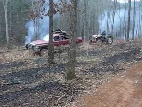

Thanks Wayne. That is some impressive towing. That’s about all I need for what I have in mind. anything above that is bonus. Love the sound of that engine
Tim
I would consider my dodge Dakotas useless for off road operation .
Will let you make up your on mind on the work truck ![]()
No gasoline involved
I am not familiar with your vehicle brands Wayne. I am assuming the one towing the tractor was the Dakota?
That V 10 is impressive. That trailer and hay was what -2.5 tonnes?
Are the 4x4 and if so was the towing high range or low range?
He was using the Dodge Ram 2500 V10 for towing the tractor. His Dakota is a little Ute to put it in Aussie terms, I don’t know if people in SA use that term.
The Dakota is about the same size as the old Toyota Hilux but with a 5.2L V8.
