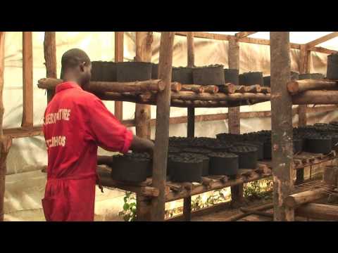

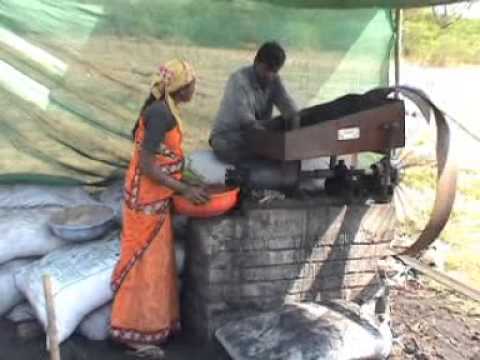

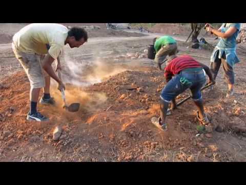

Here are some ideas from You Tube. I will try to make a video of OUR manual briquette machine that has been working por about 25 years now …and it STILL WORKS!
