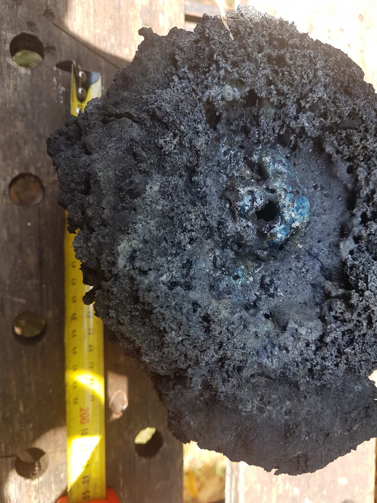

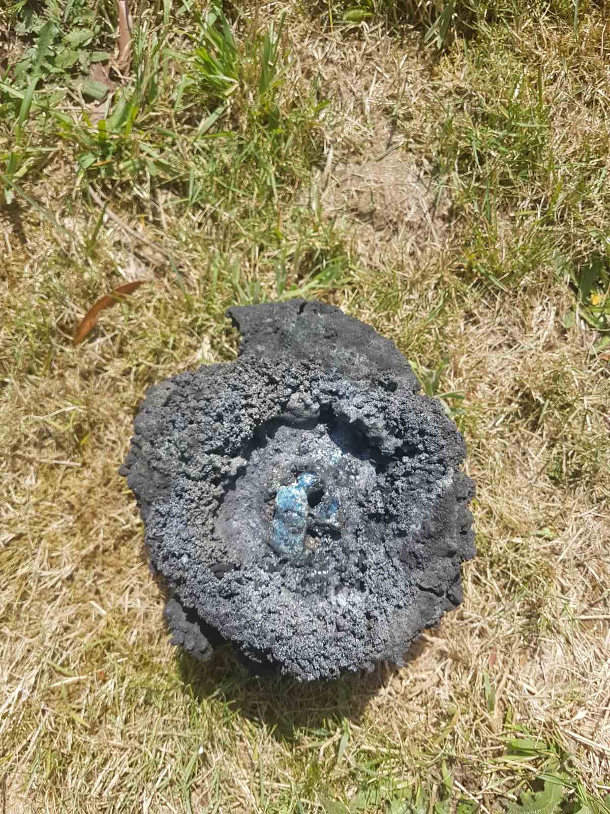

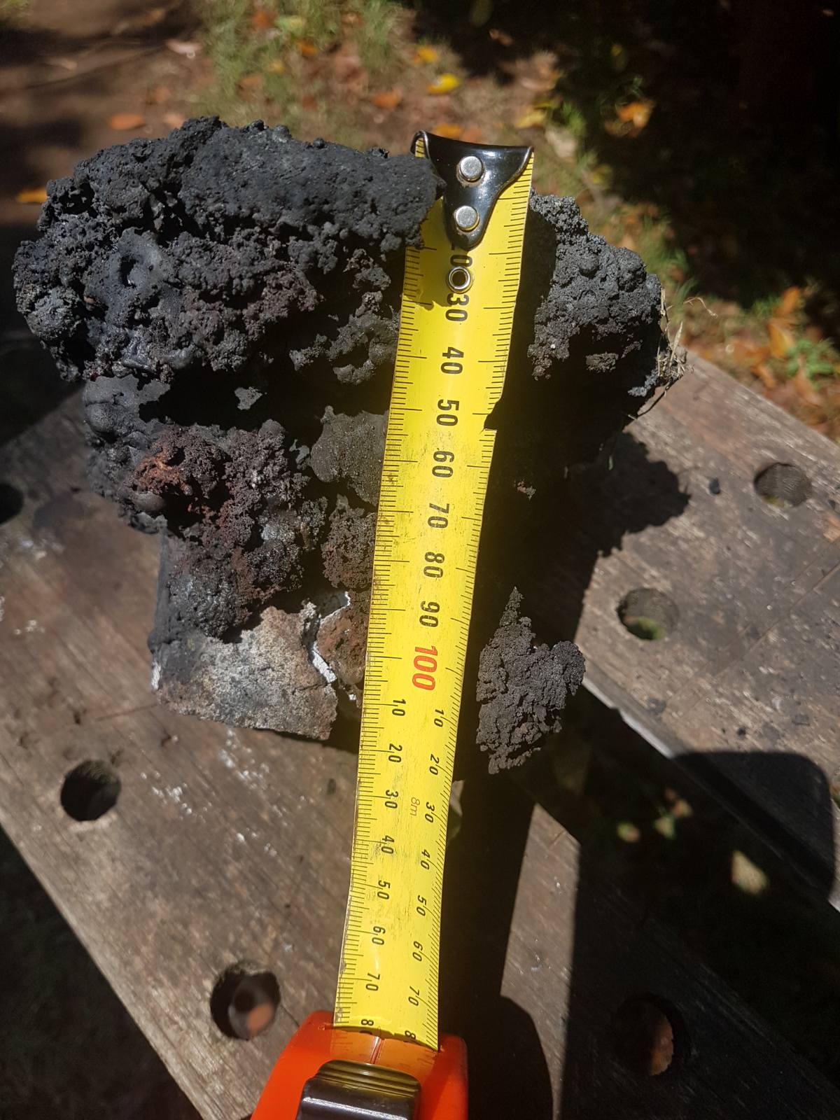

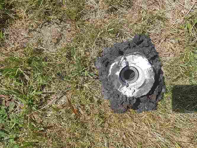

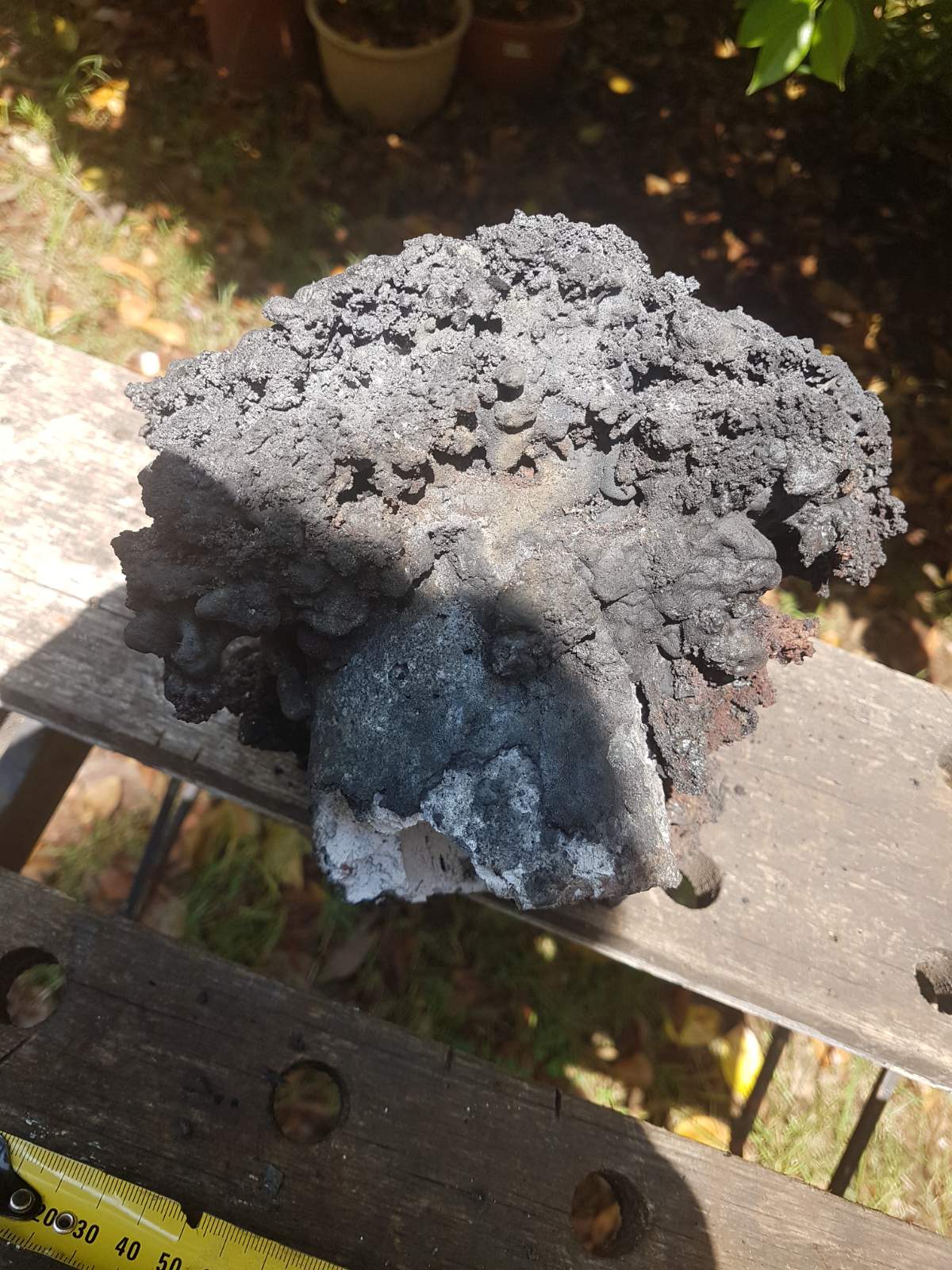

Koen, you just might be correct in your thinking because i have never ever had to empty out ash from below the nozzle , only ever a molten slag mountain around the nozzle tip

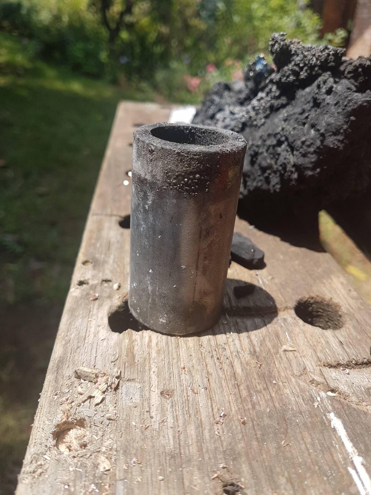

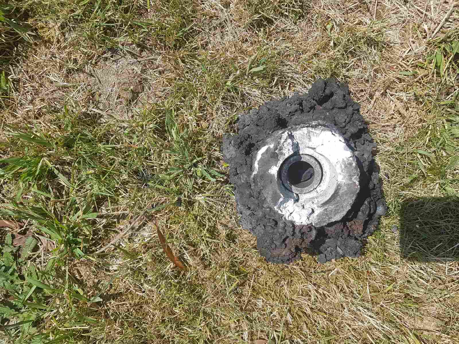

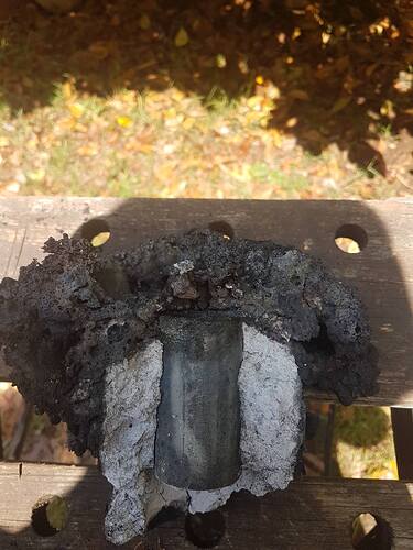

I decided today was the day i shall start turning this updraft into a downdraft with a simple reversal of the outlet to inlet and and inlet to outlet with just the addition of a downwards facing nozzle and leaving the old nozzle in place and adding ash around it , and of course nothing ever is that simple and things are bound to go wrong , well i just could not get the nozzle to unscrew from its fitting on the bottom of the drum as i wanted to get it out and clean up the molten slag around the nozzle tip and in the end the refractory crumbled away from the galv fitting i had it and then nozzle attached too .
As you can see the nozzle i put in my system in 2018 has lasted really well with no damage at all to the thick wall-HEXOLOY Silicon Carbide nozzle and only the refractory let it down when trying to unscrew it from the male fitting a while go .

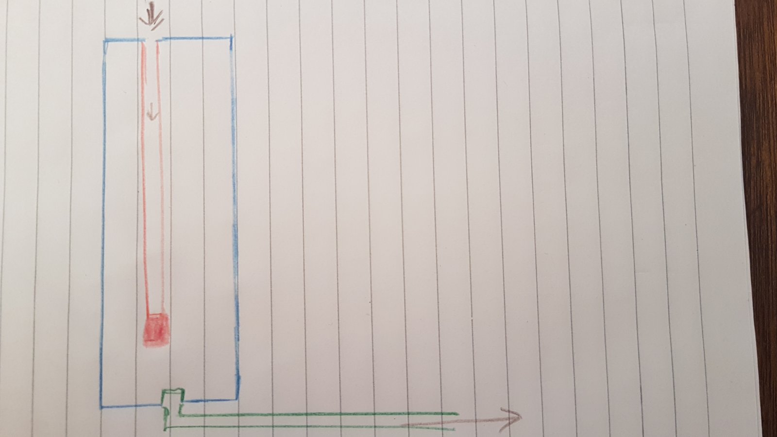

Here is what i have in mind this is a just a simple in my head sort of sketch i want to try out and so can refine it as i go along , this again will be inside a 55 gallon drum with a lock ring lid
You will lose all the cooling affect of the gas going “up” through the charcoal. Are you going to make up cooling rails for it? TomC
Hi Tom , i have a lot of area already where the gas passes through so i dont think cooling will be major problem , i have just made up the nozzle and i have a distance of around 14 inches between the end of the nozzle and the outlet manifold , if that does not work i can adjust the height by using a shorter length.

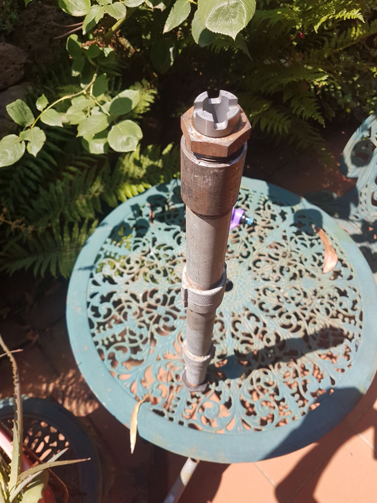

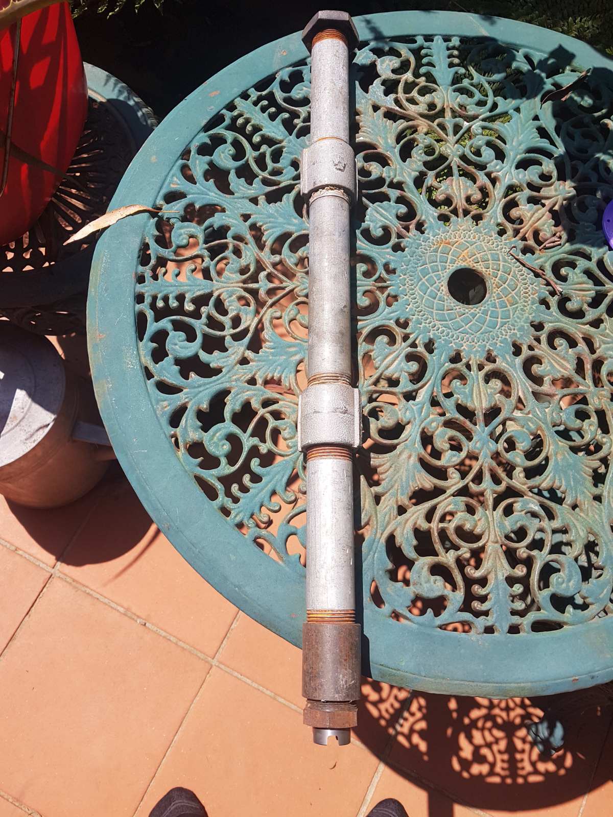

This is what i have made up so far
If i have to have more depth then i can weld a container onto the bottom of the drum to lower the exit manifold so more charcoal depth is gained without losing run time

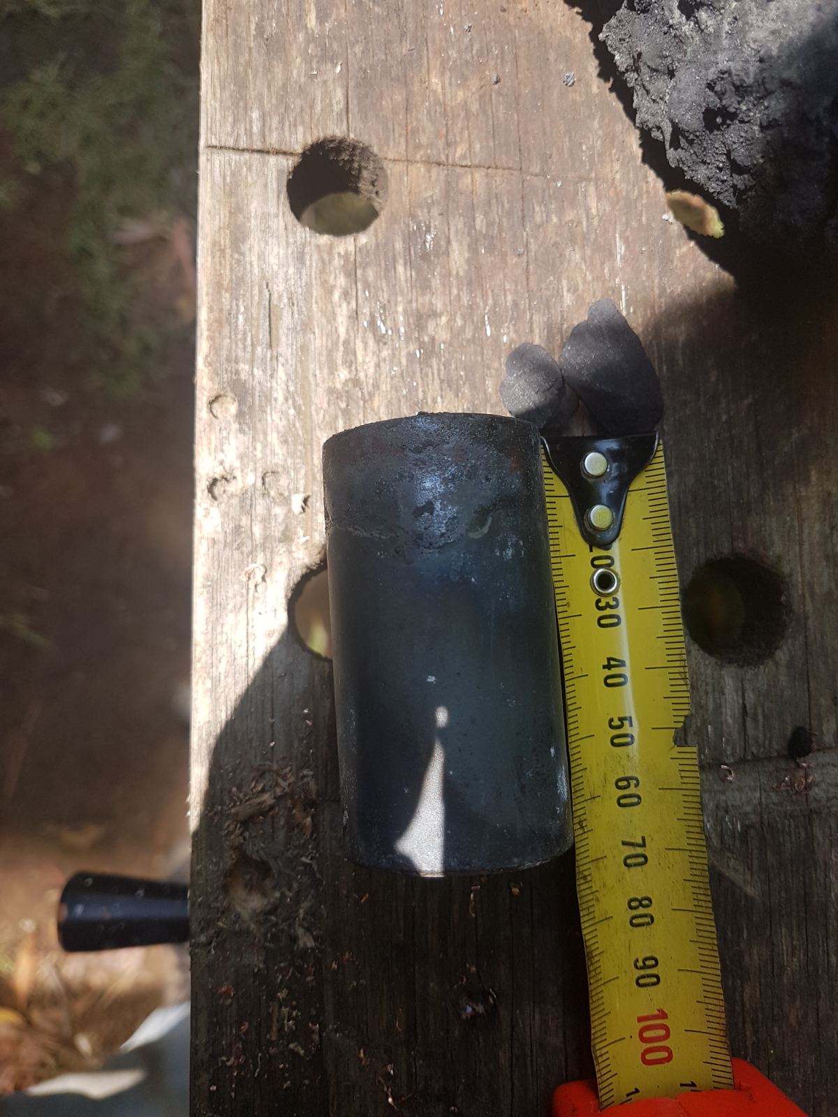

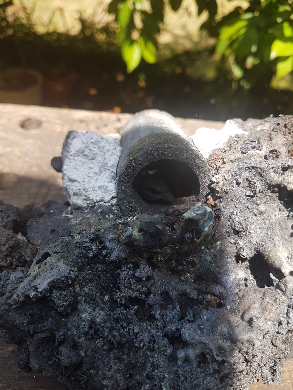

Dave, thanks again for sharing your photos. We really do have some good usage hours between the two of us with these nozzles…I am so pleased with them.
They survive even with extended use…it’s incredible. I think silicon carbide is now the gold standard, for me personally at least. I chipped my own out of the slag a few weeks ago and compared to a new, unused piece; aside from some superficial grime, the used is nearly indistinguishable from the new.
For anyone else interested, they still appear to be in stock and available from the original seller ($10-30 USD, very reasonably priced). I would expect threaded blast nozzles of the same material would be equally successful. Those could be especially useful for a downdraft.
