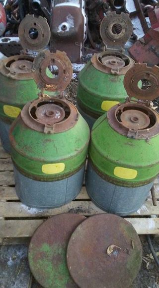

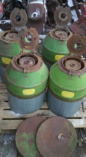

Ok Bill you got me. What are those things that look like gasifiers ready to go.
From a John Deere seeder
You can tell I’m not a farmer. Lol. I will start looking for them. The Columbia Basin or Central Washington State is pretty much farming. There should be some laying around in the farmers scrap pile somewhere.
Hi Allan , if you come across some steel pipe from maybe 6 up to 8 inch dia and and maybe 6 foot long that would make a great little gasifier once you weld a plate on the bottom and legs to keep it upright and then a flange on top so you can have a sealed lid for filling and removing the gas , i have a 8 inch tube that stands about 5 foot on legs and will run a small 3 kw generator for about 1 and a half hours before it gets low on fuel and too hot , but then only takes less than 2 mins to refill and pull fresh gas through .

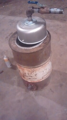

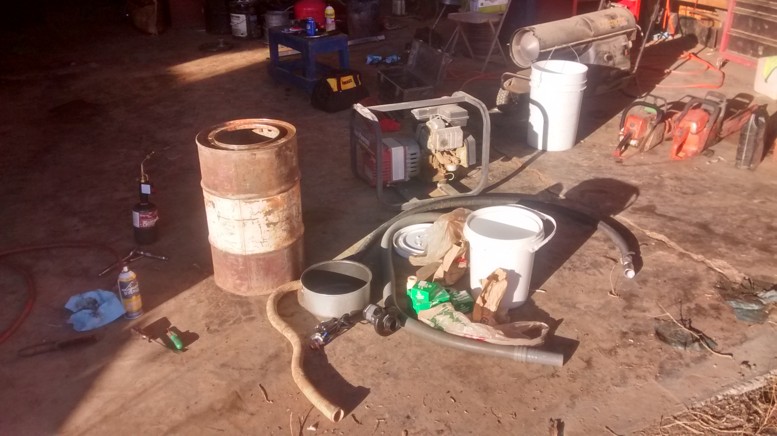

Well today was round 2 and I think I’m pretty near to having something that works.
I tried to fire it off this afternoon with the little charcoal I had made that I had left from the unit I’d made before and it just didn’t have enough in it to do very much producing.

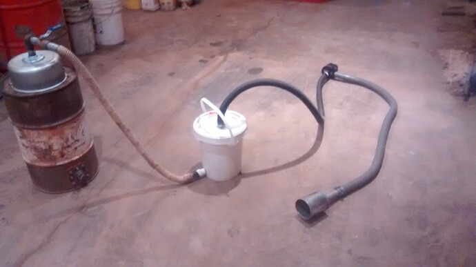

I had bought a couple bags of Cowboy Brand hardwood lump charcoal and took them up to the shop to see what I could do. I set everything up just outside of the shop door to stay out of the wind then filled the tank up about halfway and lit the thing. It kicked right off, so I turned the blower down to the low setting. (just under 6 volts) I don’t know if it was the store bought charcoal, that I only filled the tank part way or turning the fan down after getting it started, but it started shooting out the inlet at the bottom of the gasifier like a friggin’ fireworks show. I turned off the blower and then the ball valve and screwed in the plug for the inlet a few threads and got busy stamping out the hot embers that it had shot out.
Believe this for darned sure…I’ll wait for a day without any wind so I can get out in the middle of the driveway to do this next time. LOL

1: Always fill to the top
2: the system between the nozzle inlet and the vacuum blower must be airtight 100%, otherwise you’l have some fire work.
3: The charcoal is the most important part, make sure that the lumps are anything between 1/8" and 3/4" with an even spread as much as possible.
Special in the beginning, adapting to the habbit for using the best fuel possible ought to be trained…

Putting everything away tonight I did notice a tare in the hose going from the outlet to the filter bucket, so either that was part of the problem or I’d done it while trying to shut the thing down.

If you are getting a blow back out of your nozzle while the fan is running it is normaly a sign that you are not pulling hard enough or there is a blockage not allowing enough suction through the charcoal , i always get some small amount of blow back or flame coming out if disconnect the fan when connecting to the engine .
