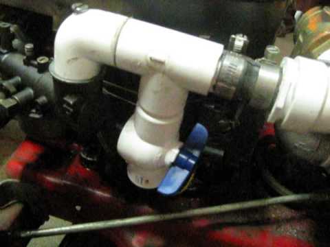

Thank you Gary for sharing your Simple-Fire design. It is simple for sure and works = first shot in the box. My lawn tractor started today after only three engine revolutions and only 2 minutes after light up.
Next week I will take it outside and do a walk around video including a light up.
Are you going to put it on a trailer an tow it behind the Tracker to Argos?
I got too much stuff to take this year so I think I will end up with a big trailer behind my truck for everything.
That looks great Don, sounds good too.
Sounds good. How about a little longer video with more detail of what/how you did it. TomC
that looks really good Don. I have a lawn tractor that needs to be gasified. …
