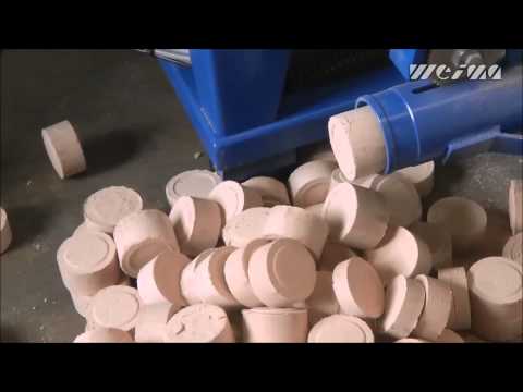

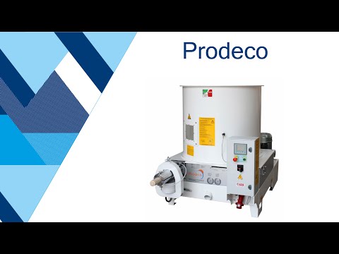

If you want to press it in a three inch pipe, keep it that way. It will never ever go through a two inch. The pressing pipe is split in two. There is a clamping cylinder on it that holds the briquettes. Around 100 bar it releases and if I look at Daves pictures, those maybe a little more. How you fill the chamber is with another cylinder. The Germans do that besides the silo, the Italiens under. Guess wich one is better for maintanance. The germans need an auger for feeding the filling cilinder. The Italiens not and therefor a little cheaper.
Comafer is ok. Stay away from the other one.
I don’t understand Joep. How would you build pressure to bind the raw material if you didn’t extrude it through a smaller opening. I see the advantage of filling the extrusion chamber from another pipe welded perpendicular with some sort of hopper on it. Perhaps with an auger to feed it down. I’m not envisioning this being used on a production basis.

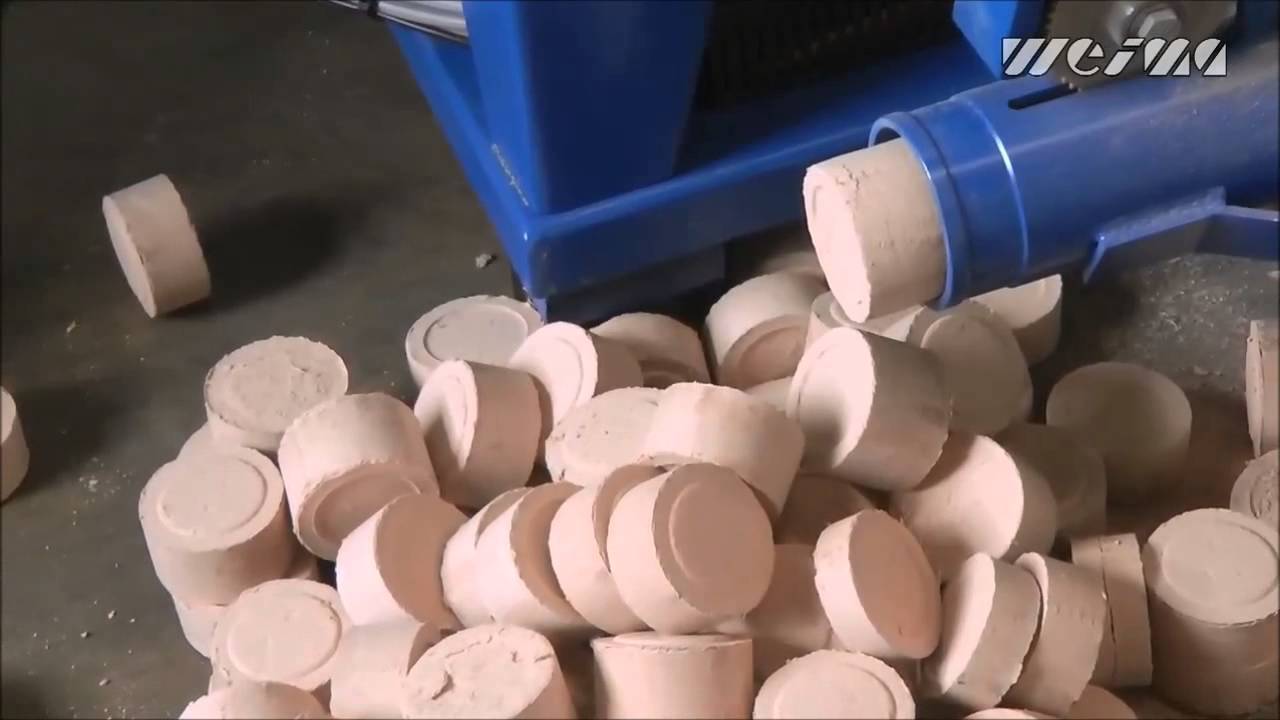

Take a look around.

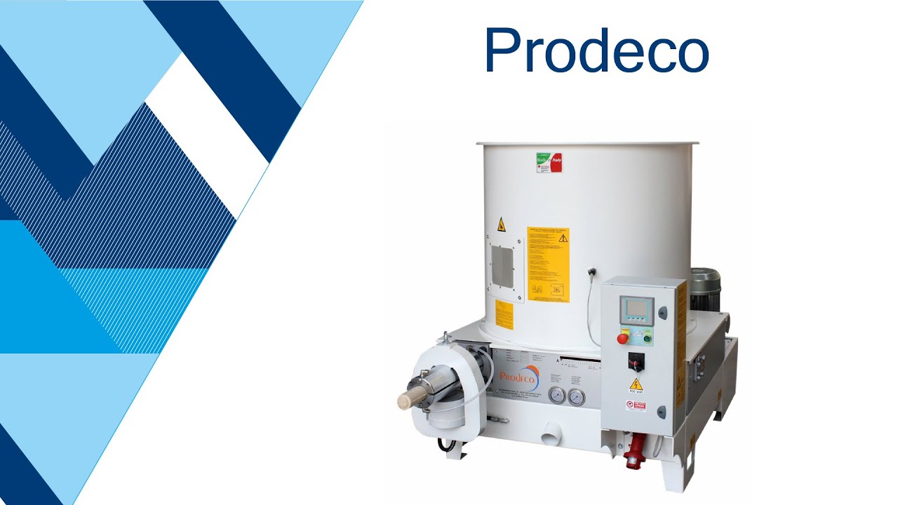

Or this one

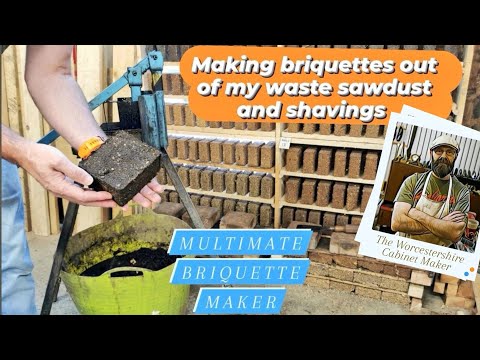

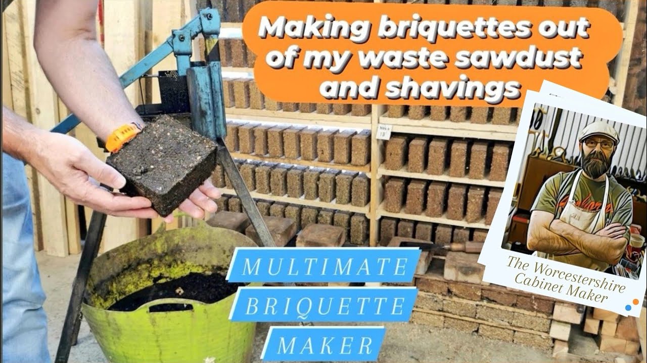

And here you can see clearly what I mean.
The extruding tube is tapered, one reason why it’s split like that is so one end can be tighter.
Hi Cody, not actual tapered, the upper and lower part are functioning as a clamp to hold the last briquettes. They form a wall for the upcoming briquett to press agains and once the desired pressure is aquired, then the hydraulik piston releases the clamp to make the briquett slide one step forward
Thanks Koen, you just won the TV :grinning:
You see the strenght of the briquette building when you start with an empty press.

Going from JoepK’s excellent put up video to others after a while it will occur to you, Why the extreme pressures needed? Some of these videos shows the Why in Drop-Testing. Why, drop-testing? To prove mechanized handling storability. Shipping durability. To prove mechanized feeding/use capability.
