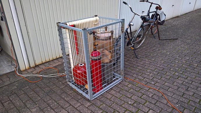

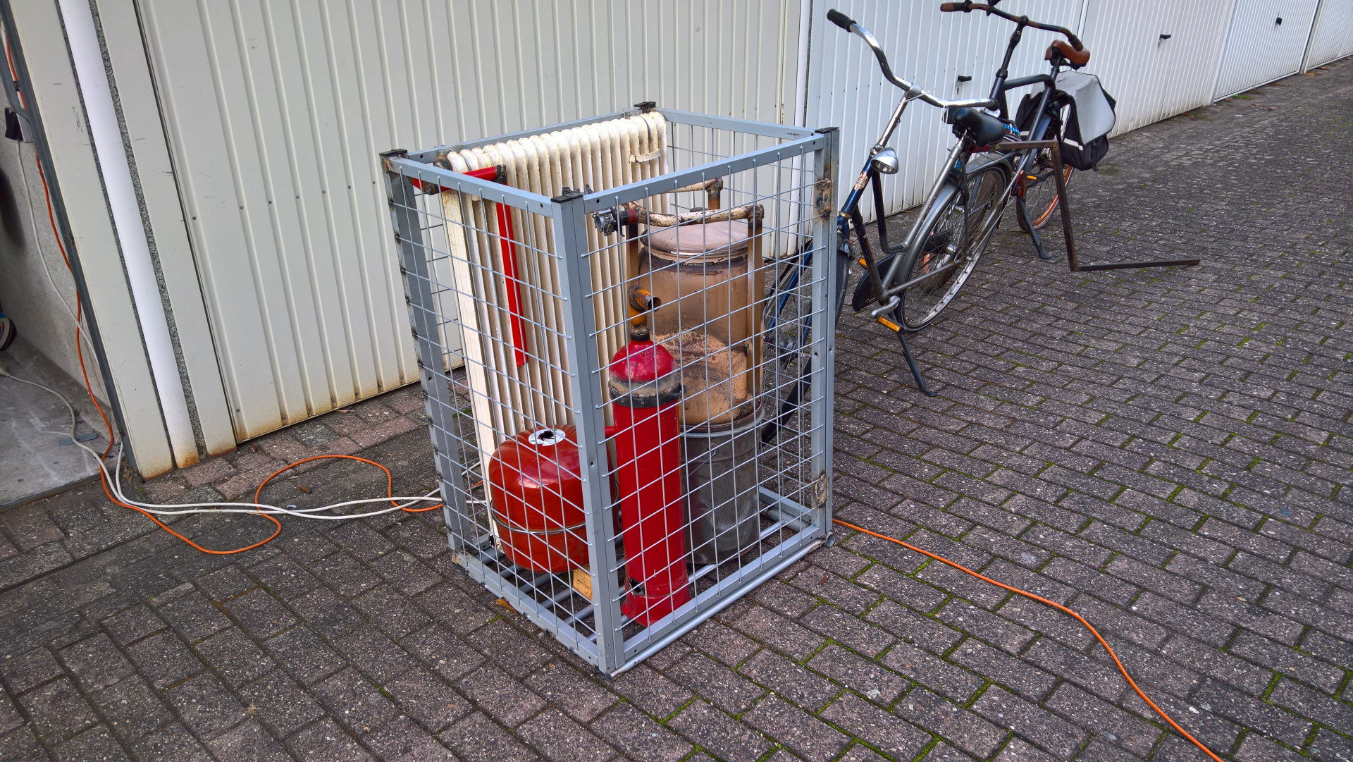

Sadly, I ran out of welding wire. And there is no store in my village, which sells 1 kg flux core welding wire. But yea, here is an update. I welded the cage together. The front side is a gate. I seem to be able to hang the radiator of the back of this cage. This does mean that the cage might get hot, because it has the hot gasses up there. But yea, this way, it’s much more managable/I can just unbolt it.

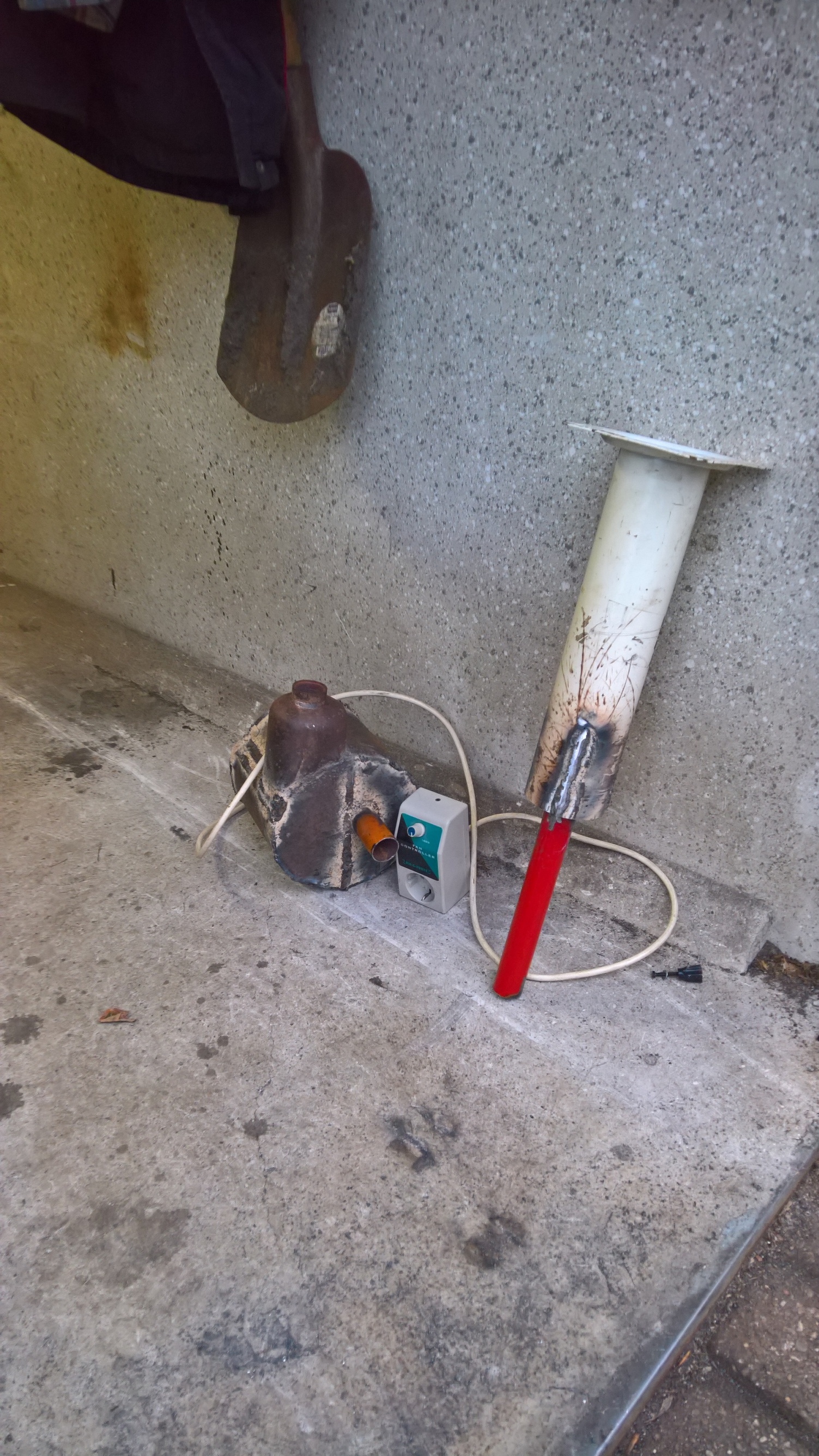

Tiny update on some parts I made, where you can actually see the progress.
Ventilator/blower/sucker, whatever you want to call it… It’s on the left. I took a (free) central heating unit chimney ventilator thingy, and made a box around it. Used 2 remains from 2 different fire eqtinguishers, small pipe and a piece of an oil barrel (sheet metal) to make this thing. I also got a “broken” fan controller. Person who gave it away said it was broken, because it made his blower make all kinds of noises when not @ full speed. It’s most likely an engine issue, because it’s working just fine.
On the RIGHT you can see my burner unit. Intended for when I’m not running an engine, or during start-up of the gassifier. Made from 2 IKEA-style table/desk legs. Also added 3 strips of metal from an fire extinguisher, to attach it all. Kept the dekstop attachment plate on the white leg. I plan on putting bolts on there, so I’ve got a raised platform so I can for example put a cettle on it. (or a frying pan)
