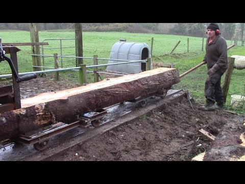

The first sawmill I run was somewhat homemade (not by me) and was all electric. The big bandsaw was stationary and the carriage that held the log was pulled back and forth with 2 separate electric motors and a cable. One motor for each direction. I never took any pictures of that sawmill and it was sold long ago. It’s replacement had a diesel engine and a seat with hydraulic controls so you rode along the log as it was cut.
Hi, Chris! What I know about sawmills is not much. I like this series by Tim of the Way Out West with Sandra and Tim YT channel. I will post the relevant videos here. If you have already watched these, maybe someone else will enjoy them.

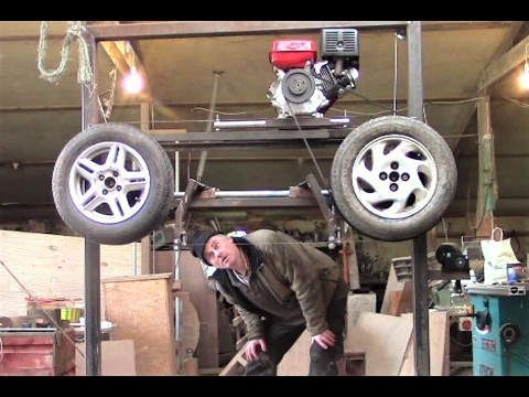

Hey All, sick in bed I found this one:
This was his episode #1. In his read-more he explained why with both a D.I.Y. made chainsaw mill and a band mill he is now making up a swing-blade system mill.
He is now up to 8 info videos on his building up.Find these on his YouTube channel.
