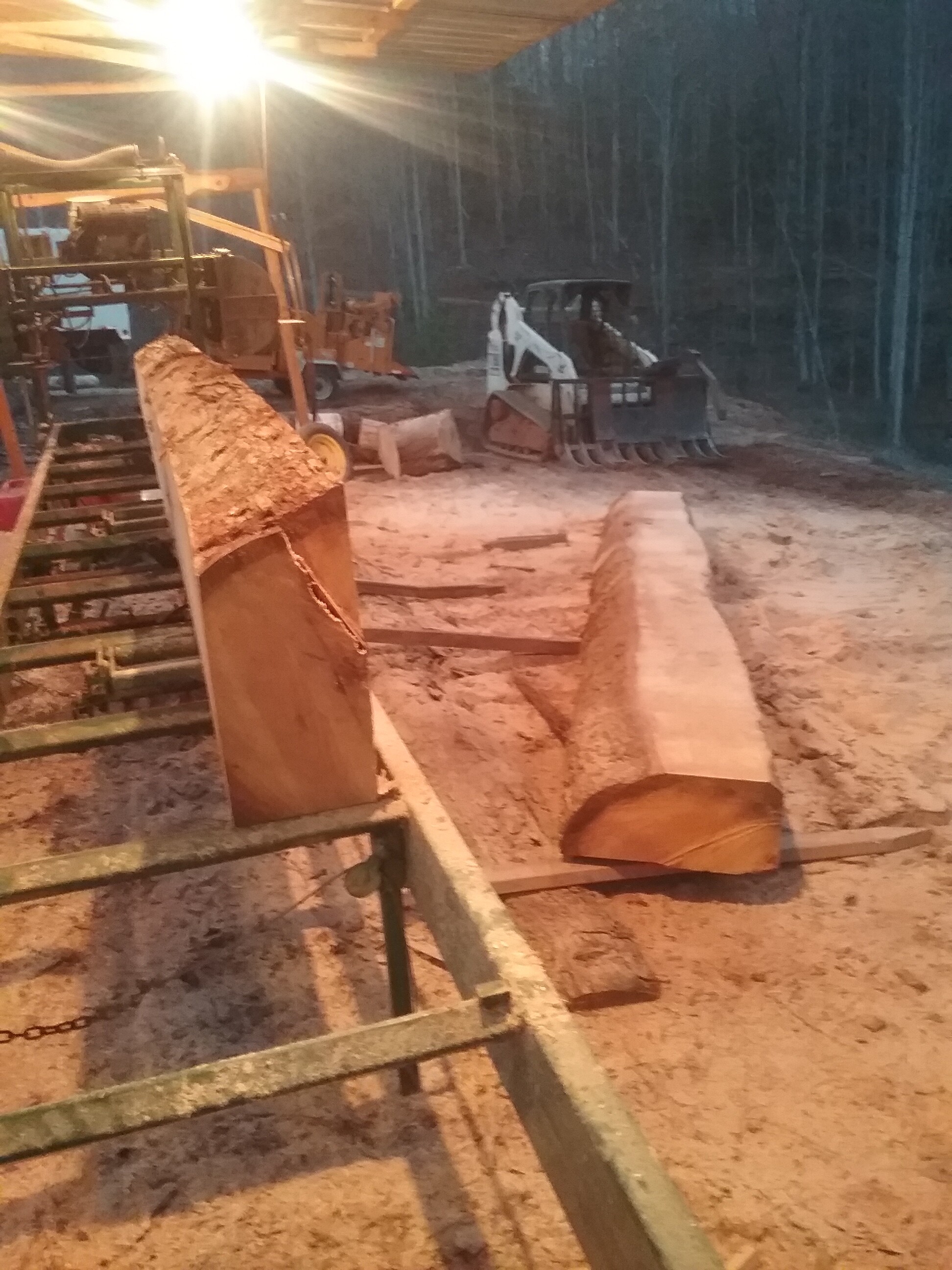

A few pictures of what i have been doing recently.

A few more pictures that i took today. I have a lot of work head of me. I pretty much spend any time im not at work milling lumber so im getting there.

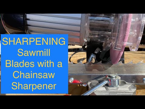

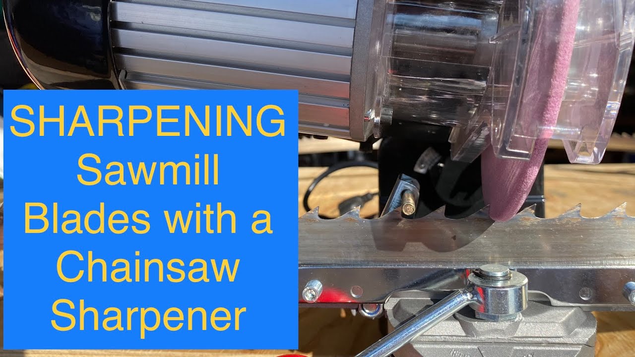

It is the bending of the teeth Jan. Allows the kerf to be wide enough to drag out the saw dust. I have a old Woodmizer tooth setter for band saw blades but I bought a bunch of blades at one time and don’t cut enough to have ever sharpened my old blades or set them. Craftier guys than me have set them by eye with a small hammer. I think maybe I’ve seen Wayne do that in a video. Anyway beyond my pay scale.
A video about sharpening and setting a blade with the setting part at the very end.

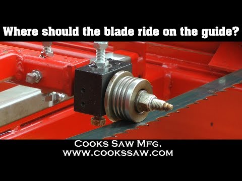

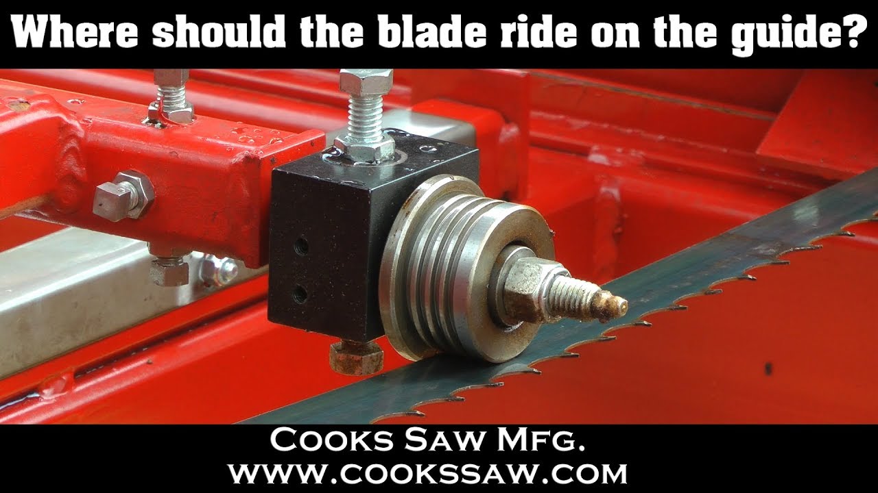

Can any of you show in close-up how you have done the blade control on your bandsaw, ball bearings, etc.
Do you have the saw band to lie against the rear bearing as support, or do you tighten the band so tightly that the band never goes against the bearing?
With regular bandsaws the bearing behind the blade is supposed to be just behind the blade and not spin when unloaded. When loaded/sawing it supports the back of the blade and spins. In my little world bubble it should be the same but I don’t have a bandsaw mill ( as you know, I have the same one you had before you rebuilt it as a bandsaw)
I do have problems with striped wood sometimes, and think it has to do with the saw blade catching on the rear ball bearing,
I have asked and read that the band should not catch on the rear bearing when I run the saw, but I don’t know. Should I tighten the band so much that it stays in place without touching the back layer, it will be a lot.
There are pictures at post 25 of my homemade blade guides. Unless the blade is in the log the back roller is not engaged. Woodmizer and many other manufacturers of good mills use different, simpler guides that could be made from auto engine belt tensioners. That’s probably what I would do if I built another mill.
