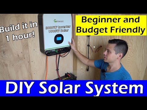

Hi All,
Just so you-all do not think I am a lead acid dinosaurs stuck back in the 20th Century here is that Will Prowse fellows’ recommendation for the simplest bare-bones all-in-one PV solar system:
I am viewing his and other for recommend hardware’s.
Seems to be good recommendations for fellows starting with nothing. He says ~$2,800 USD for a 600 watt system as of a year ago. $1,500 USD being the 10-20 year battery.
And still . . . I’d say with make-do beginning foe a few years with Max $500. USD worth of new lead acids. Break down that $2,800 to $1,800.

Hey Steve. In your situation your big cost will be a charge controller. Stay away from any kit that is using 12 volt panels and a cheap pwm controller as in your cloudy clime they will lead to disappointment. Anything 200 watts and over it’s cheaper to buy the higher voltage panels for low costs per watt and spend a little more on the controller. Often time you find 10 year old 250 watt panels even cheaper. The epever is an ok basic model controller I’m liking the victrons these days for smaller ones: built in programming via your phone. Those all in one units are hard to beat as the higher voltage makes everything a lot easier. I just sold one to a client recently and am looking forward to seeing it running. I’m thinking about an srna unit myself to replace my magnum Ms 4024. I sold off my last trace 2412 five years ago. Still a great unit though it’s battery charging algorithm did not do absorb charging well, fine for bulk still. The modified sine wave does play havoc with a lot of power tool chargers, some fridge electronics, washing machines and unknown other things.
