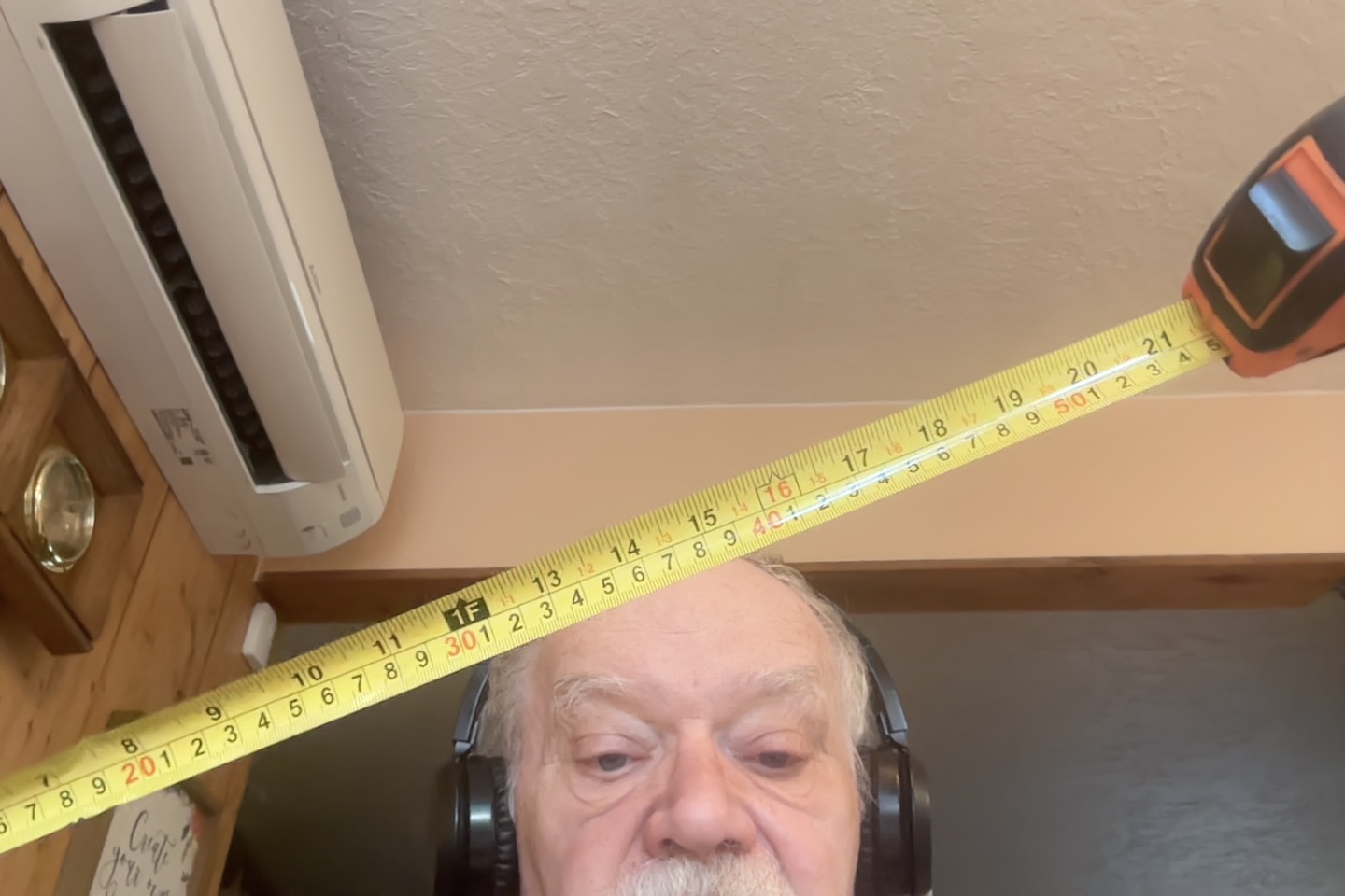

I have a rather silly question, but I’ve never worked with measurements in inches (except for plumbing), your dimensions refer to them.
Do the measurements in inches need to be precise? Is converting the measurement to centimeters sufficient, or is it better to buy a measuring tape that measures in inches?
Thanks in advance.
In practical woodgasifiction nothing is ever needed to be exactly precise.
Yes the easiest converter will be a dual scale measure. Then, round up and down from that.
Just minutes ago I had to look up convert 20 inches to the nearest CM. I used 50cm. (Could have used 51cm.) Good enough.
Us in the US have had to do this much with historic rest-of-the-world publications and current published SI specifications.
Thanks Steve,
I’ll buy the measuring equipment you showed me; it will be much simpler.
