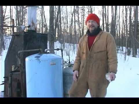

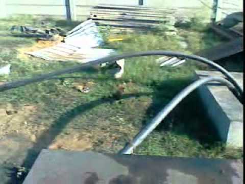

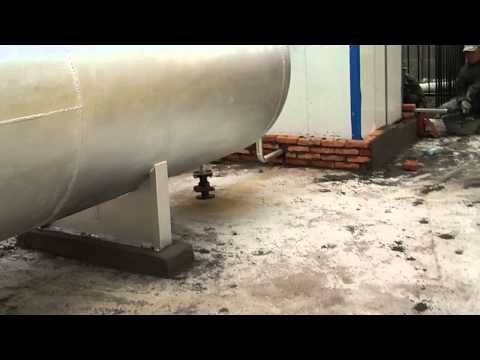

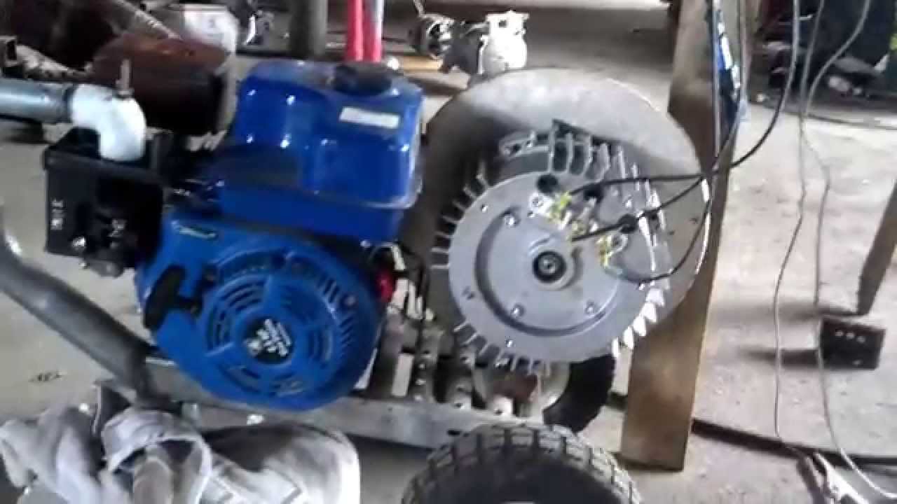

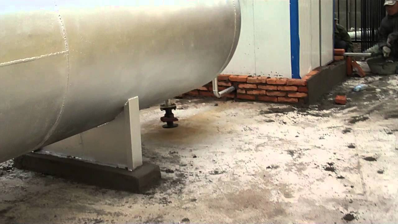

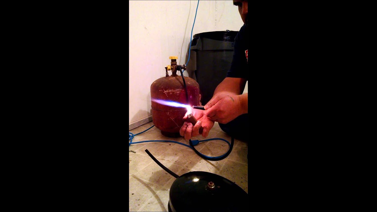

Hi people! Came back!, …my laptop lasted 4 days to update itself (very slow internet in this mountain). I found these videos in the net that may help. I had watched them some time ago while investigating woodgas. Hope they help to clarify. I have allredy bought compresor and found wood water tanks in skrap yards for my project. Enjoy
