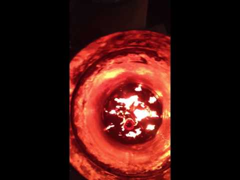

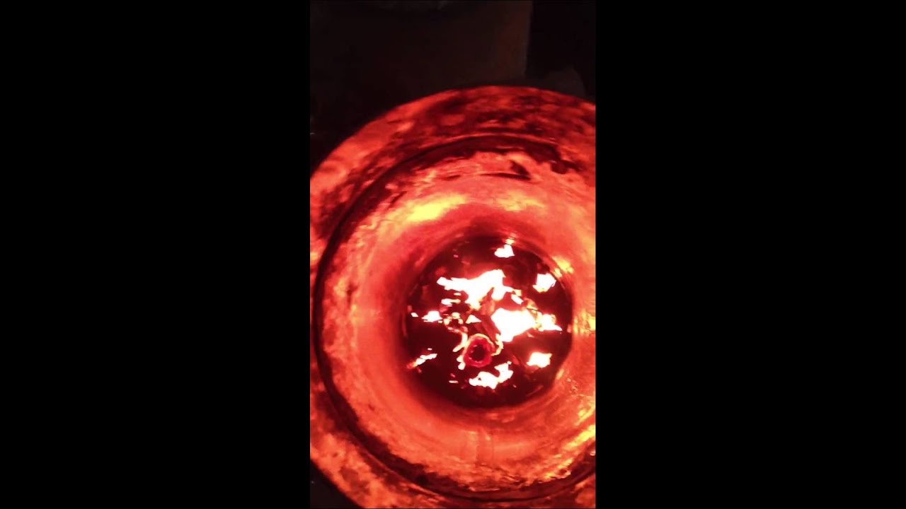

the normal startup everytime is done with charcoal to form a pretty hot bed for the flaming pyrolisis. You need the charcoal only for the first load or if you did a complete cleanout. In this Video you see a normal quick startup after a cleanout with fresh charcoal inside.
If this charcoal bed is not formed of charcoal completely glowing red and yellow, there will be tar like in every other system. The Tar cannot be cracked cause the temperature is to low.
Jonathan can you post some pictures or testrun videos of your DriZzleR? I think there will be some problems with your system.
A lot of people has build a DriZzleR with not problems and very good results. You will see them in our Blog http://www.thedrizzler.org

Therefor I made a demonstration video where it is clearly seen that non of this problems you mention are apearing in a well build Drizzler. Whatever systems you build you should never had called them “A DriZzleR”
For those who beleive only their own eyes, The video where I show; the DriZzleR flares very fast on woodchips, does not smoke, has no tar issues and can be safely come to an inmediate stop, can be found here
