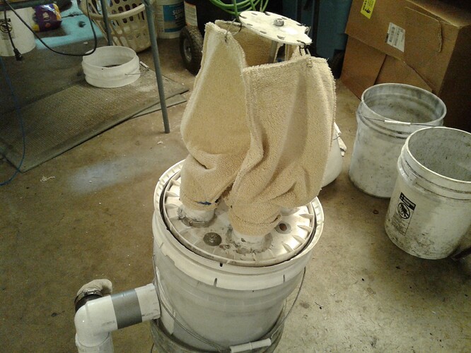

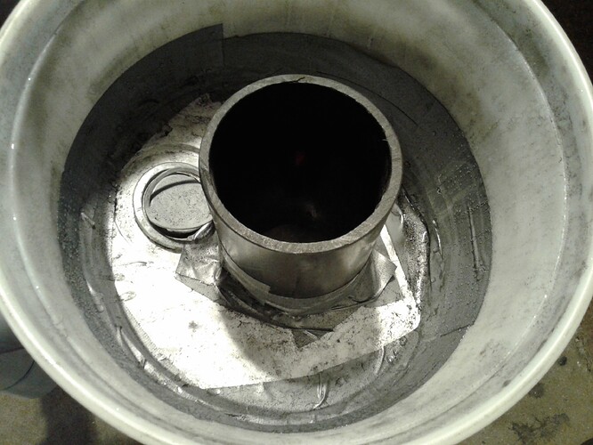

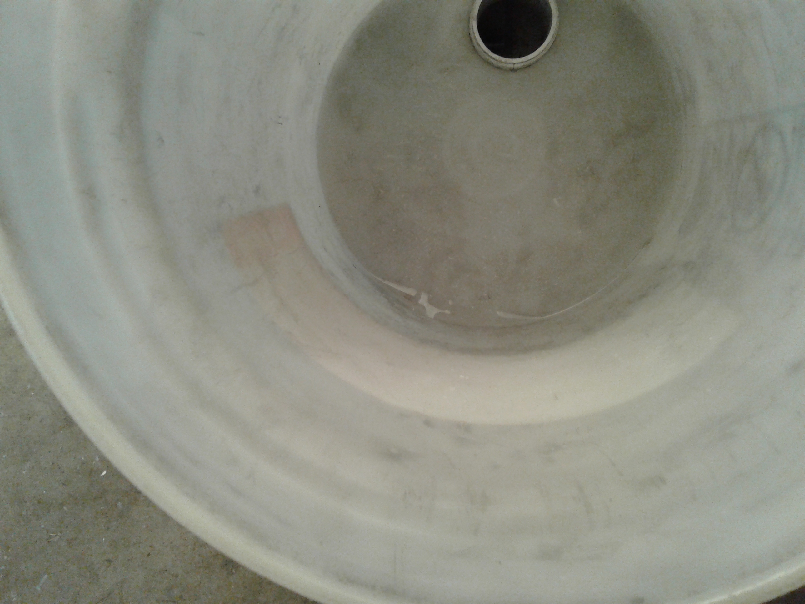

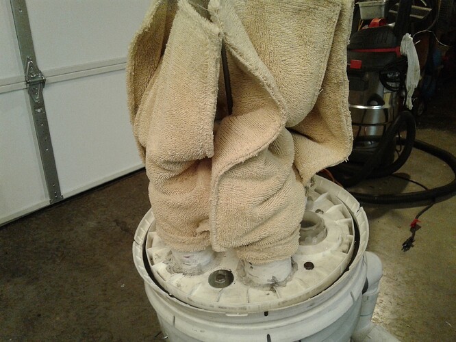

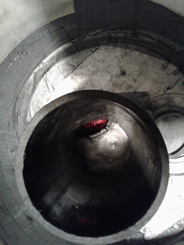

I notice some water dripping from the connection pipe to the suction/blower when removing it. So I pulled the filter off the gasifier and took into the warm garage to check things out in the filter buckets.
Water condensation in the upper bucket.
Filter bags are doing their job, fantastic. @KristijanL Thanks Kristijan for your idea.
Water and char dust is collecting in the upper part of the lower bucket.
Down in the lower part of the bucket even more water and char dust being collected.
Conclusion is no need to add any water at this time, there is a abundance of moisture in the gas flow.

Two things I would like to comment on the water in the filter:
1: If I remember it right, you said in the video that your charcoal is a bit wet. With the cross-draft design, it is possible that steam and pyrolysis gases from drying the char above the reaction zone bypass the reaction zone and go directly to the gas outlet. This is why you need good tar-free and dry charcoal.
Thus, if your char was a bit wet, it might be the wrong conclusion that all this water passed the reaction zone unchanged.
2: If a cloth filter becomes too wet, it tends to clog. Or the flow resistance increases much more than with a dry filter cake.
To avoid this, some old WW2 designs had a bypass of the cooler to keep the filter temp in the range of about 70° Celsius. This is high enough to avoid condensation in the case of relatively dry charcoal gas and low enough to avoid damage to the cotton filter fabric.

Just a note. Your truck was idleing on petrol when you run those tests right? Petrol exhaust contains lots of water vapor in contrary to chargas exhaust wich is only composed of CO2 and N2. Your gas composition will change once you run a engine on pure chargas and run its exhaust back. The water will be gone.
I am actualy at a point here on my Mercedes where l have less mousture l wuld want, using just EGR. Damp or slightly moist towel sacks do a much better job of collevting dust thain completely dry ones. I have seen wery light dust in my pipes after the filter. If l stay with useing EGR only, l will have to add a final oil filter or uses tighter fabric, l eaven thod of squirting a occasional squirt of water in the gas before the filter, to wet the sack.

And with the towel filter: So the point is to keep them damp but not too moist (like in your Chevy) to get the best results, right?

Good point on the exhaust from my truck running on petrol. The water was continue dripping from the truck tail pipe and it ended up in the pipe going to the gasifier. Some of the condensation could have been from moving the unit from warm garage to cold outside, but I think the wet exhaust is part of the condensation problem showing up in the filter container. At the end of the run the socks were very little dampened by moisture. I also member putting my hand on the filter container and it was warm durning the run.
