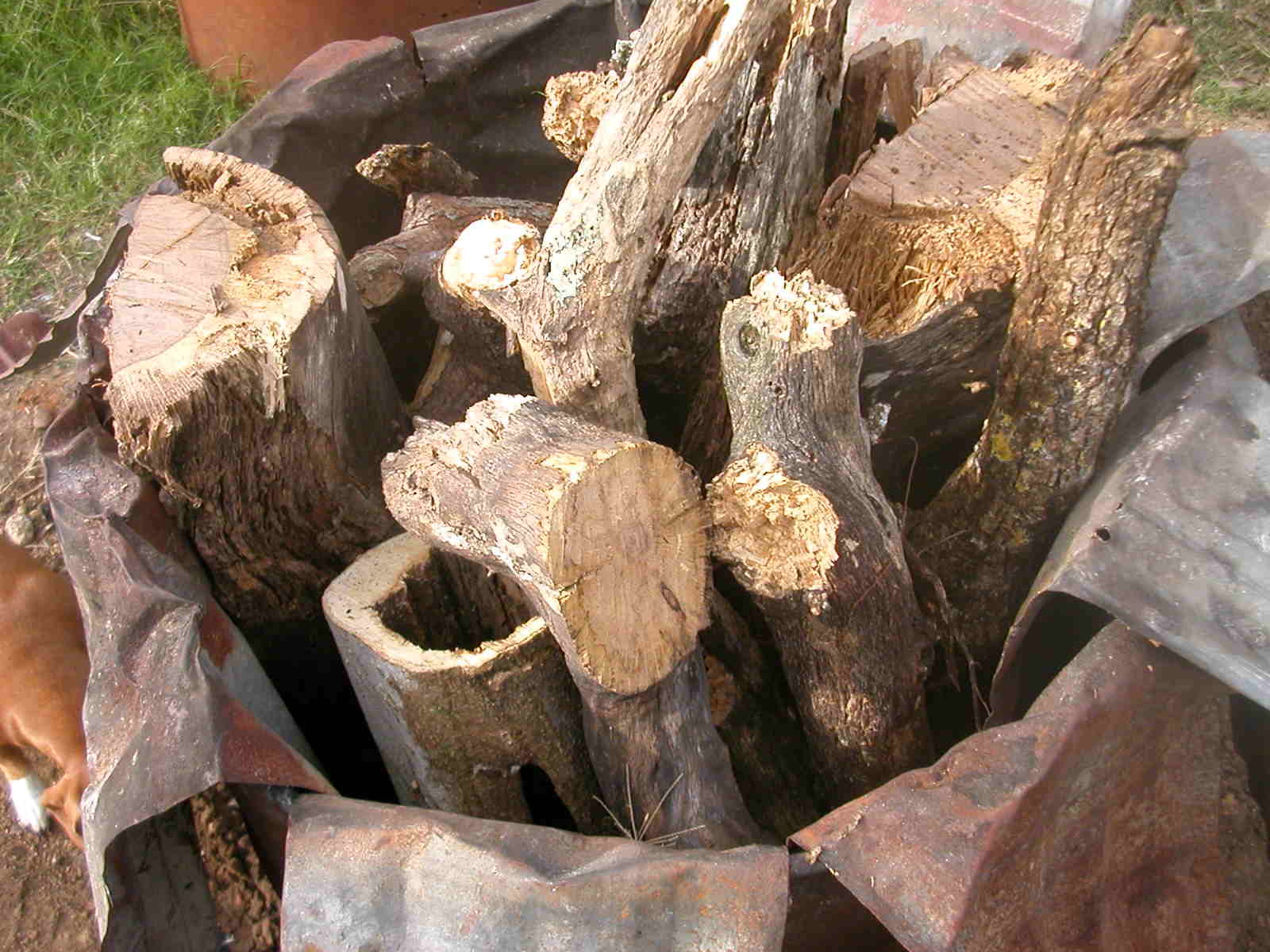

Loading the charcoal barrel with some junk wood that was removed from a fence line. I’ll fill all the nooks and crannies in the barrel with even more junk stuff, and toss in large amounts of branches, twigs, and even some wood chips as it gets going. The neighbor was all set to make a big bonfire and burn it to ash over several days. I managed to drag or haul it all over to my charcoal making area. (
It is the 278th time I have loaded a barrel for making black gold.)
Note: When I emptied this barrel, I got some larger brands that will fit in my wood stove. Or I can add them to the next barrel…
That barrel must be getting paper thin
It has earned a peaceful retirement!

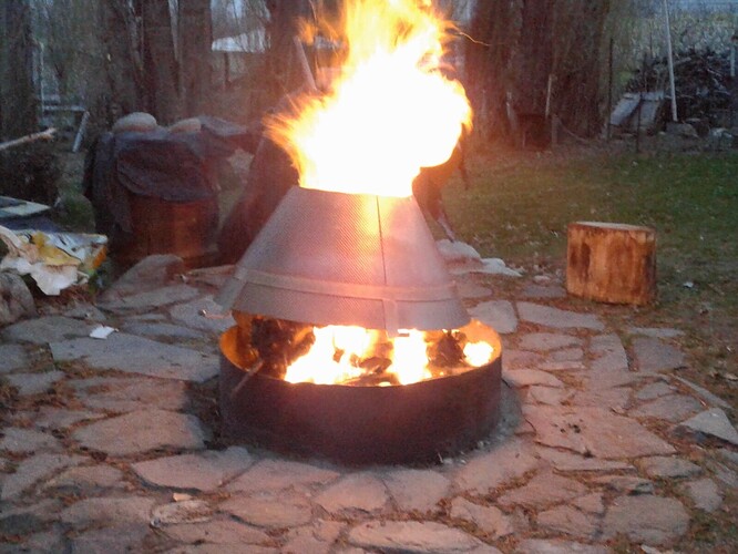

I have found that in my metal fire ring when the wood is not very dry I can make some good charcoal still. First I get a fire going hot, then I start stacking wood on top close together like a teepee or cone shape. I have a big stainless steel funnel that I turn up side down and place it on top of the wood. It has about a 12" diameter opening. Just keep putting wood into the opening and let it cook.
Transfer the charcoal to a air tight barrel or place in water. In the winter time it is always nice to feel the big roaring heat of a fire. Not so much in the summer time. I think I will go out and make some charcoal tonight with a smaller fire and enjoy it with my sweet Dana.

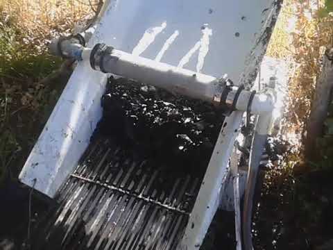

I am putting this video here because I have found a new way to handle my charcoal to get the ash out of It when I make down and dirty campfire ring charcoal.
