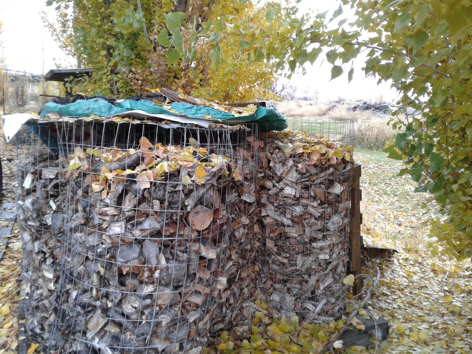

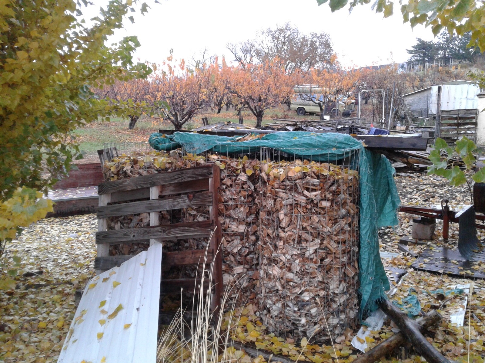

My wood had a mishap the othe day. We had some very hard rain lately and wind before that and more rain.
I wisha shoulda but didn’t check my wood chunked fence silos.
The wind blew my metal roofing and traps off exsposing my chunked up wood to all the rain we had. Now this wood was bone dry less than 10 moisture content in it. I was planning doing some chunking for my wood stove when I checked on it. It has been dry fore a few days now and partly sunny. Temps. in the 60°f colder at night like 40°f . My wood went from excellent good to bad, and the wood on top is ugly wet.
Got all the wood cover back up and everthing I was going to chunk up in the other pile looks okay for now but even the tarps on that pile was torn up from the high winds. DOW but wet?
it is probably mostly on the surface if it was dry already. It may not be as bad as you think. take a hatchet and see how far it penetrated.
Yes, the moisture content is okay in the middle of the pile but the edges are some what wet.
