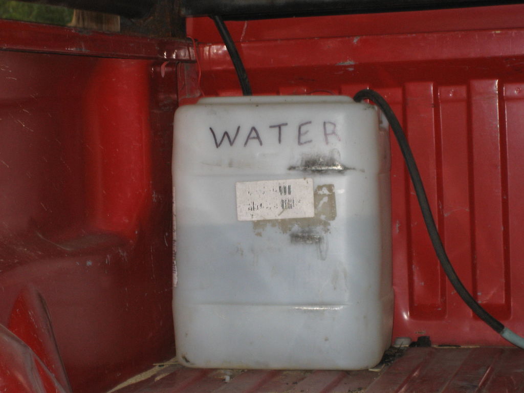

I kept a 5 gallon container of water in the truck bed with a car windshield washer pump to do the spraying when needed .

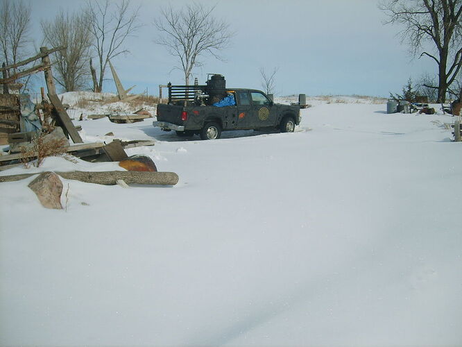

Koen, This brings to mind a post I made a few days (or weeks?) ago. I commented that since I installed a Wayne-inspired monorater on my truck (a year or so ago?) I rarely get more than a few drops of water anywhere but under the hopper, even in the winter. It’s winter here now… A foot of snow and single digits above zero…
This is the season when any spare water condenses easily.

John, I noticed how tall your hopper is off the truck bed. Just curious if the height is a problem for you at all?

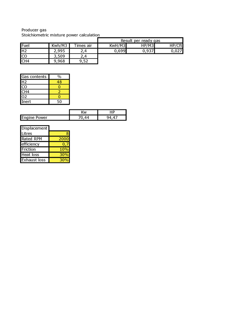

the boost of power we see happening in our “small” engines comes from the hydrogen bringing the ignition point back near the tdc , thus increasing the “applying power at the best timing” value…
i attached some calculations , simulations for the hp and only alter the gas contents , also a serie of three pics showing the HP values changes with intake efficiency..
first three pictures playing with intake efficiency ( nr. 7, 1 and 2)
Rest is playing with CH4, H2 and Co
