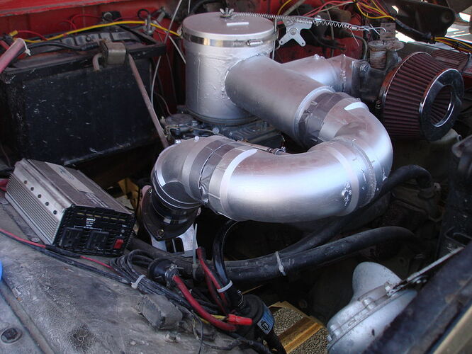

Hi Chris; is your setup a TBI or a carburettor on my old truck I just added an electric fuel pump and put a switch on the dash to turn off the gasoline and all the air for the woodgas came in through the throttle on the carb.
Hi Ron,
You have this high tech electric valve on the wood gas line next to your inverter on the right fender well. If I remember it correctly when I talked to you at Argos, that valve acts as a wood gas throttle? Air enters through the filter and mixes with the gas in the chamber above the carb. Does that mean that air and wood gas both go through carb already mixed? Or is it just air as you mentioned above?
Don M
Hi Don; the valve only shuts on or off the woodgas the air comes in the filter and Ts into the woodgas line, and mixes above the carb so I can use the regular gas petal to control the speed to control the air woodgas mix I have a cable hooked to a throttle body in front of the air filter this works well, not perfect though. Recently I took the cover off the carb and the gas jets were covered with soot after about 3000mi like Mr Wayne said. the back two barrels were almost buried with soot. I sprayed some winter windshield washer fluid into it while it was running and it cleaned up pretty good, I am goind to mount a windshield spray nozzle on top of the carb and give it a couple of shots after each run and see it I can keep it clean this way.
I think the way I have it set up is about as simple as you can get with a carb and it works ok.

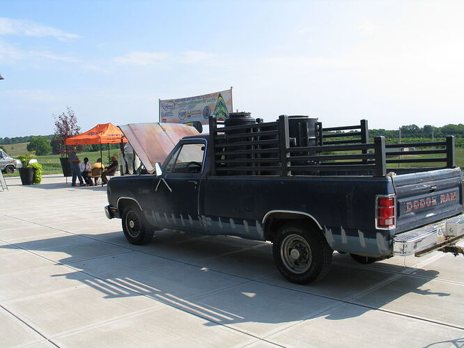

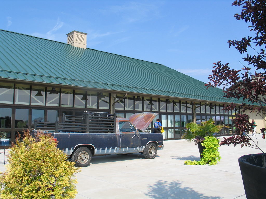

Photos from the event.
Chris,
Looks good. Glad your making the effort to spread the knowledge.
You should look around your area and see if any body shops want to sponsor your truck with a paint job. Or a graphics place could print a whole truck decal. It would be pretty cool to have slides printed right on the side of your truck.
Just an idea. Everything else looks good.
meschke
Hi Anthony,
Ha! Beauty is in the eye of the beholder my friend… but sure, it’s an ugly old truck, I just don’t want to throw much more money at it. Never meant to be a show truck. I’ve said from the beginning this one is just for learning. And I’ve learned a lot! As long as it’s mechanically sound and the gasifier works properly, I’ll save my pennies and convert another new truck.
