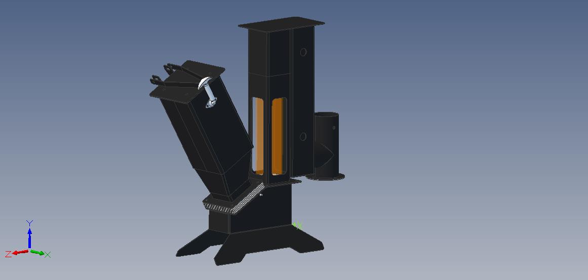

So here is the very first 2018 Utility with all updates. This has the revised hearth section with the air preheat chamber brought back and then a removable damper control for lighting.
Also a the new HD rocket stove, I over hauled last years version made it modular and added an air difuser and grate system that can be actuated.
I like your work man.
Im working on a CHP system my self and you have many great design ideas.

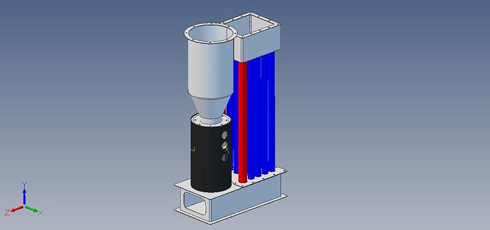

Life goes on, Im now starting work on continuing new development from earlier; this has evolved a bit after a lot of observation of the current stove.
I think ive figured out a way to build the stove so it is dual mode. This reactor will also be able to fill other products. The new development now will be to develop a pellet fuel gasifier that is the equivalent of the current chip machines. This way we can carry over a lot what is already developed, so we are only re inventing part of the wheel. :slight_smile:
So this first version will be in indoor unit and will work in two modes; a heating mode where we introduce air for combustion immediately at the grate. Then a Engine run mode where we cut this air supply off and save the gas for engine combustion. This will be a flare less unit and all other variants will also have this feature. Basically at first light up it will smoke just like you typical gasifier until the grate gases ignite and thats it. You wont see anything the smoke will be gone and you will know its ready. This indoor unit will only be the reactor portion and the gas cooler for heat exchange. There will then be an out door processing unit that the condensate will drain into and this will have an additional cooler and filtering for engine running. When in heat mode the gas will bypass most the filtering and a blower will be used to induce an artificial draft out top of this unit.
Cost and ease of manufacturing is also a big focus. this will be a very advanced unit but at the same time simpler and more cost effective to manufacture.

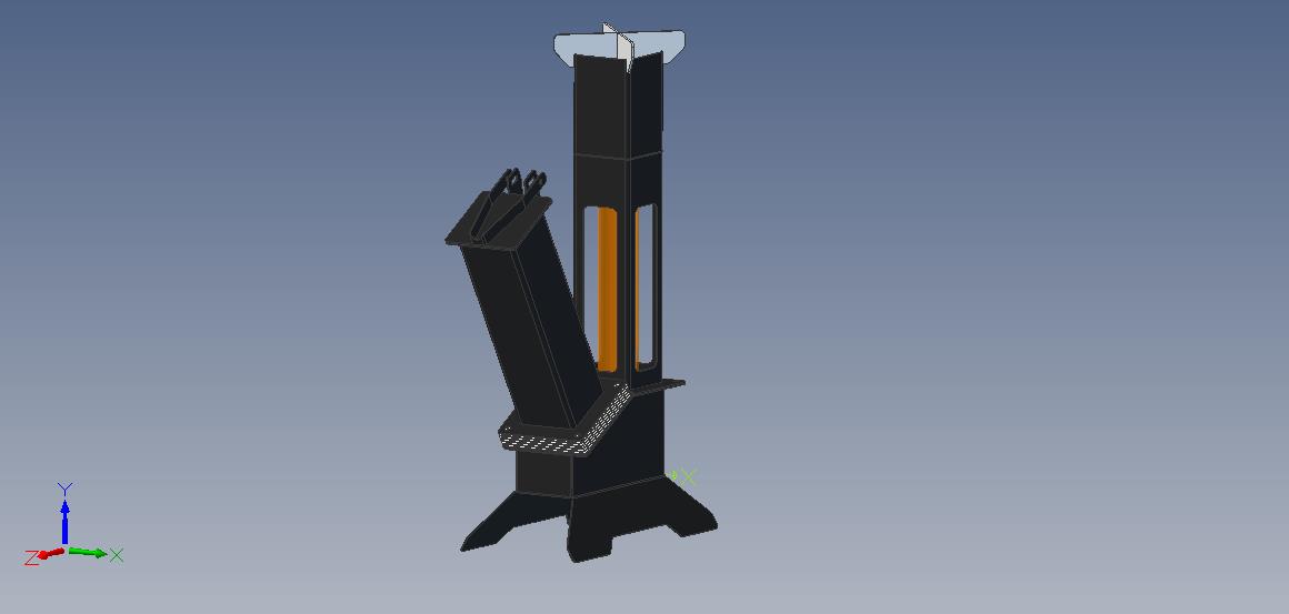

New rocket stove I am also working on, I have a guy that is going to aid in getting this in front of investors to enter into mass retail.

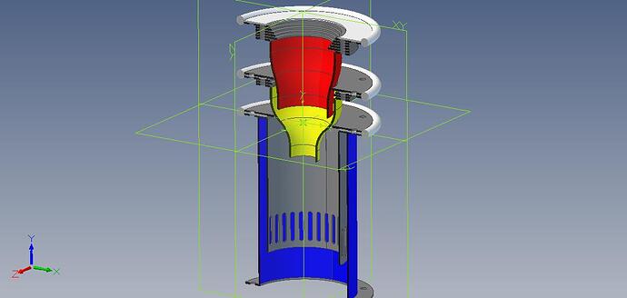

New Hearth / Combustion Chambers will be jet less. They will have a simpler air ring / air difuser set up. This will simplify manufacturing and save a lot of time and cost. It also opens up a lot of possibilities I can change architecture and tune with out need of completely remaking the hearth pieces. This is two Stage gasification process with optional third stage gas combustion. .

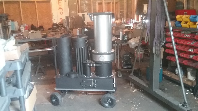

This is the guts this will have an outer enclosure much like the Evolution machines have to really polish it up.
Nice precision machines there matt, glad too here your still kicking, my brother got the flue and my acrost the street neyber got it and said it is the worst flue in many years too get.I got the energy crash but not the toltal imune systom crash, Glad too here you made it out of the main flue crash.

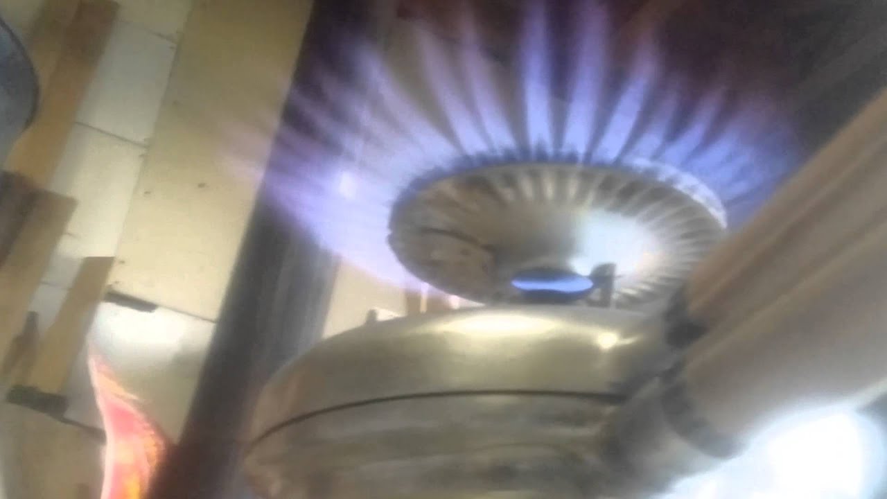

@don_mannes, I really would like to know how this was made. I think I could use something like this to finish the syrup.
I took a 30 lb propane cylinder and cut in a 1/2 inch nozzle pipe with a ceramic welding shield at the bottom. A 12 volt computer fan fitted in the end of a fiber coffee can provides the air thru the nozzle. I then cut the bottom off an old pressure cooker and used that as the sealed filler lid. I replaced the jiggiler weight at the top with a burner assembly from a gas water heater.
I used my fine 1/8th inch charcoal screenings for fuel.
NOTE:it looks hotter than it really is.
Bill , it looks like a simple fire charcoal gasifier with a computer blower fan forcing air in the nozzle and gas out the top lid hole into a gas defuser that comes off of a gas stove. Propane tank with part of a pressure cooker pot and lid. There might be some kind of filter material in the pressure cooker part that is removed when filling with charcoal. You can control the heat by the blower speed. I like it. Got to build one now for myself. One more project to make. You gota love it.
